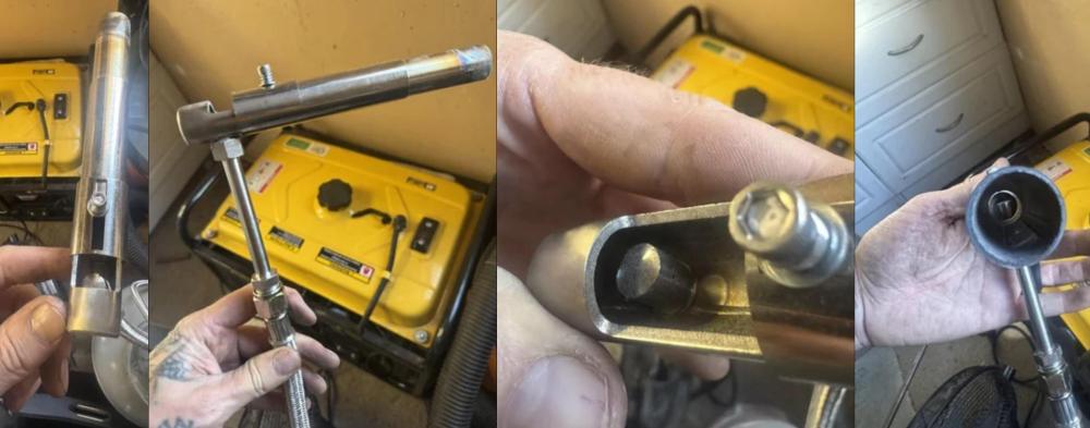

  2. If you're referring to the most recent image of the 3/8" Flare x 1/8" MIP, that is because I am still hoping for clarification on the quote I put in the last post from your reply a few messages back. If not and the elaborate mill setup is what you mean, T style tap wrenches have a hole at the top for a reason and they can be used in both Lathes and Mills with a tap guide. I searched a bit and found a video that shows the method I used. It works for sizable taps but if you go real small it loses SOME precision. https://www.youtube.com/watch?v=25MvOH4GdBI&t=130s At the end of the day a threaded hole is a threaded hole, if it's aligned with the burner tube for proper mixing then I don't think we need to tire ourselves out over which method for tapping to use/is best?
  3. That spring punch method is actually what my machinist friend told me to do and it got the threads perfectly straight first try. He wanted me to avoid doing power tapping without experience. It was the prior attempts by hand without moving the chuck that got me bad results, I should have worded that better in the earlier posts. The real problem was how cheap the 1/2" capacity wrench is and I'm already sourcing a vintage to replace it. I'm surprised they're allowed to sell them on amazon with how bad it ended up being, can't even properly hold the tap in the jaw. To recap a bit on the tapping, I misused the 1/8-27 pipe tap and went a bit too deep so the flare adapter doesn't fit in the tee quite right, I just need to tap a new tee and be careful not to go overboard with the depth since the 1/8-27 tapers. 1/4-28 worked great for the mig tip, tweco brand threads. Replace the elbow then connect propane hose directly to the elbow? I sent an image of the only fitting that makes sense from this quote.
  4. The thing attached to the top is a center punch that has a spring in it, uploaded another photo of that. I bring the table up until the tap wrench is tight and the spring is compressed keeping pressure on the wrench whilst letting me spin it by hand. It would work FAR better with a real "Tap Guide" since this one has a lot of slop and unnecessary length being a hand held center punch and all. I'll try using the weight of the spindle instead tomorrow it should work pretty good for the 1/8"-27 pipe tap. That piece of copper tubing you see is from a 1/4" Brass Female Flare Swivel. So what you're saying is I should get a 3/8" Flare (Hose connection) to 1/8" MPT which will be tapped to accept the mig tip making it the only brass fitting piece? I'm looking at the SKU F40-067 from supplyhouse. It's a lot of weight from the hose on the tee but I could weld supports to it, really no different than what I'm currently doing except it's a ton less parts. Thank you
