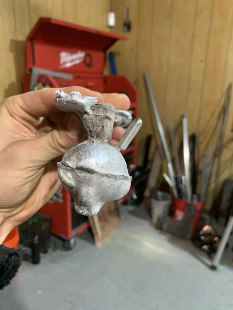

  3. Hey Guys! Sorry for it being so long, truly. I hope this finds you both well. Before I get started, Frosty- I ended up making my own flask with a mig welder, some 2 inch angle iron and two bolts on either side welded in place with nuts to keep things tight, my tolerances are alright but youll see i have a noticeable seam on my object, so ill end up making another. Id like to make a new one that allows for a top pour, dunno if thats the right term but I am currently pouring from the large open side, the side i pack the casting sand in. The past year has been what feels like a whirl wind. I have continued with the forge somewhat, been still diddling around with metal work. I can share anything youd like if you have questions about what i make or do. Been working over the past year as well, I build/ climb concert stages to pay what bills I have (still live w/ parents) And finally a couple months ago i blew up my right ankle, tendon and cartilage in a fall i took downhill longboarding down a mountain in TN. So the recovery has been a slow process up until now but today I just got to start "walking" again without crutches. So thats pretty sweet for me. Below are pics of my first cast. Again its an artifact from a Japanese comic i've read all of, its very, very good, its called Berserk by the late Kentaro Miura. Since my first cast I have made more egg lookin things, each one coming out with less work i have to put in to make it look good enough to give to someone. IMG_2011.HEICIMG_2006.HEICIMG_2007.HEICIMG_2008.HEICIMG_2009.HEICIMG_2010.HEICIMG_2022.HEICIMG_2017.HEICIMG_2018.HEICIMG_2019.HEICIMG_2020.HEIC IMG_2021.HEIC I also meant to add that the first pour was done using the one and done negative plaster cast. Another reason for such poor quality, i did plenty of grinding and tig welding up the low areas and then grinding back down to get the shape I wanted. Also did some detail work around the eyes and mouth with a Dremel and hand files.
  4. Greetings again everyone, or at least everyone that participated in this thread. Just would like to breathe one more breath of life in it and say that I just poured my first mold the other day and have spent the subsequent days polishing it up. It went pretty well, I had someone there with 911 on speed dial, wore pretty much all leather and did a lot of saying "well, we will see how this goes". The total time from start to finish was about two months, probably closer to two and a half, but you know, I wasn't really keeping track, maybe I should've been. My mold which was made of around 65-70% plaster of paris and the rest fine sand, held up well enough to not destroy the outcome of the pour, and now my next task is to see how much less work I can get away with after pouring my next. I am going to switch to greensand casting, though I am unsure about how I am going to make my own basic metal flask that uses a fine enough system to not cause any mold deviations when going to take my pattern out initially, as well as getting the cope and drag back together exactly where they were to start. Anyways, I really just wanted to say thank you guys for the help, wouldn't have been able to do it without you. Or maybe I would have and it would've taken me a year, so thanks for sparing my life. One last question, do any of you know of any graph or system that will tell me how smooth and polished I need my items face to be to allow for a cleaner cast with petrobonded sand and if different metals will pick up different details from the sand pattern negative? Id like to cast like 10 more of these things but want to obviously minimize clean up time. and if anyone is curious, I made an aluminum behelit from the manga Berserk by Kentaro Miura.
