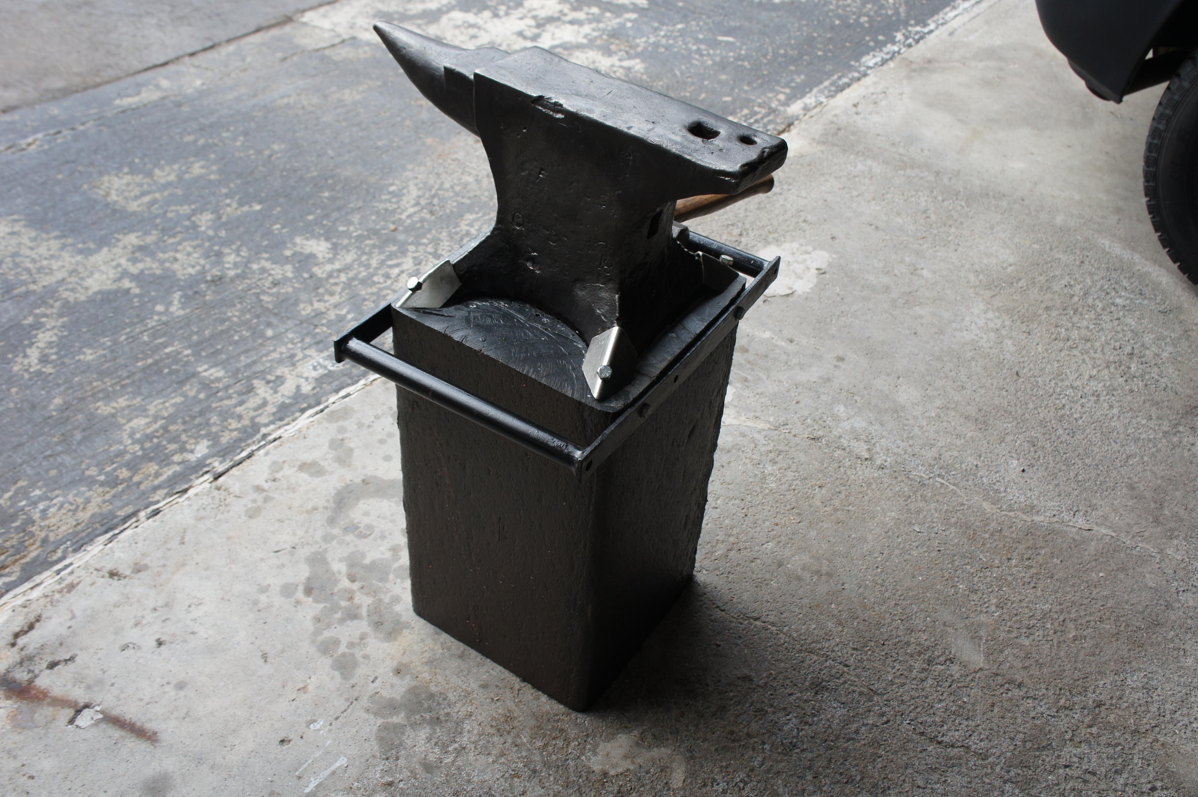

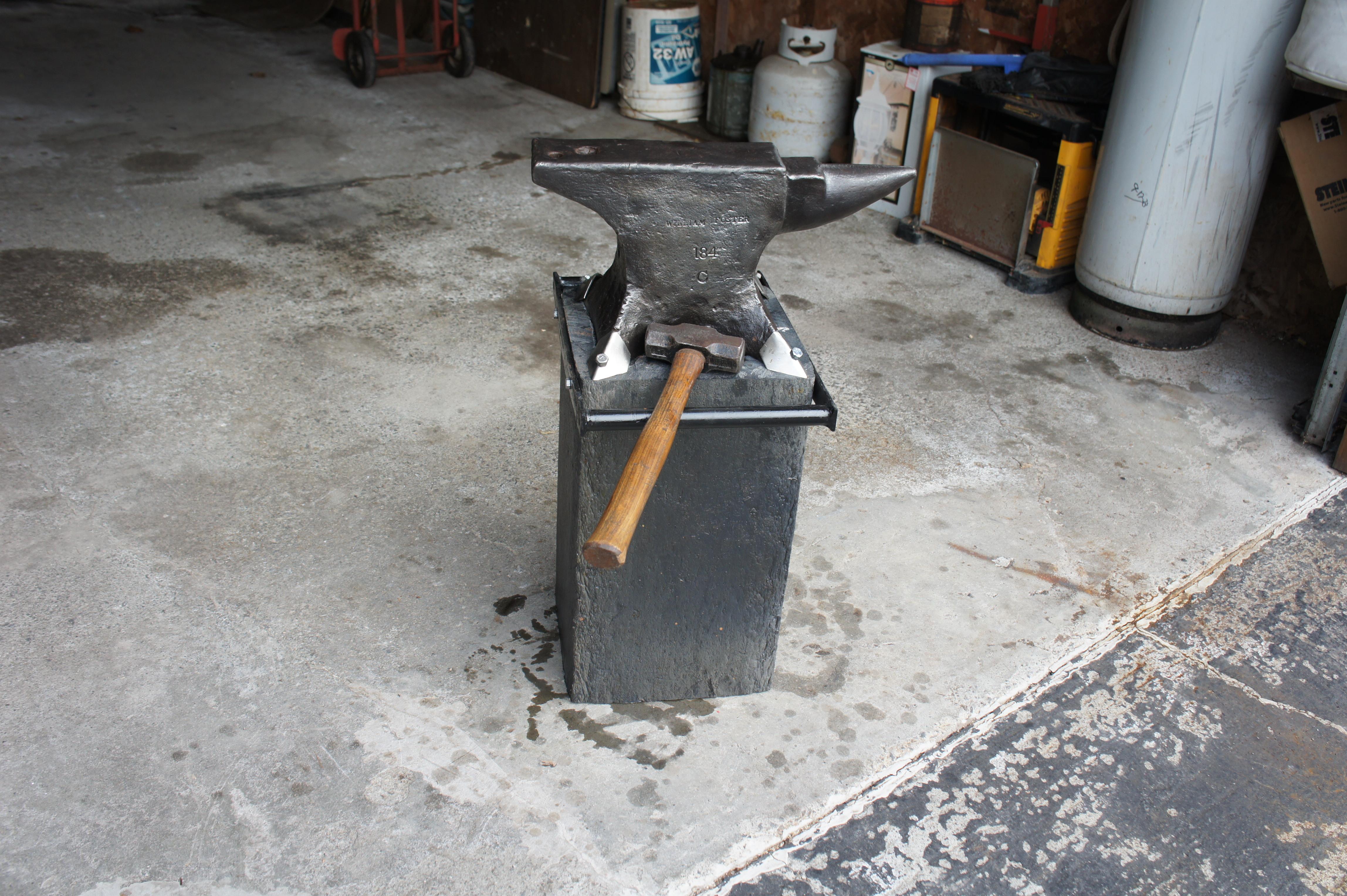

  1. ThankYou George.....for the odd-spells I use it should work fine. The HDPE for the base was part of a dock/ramp in a marina I worked on for the construction company I worked for. We mostly built bridges for the state and counties here in the Hudson Valley, NY. Some engineer had designed and used this material for the non-rot qualities, used all stainless hardware to fasten it. I had never seen this material either but it seems pretty industructable.

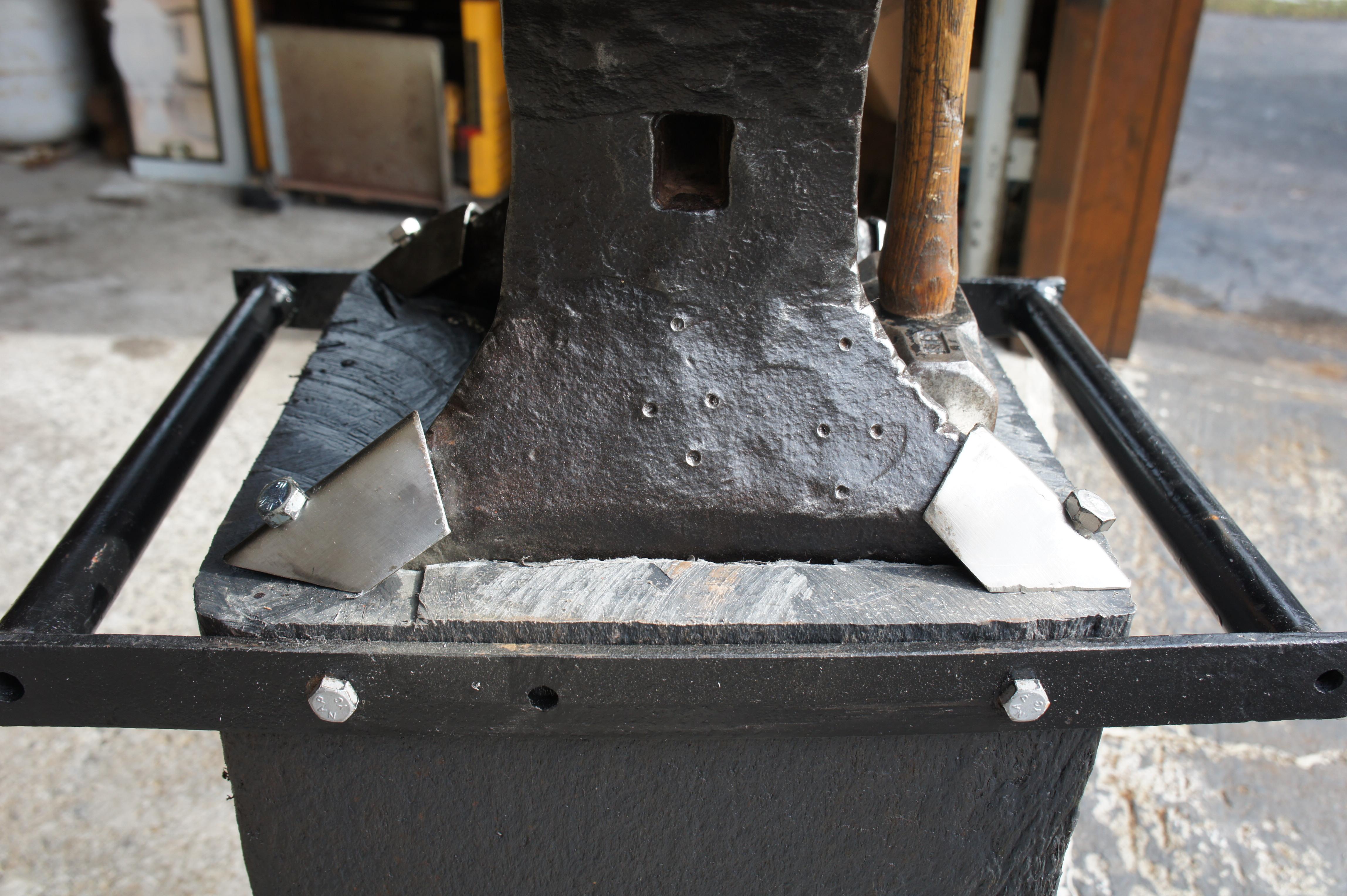

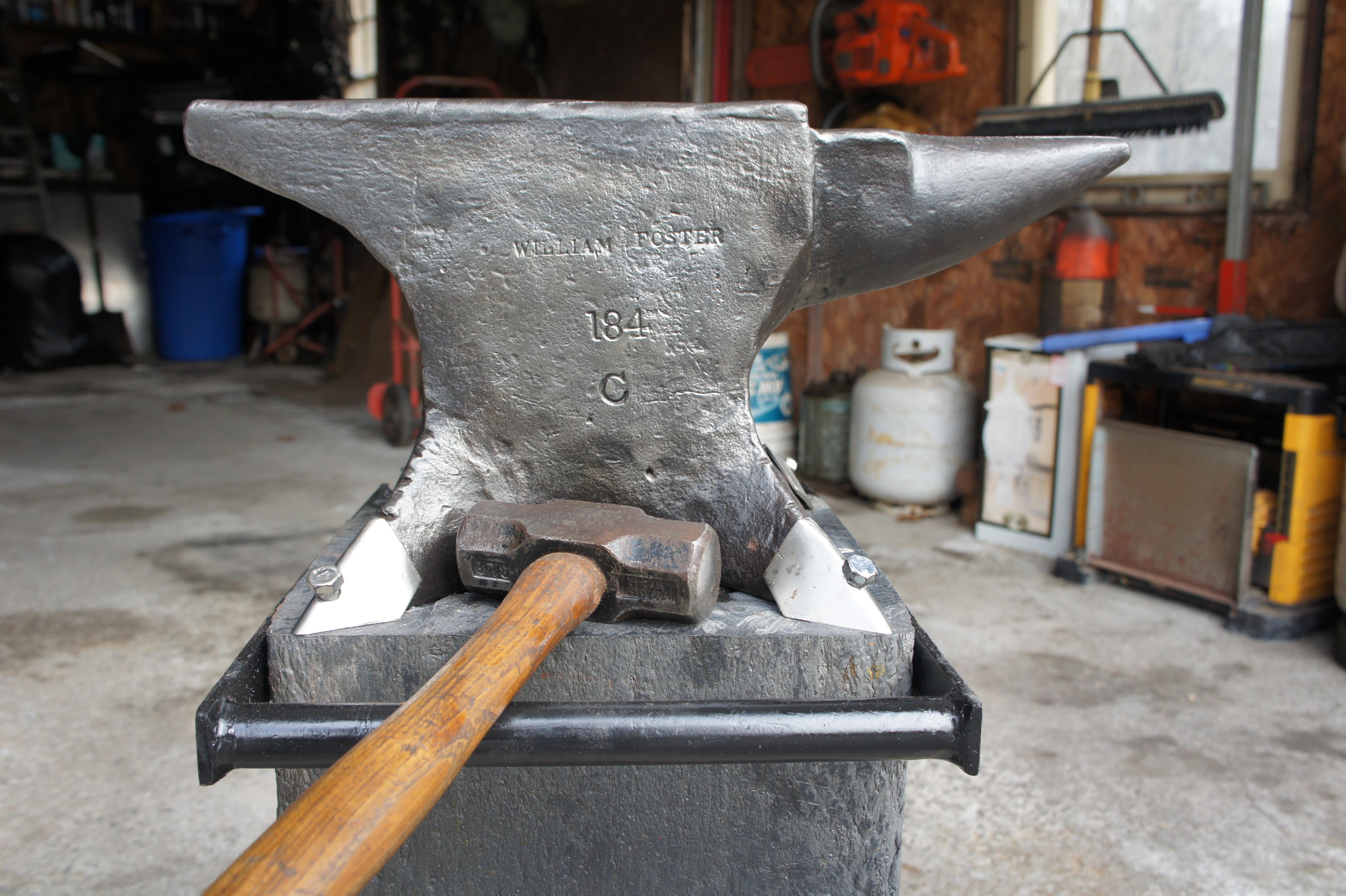

  2. Hello again....got my anvil cleaned up and mounted to the base today. Good & solid and the right height for me (abt. 31") Base is a piece of 12x12 HDPE (hi-density polyethylene) molded to look like a wood timber. Base weighs 96 lbs, anvil 102 lbs. 10 ga. stainless angle holds each leg. When they forged the anvil the 4 feet did not all set even on a level surface so had to route the base for a solid mount. Anvil cleaned up nice with wire cup and it has a bees-wax/mineral oil coating on it. Made a frame on top to assist in moving and hold hammer & tools. Noticed a strange set of punch marks on the base, two sets of 4 marks, anybody seen such marks before? Craig

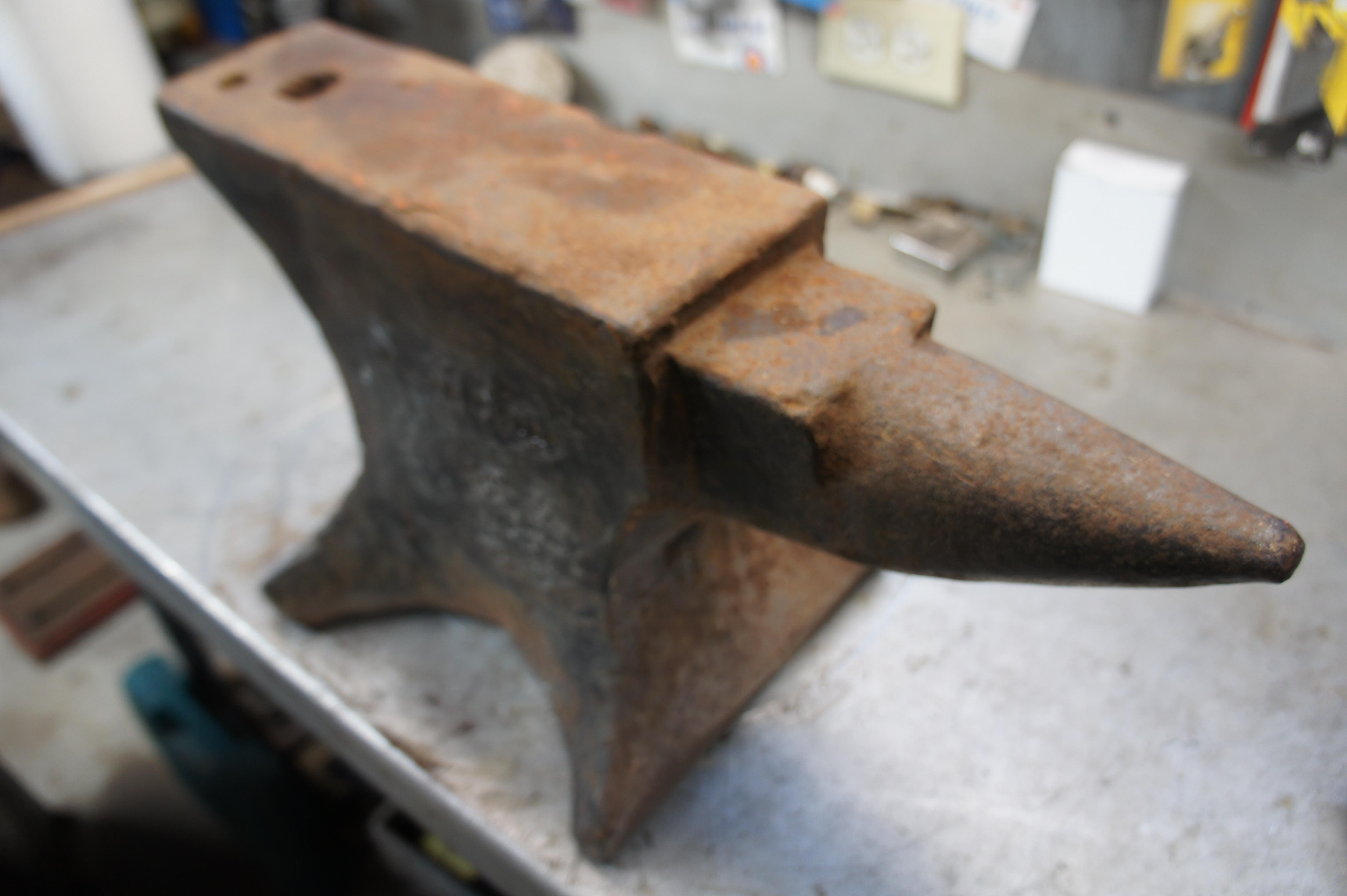

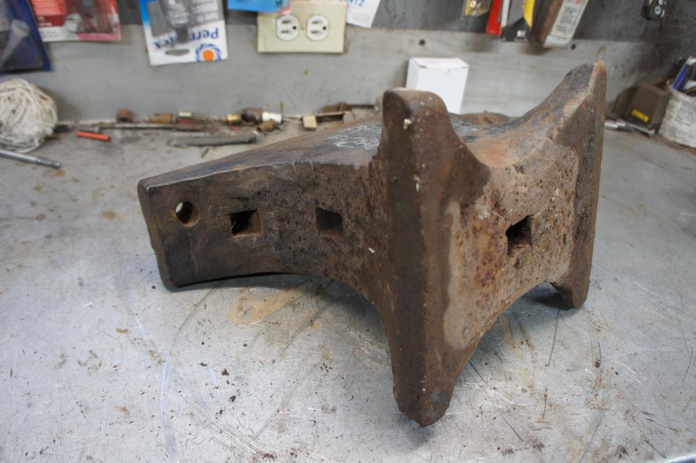

  5. Thankyou for the reply.....there is no welding, grinding or milling being done to my old anvil as it is in satisfactory condition for what I occasionaly use it. A few yrs ago I did a quick, light sandblast to clean it up and will now use the surface conditioning pads on it. After clean-up I will probably use a mixture of Bees-wax & mineral oil on it to keep the surface rust down, then mount to a solid base for an overall heigth of 30" or so. I am not a blacksmith per say but do much fabricating with welding, cutting etc. on machinery . Just want to make it decent to pass down to my son, I'm 73 so it won't belong before I do not need it! Thanks Again,,,Craig

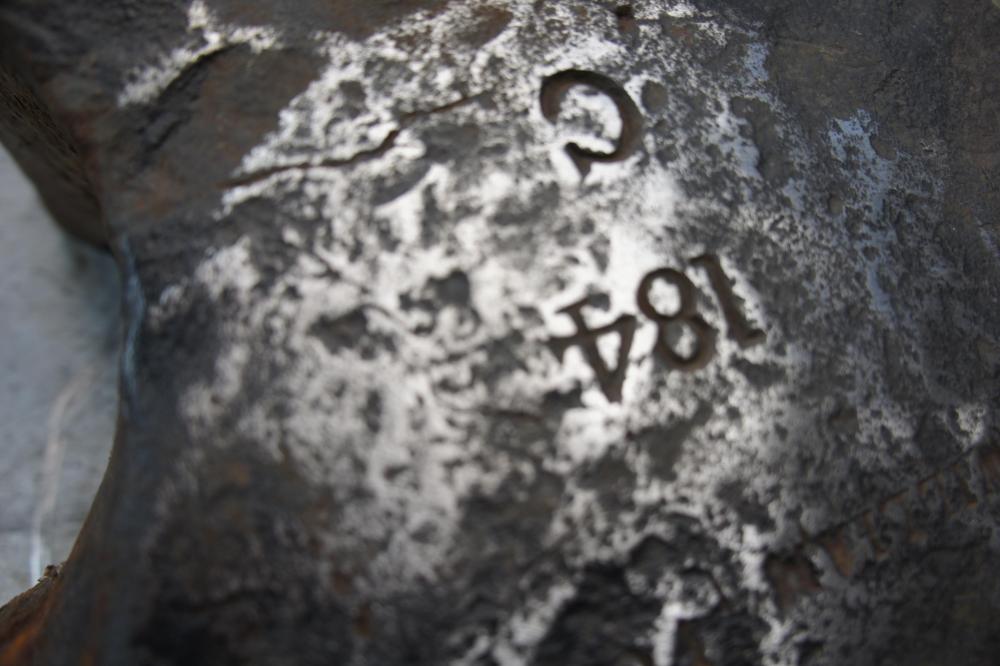

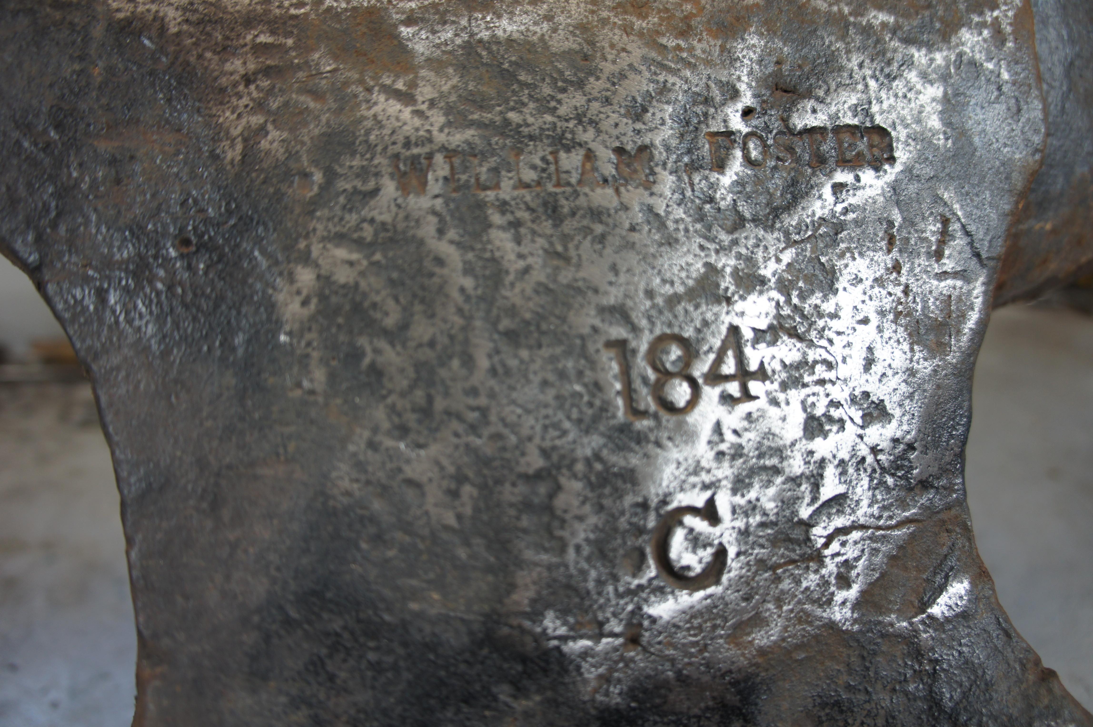

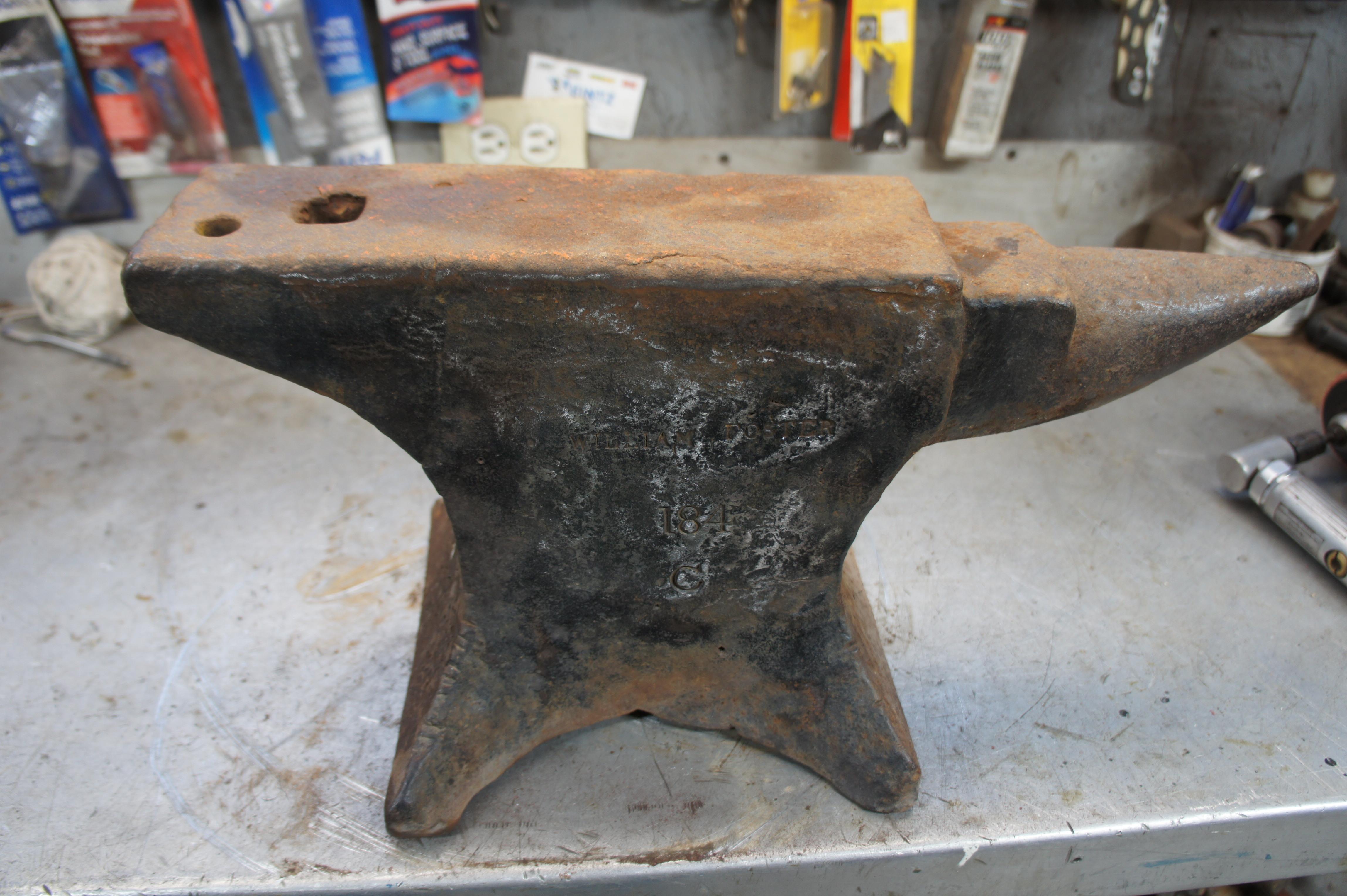

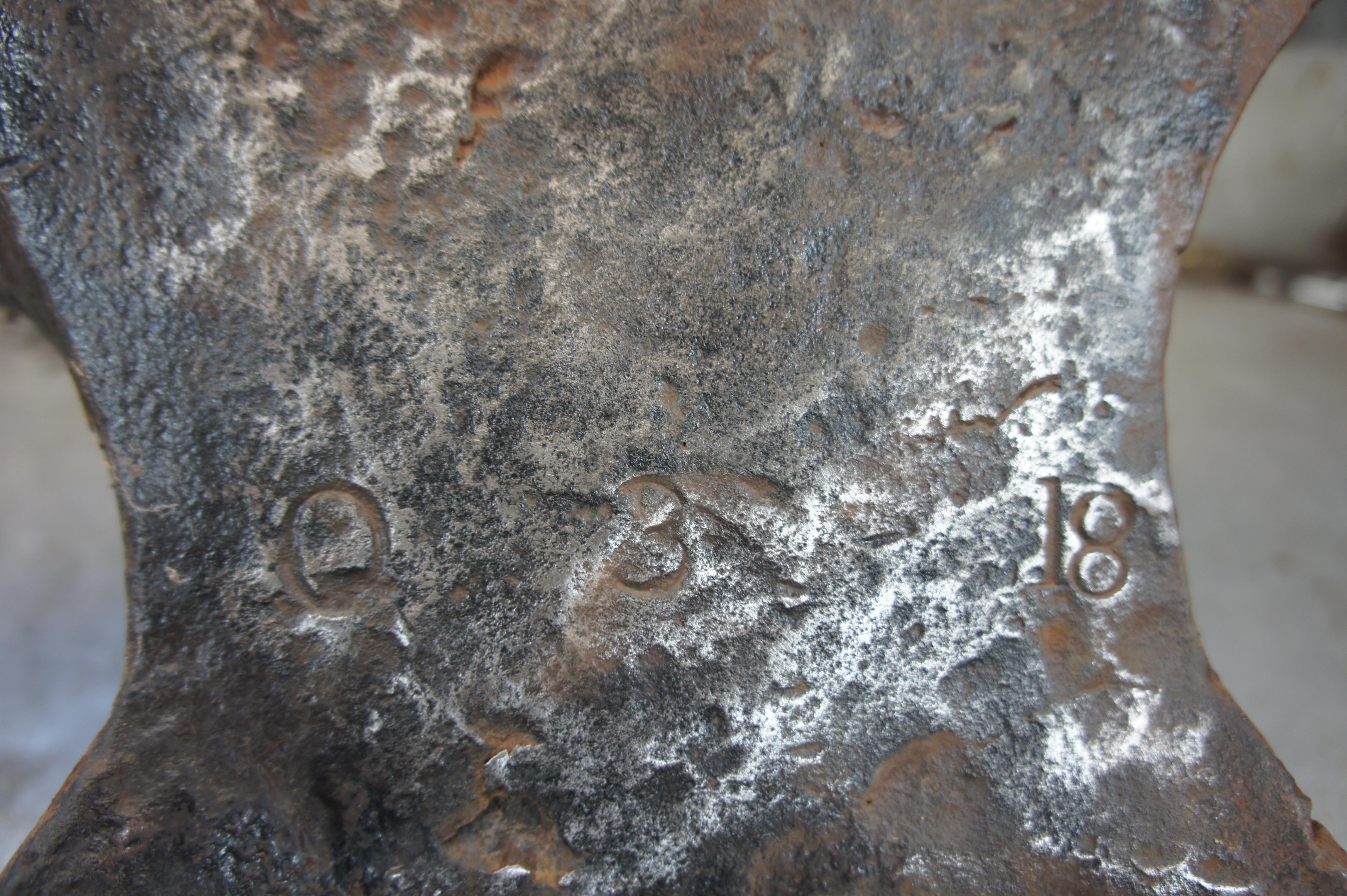

  6. Craig M. DeLong joined the community
