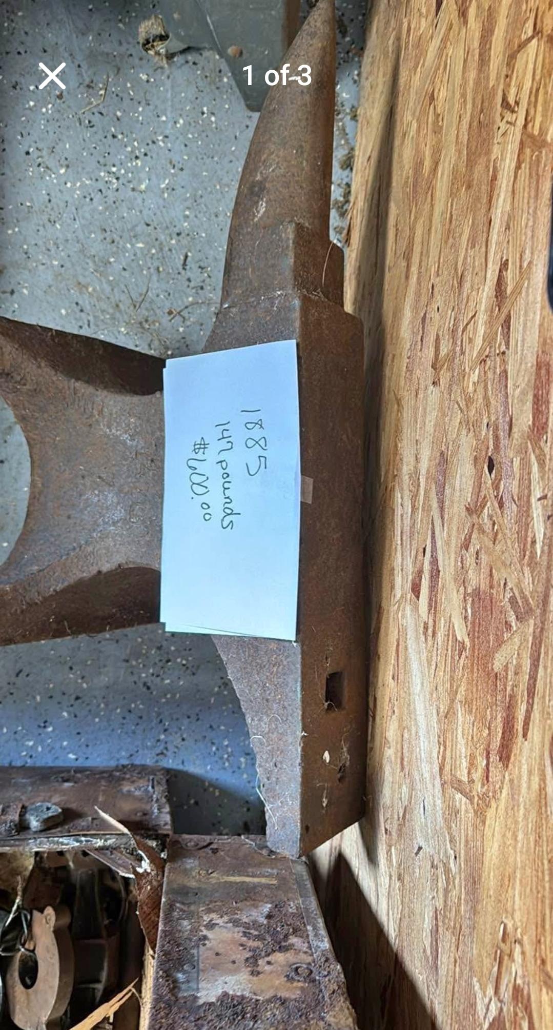

  2. This belongs to a friend & I believe that she has it priced too low. It was her father's & she's selling off his stuff. Any idea what she should be asking?

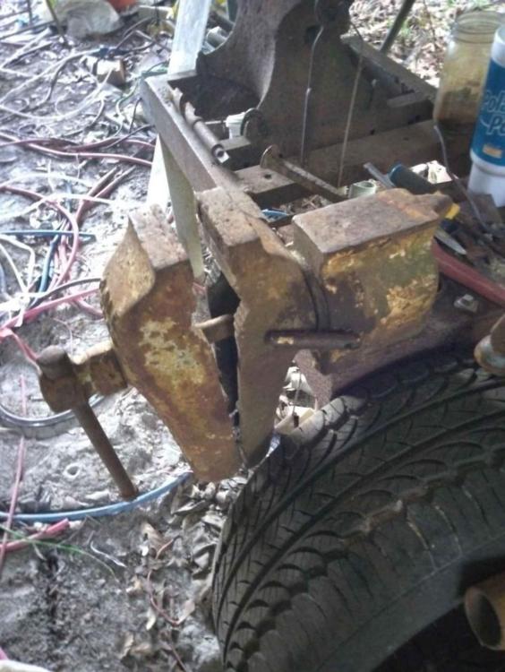

  3. Thanks for the link. They got back to me right away. It's a Cole Manufacturing Combination Vise and Drill.
  4. Anyone know what this type of vise is called?
