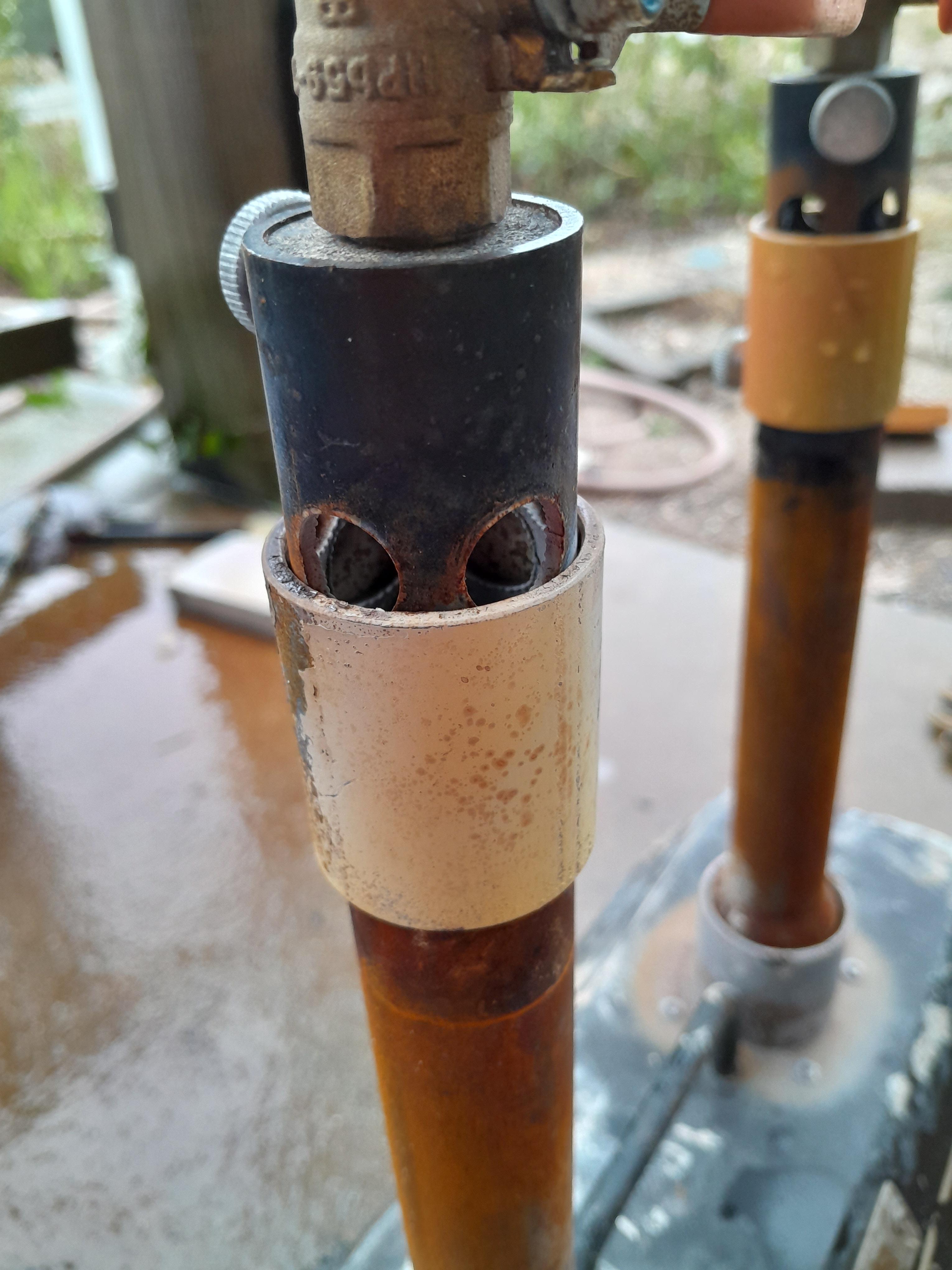

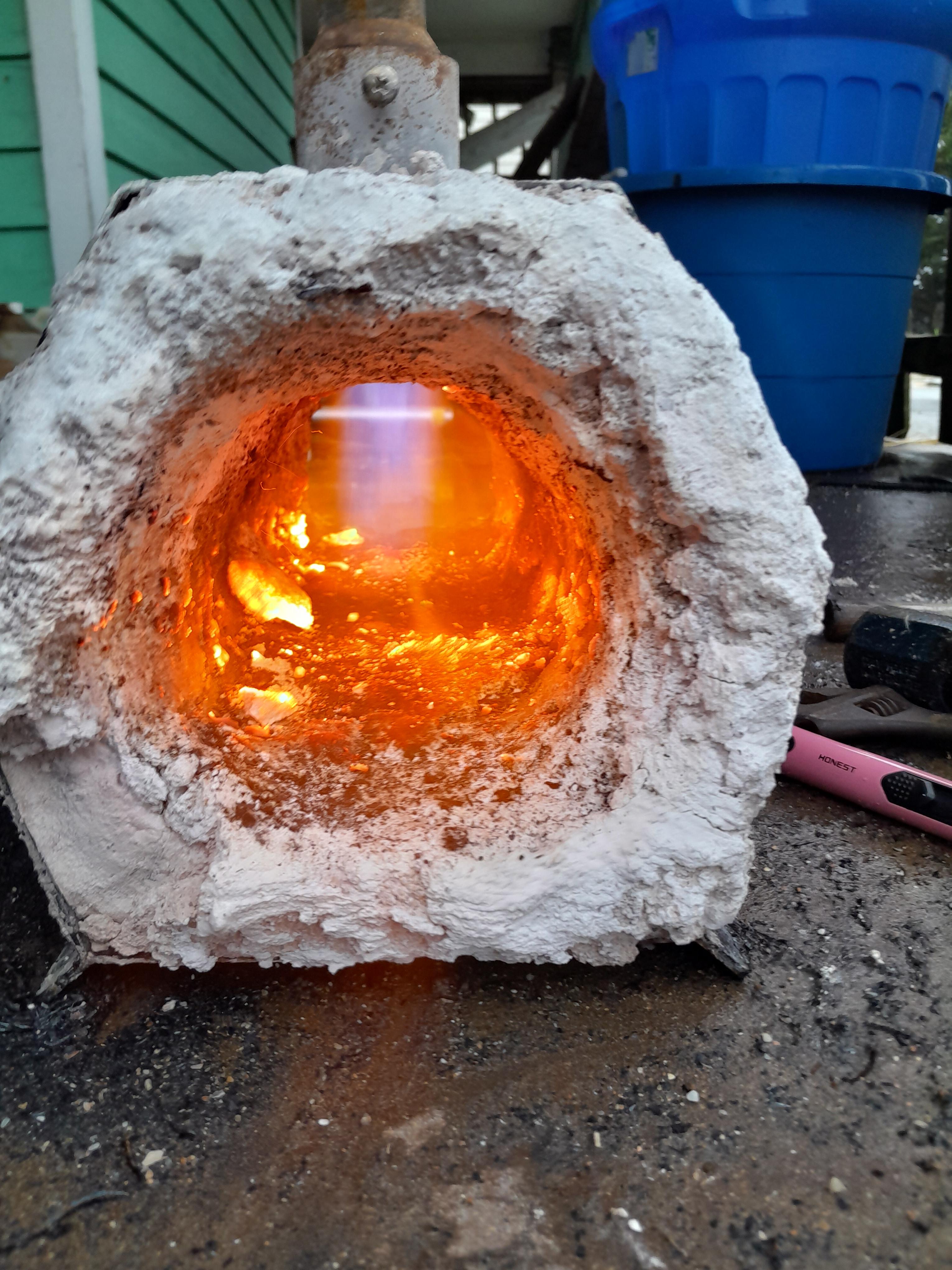

  1. At 11 psi, hiding from wind on floor Current air setting on 1 of 3 choices. #3 makes useless party flame . Ive used about 1.8 high but seem to have oxidizing flame . Can it all be good or bad in space of 1hole?

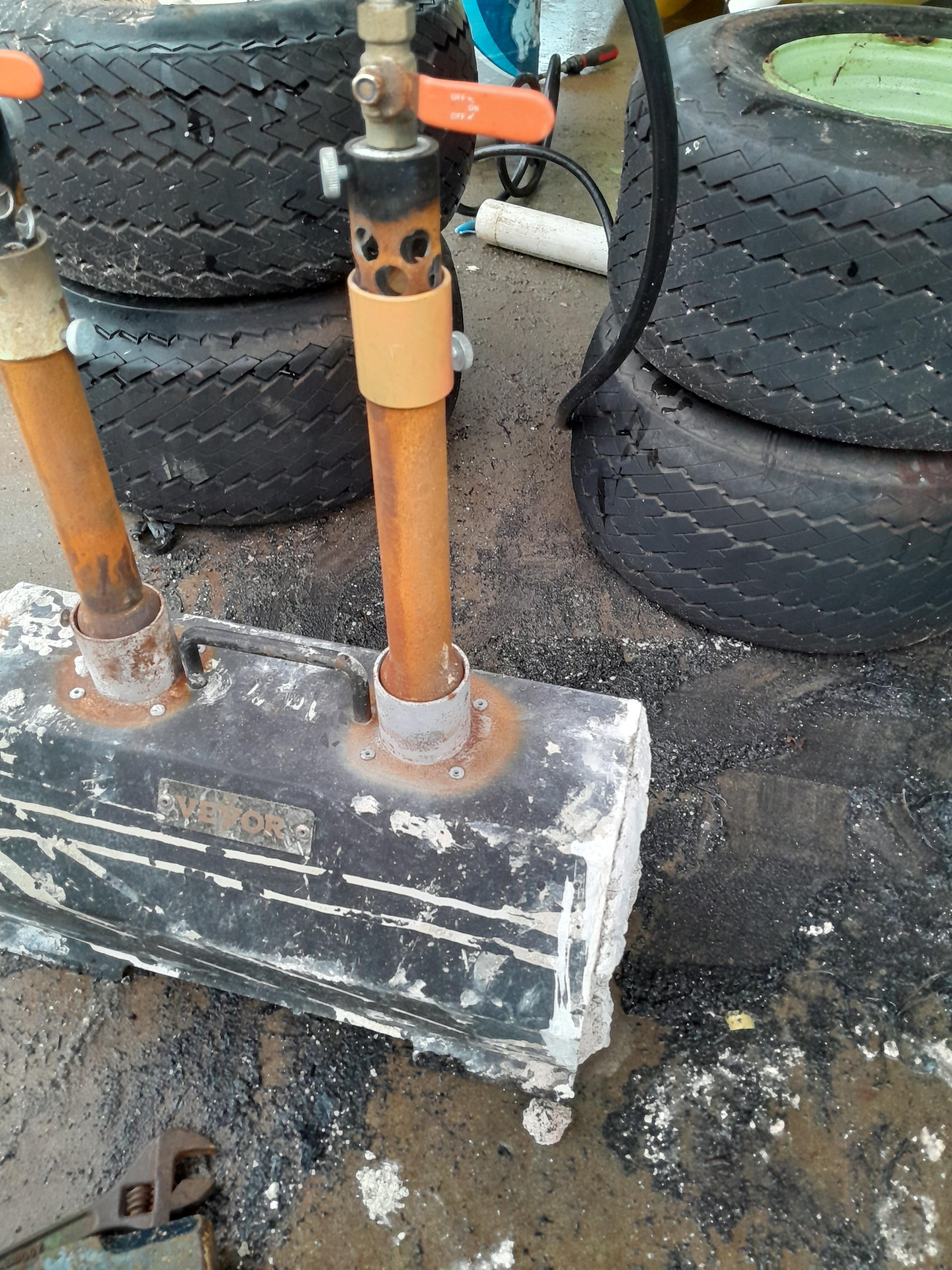

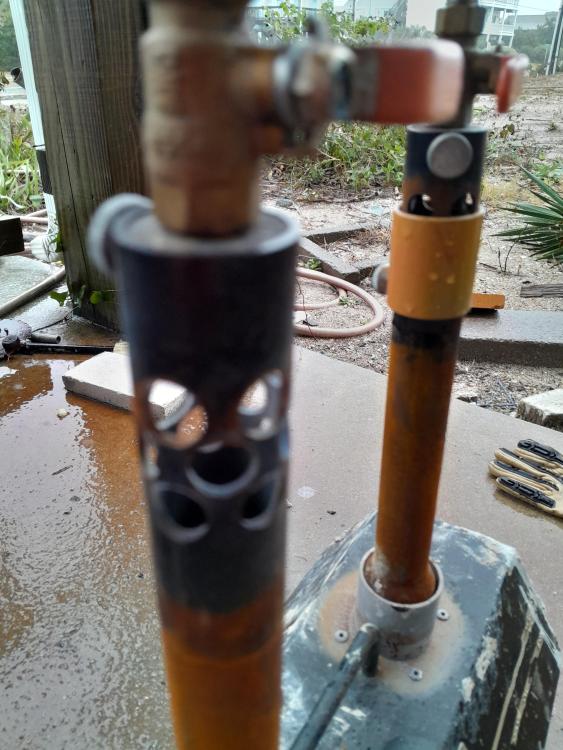

  2. These are the vents for each burner those each have 3 layers of holes, only burning 1 burner, itf i close it anymore a joke yellow flame kicks out but even this seems to oxidize. Ill probably use it outdoors only, dont have indoor room anywhere. Never knew it was so specific to just have working forge. Im in wilburham ma

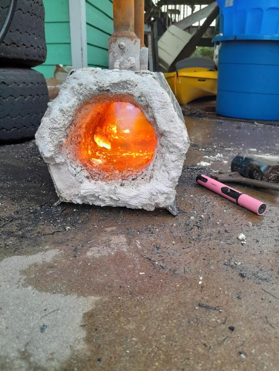

  3. I know daytime pics are less than optimalthis was same side w and without breeze. 18 psi.

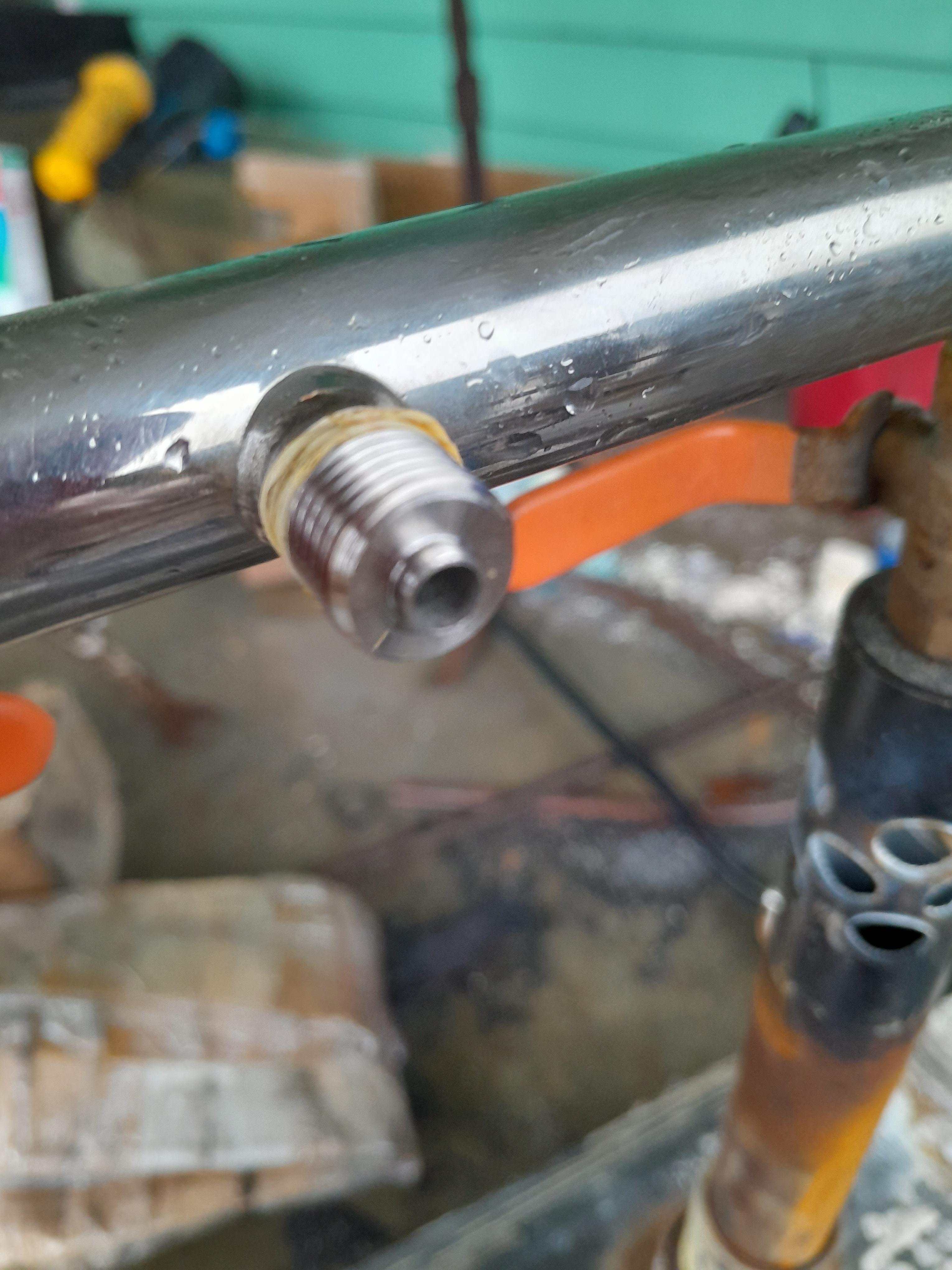

  4. This is my vevor forge gas intake. I had it suggested the forge needs more gas. If i drill this input hole bigger will it have the same effect as getting a bigger mig tips? I know, go slow.
