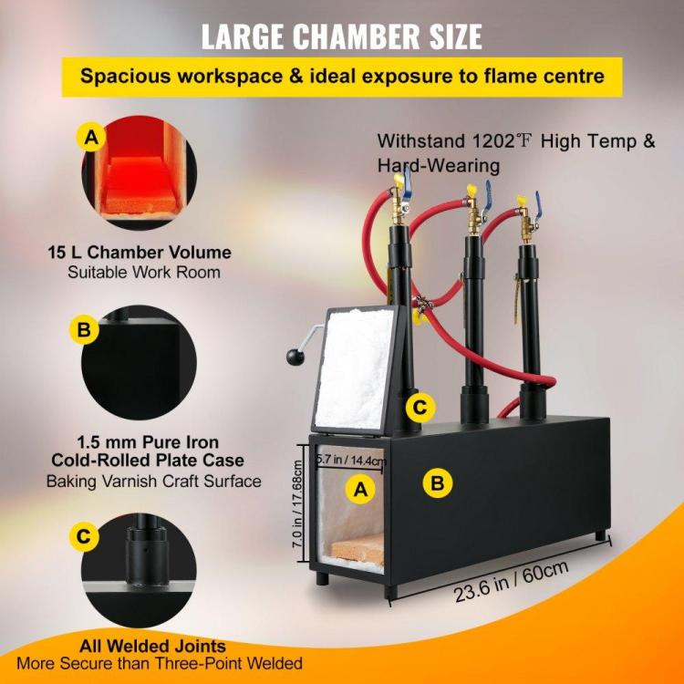

  8. Thank you guys. This is how the forge would look assembled according to the pamphlet. [IMAGE] I'll do as Latticino and Frosty suggests. Please correct me if misunderstood: 1. Get the layers of fabric nice and wet 2. Coat with fumed silica solution as thick as allowed on second layer only. 3. Get it dry for some days 4. Plaster rigidized fiber with refractory like Kastolite 30. Let it dry as per instructions 5. If budget allows, I may use that Zirconia/Silica refractory coating on top of the Kastolite. From the very few video reviews of the forge, it seems that all I may need to do to make it more decent is add more cushion, replace the regulator and those plastic hoses. Thank you. I'll report back once I get something hot with it. It'll be used for forging knives and because I'm cheap and a beginner, to perform all the heat treating steps. No forge welding for now. Ron

  10. Hi, First post here. I'm from Belize, and I may well be it's first bladesmith aspirant in couple of months. I bought one of these vevor forges (not promoting, just giving enough details to my post) It comes with one 1" layer of unrigidized ceramic fiber, to which I'll add another 1" for added insulation. Here are my questions: 1. Do I rigidize each layer separately before inserting the next layer of fiber? 2. Is this product (100% pure hydrophilic fumed silica powder) still acceptable for rigidizing? I already bought it based on what I read here, but now I'm reading, also here, that it may not be good. I appreciate your input: 3. I'm also considering buying the following as a top coat (65% Zirconia, 31% Silicone, and 1% alum). My questions in regards to this coat are: Is it necessary after rigidizing? Is there a better refractory coat to apply after rigidizing? Because I'm not buying a commercially designed rigidizer, I don't have instructions and the methods used vary a bit on this forum. I know it is mixed with water and dye and applied with a spray bottle. Can you clarify the following as well: 1. What is the preferred mixing ratio? 2. Is it left to air dry or do you light up the forge? 3. Do you then re-apply other coats once the first coat is dry? If you have further recommendation on what to do with the forge I bought, please drop them here. I don't mind the reading and I appreciate all the help on the aspect of the forge I can get. Thank you Ron
