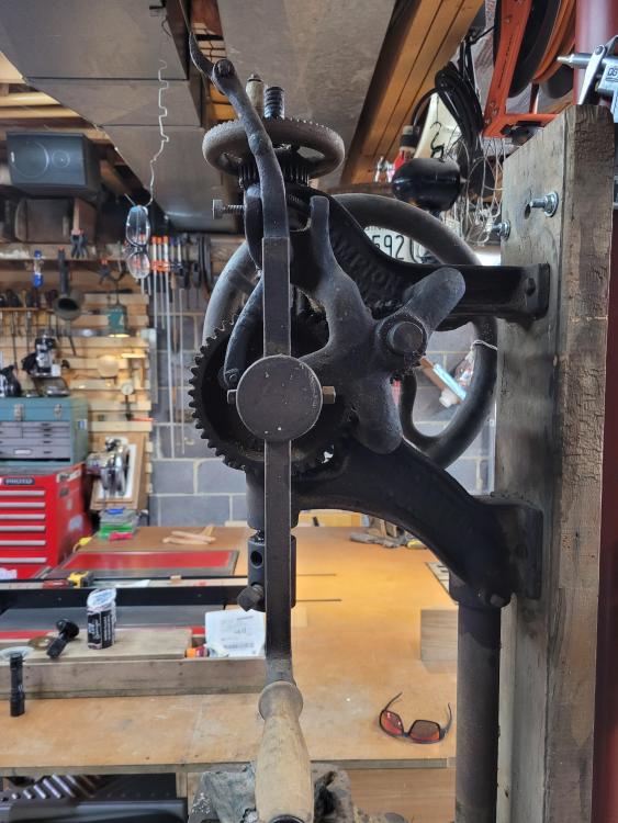

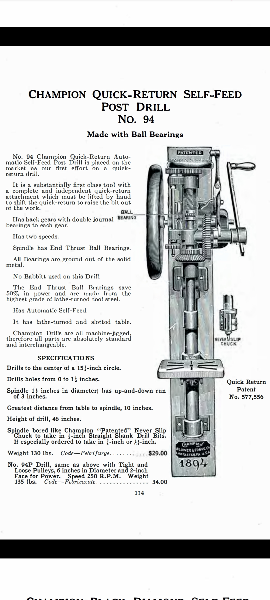

  4. Thanks. I'll take a look. I may have found an answer. It looks like a 94. If anyone has pics of a 94 so I can verify it would be a tremendous help
  5. Good to meet everyone. this is my first post. I picked up this post drill a while back and have recently gotten around to messing with it. I was hoping someone could help ID it. Only thing I can find on it is "Champion Forge Co, Lancaster PA" on the right side if facing it and "Warranted" on the left side. No model I can find, at least prior to disassembly. It resembles a a 96 but there are some distinct differences in, what I believe, is a quick return system. I have scoured pics and period ads for these and have yet to find one that exactly matches.
