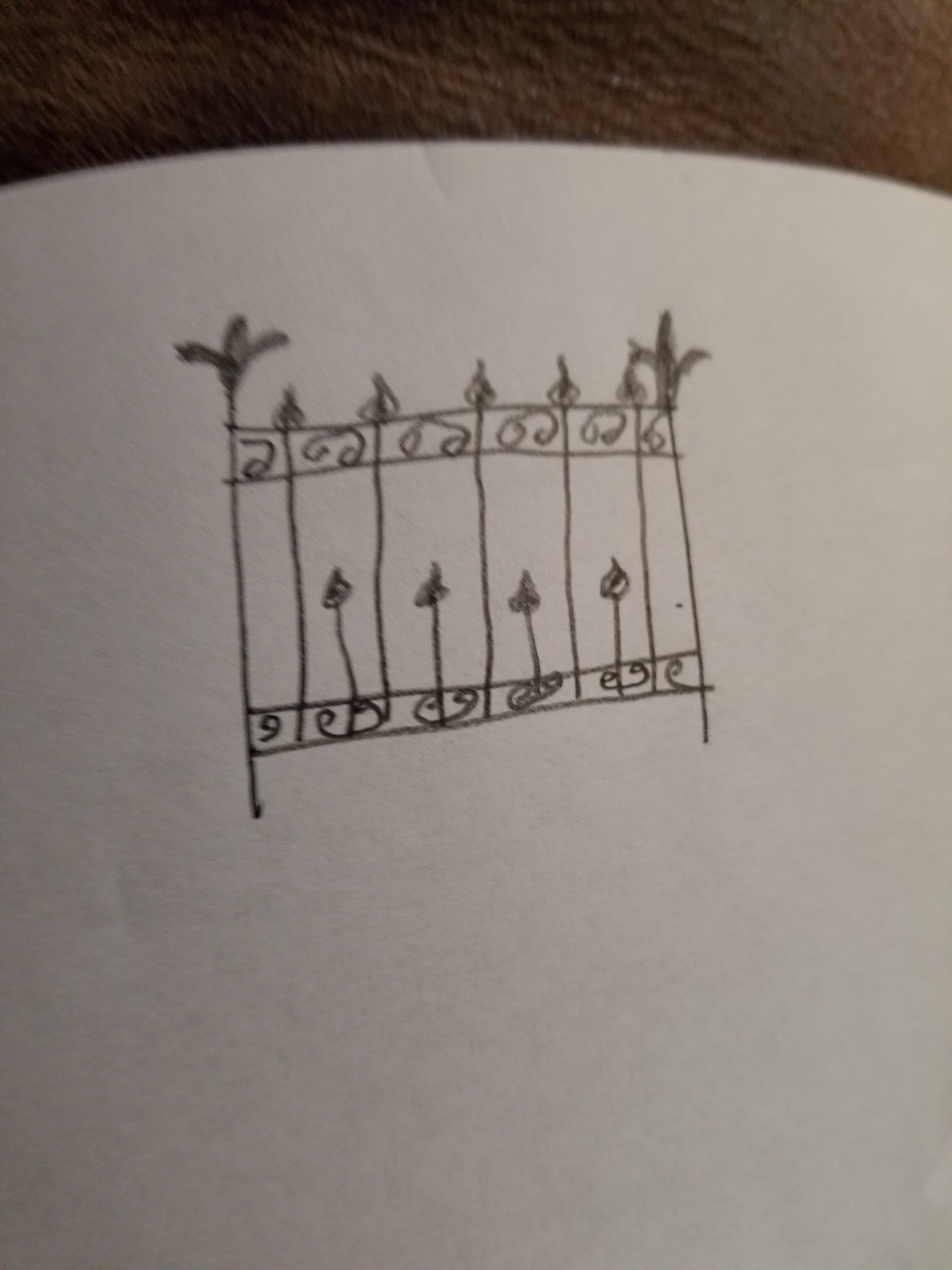

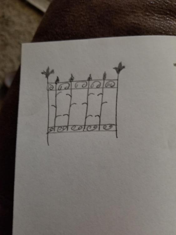

  4. Please excuse my poor drawing ability, these are 2 designs i have for a small fence around our trash bin area. Mostly just decoration and something for me to focus on making. Lots of relatively simple and repetitive parts to practice forging along with some new techniques in joining to practice. I am expecting a high failure rate but looking forward to the challenge. Its going to be about 4ft high to the horizontal and will enclose about a 4x8 rectangle on three sides. 2 short sides and one long side. Which design do you prefer? If for a practical reason, what reason? (Might help me consider things differently for future projects) Stock size recommendations for the different elements? And lastly, thoughts on doing cast bronze pieces for the corners?(ive been casting off and on for a while and have a stock of copper, tin, and bronze) Thank you all for your time and any advice you can give!

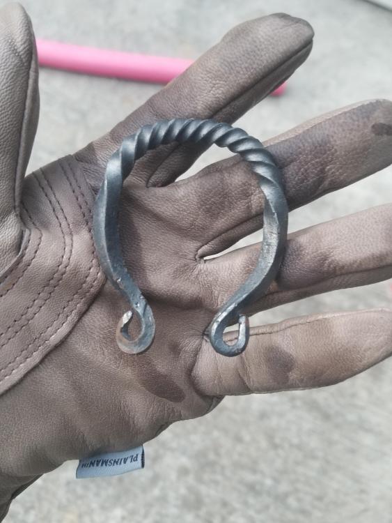

  5. Hello everybody, first post in this thread but hopefully not the last. That dirk looks very nice. I like it a lot. Just finished this up this past weekend, practicing making some hooks and decided to get some riveting practice too. Just gonna use it to hang stuff up around the shop
