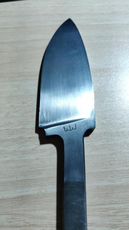

  7. SlimW replied to SlimW's topic in Knife Making
    the very first thing I've ever put a makers mark on:

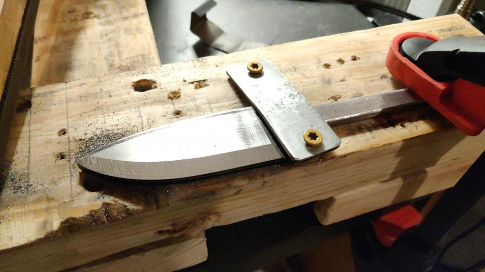

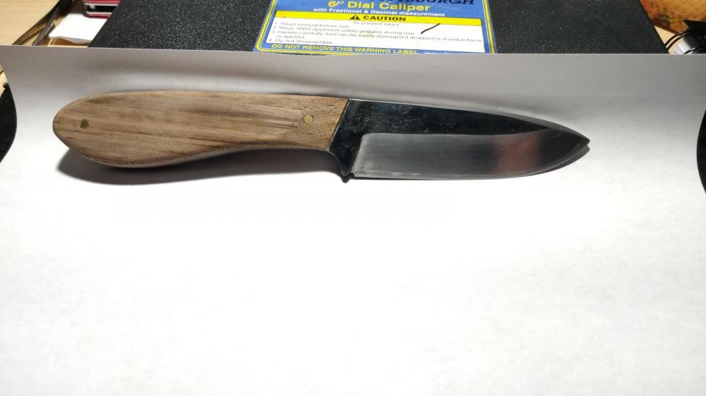

  18. Thank you. I had sanded off the original quench oil finish, it wasn't too durable, and instead I tried cold blue. I used alcohol and acetone to clean the blade before I did it, but it still ended being a little blotchy. I carded it, reapplied, then polished the faces again to get the nice lines on the edges. The scales are walnut, pinned on with the brass rod, and glued with epoxy. I applied some Formby's Tung oil to the scales and I'm letting it dry before I resand with 1000 grit and reapply. The wood does look nicer now, I'll post an updated pic when I'm done.
  19. a little more. I'm not happy with the reshape, now it looks like a steak knife, but oh well.
  20. choil ground, and sharpened. handle next. boy did this take a long time to sharpen. I need a better method. The edge was pretty thick, and I used a sharpening stone attached to my filing jig. It worked, and its precise, but it took me quite a while. I'd appreciate constructive criticism - aside from "mystery metal", what would you guys do differently?

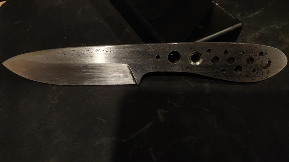

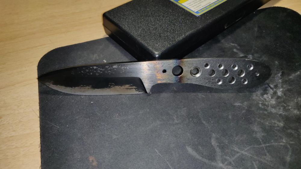

  22. I'm pleased to report that heat treat went well, or at least as well as can be expected. As this was scrap steel, I only knew it was a carbon steel from a spark test against a known carbon steel. I didn't know if it would harden much, or the correct treatment, or if it would warp or crack when I quenched it, and all my work would be wasted. Mea culpa. I decided on a canola oil quench. I tested a few scraps of the same steel, and got promising results. My good file skated on the test pieces after a heat, so I went for it.
  23. perfect Thanks, Frazer and Frosty. This is exactly what I observed. It's a shame, because my smaller bits were making such nice long chips...it's a good thing my friend runs a tool store and gives me a discount
  24. I got the blade sanded to 220, stopped there since I'm going to heat treat it. Decided to drill some holes in the tang to lighten things up. This stuff work hardens very easily, even though I used my drill press at its slowest speed, and stepped through the bit sizes. I have one hole that just wont drill anymore. Oh well. I'll finish the other holes tomorrow.
