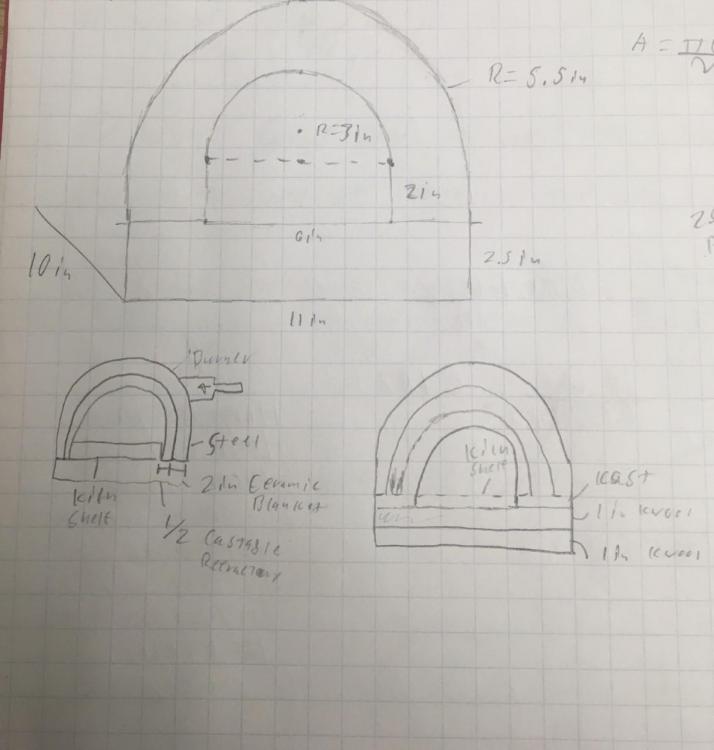

  7. Thanks for the response. it sounds to me that im completely under pressure, since im not using a T burner. Guess Ill fire it up and turn the pressure higher and see what happens over time.
  8. Well I lit the forge today for the first time and it works really well. I went through the best process of heating that I could find and sofar no cracks. This may be a better question for mikey because I used his 3/4 burner design with I believe a .030 tip. What PSI range is the burner? Since im new to forging, I'm not as good at hearing and seeing flames. We currently have a really good flame from tuning but I really only run it about 4-6 psi. Whenever I turn it higher I cant tell if its getting hotter or if im wasting gas. On 4-6 psi I get 2350 degrees F Im pretty confident that im completely wrong thinking 6 psi is a good pressure to run at how much higher should you go for a mikey 3/4 venturi burner? .
  9. I dont know if im allowed to bump old threads. But this thread has all my context and design. Im a few weeks into building the forge as designed above. Ignoring the fact that I cracked the kiln shelf I cut out (I have more) by being stupid, currently, I only have kwool under the kiln shelf on the final design. Should I add a layer of Kastolite under the kiln shelf, or just leave it to the 2 inches of kwool? Similar question, would it be ok if I stacked 2, 3/4 inch kiln shelves on top of eachother?
  10. Thank you for everyones responses sofar. Im glad my overall design hasn't been completely torn apart. I just need to tweak a few things like the door situation. A question I didnt include as much in detail was the forge length. Currently with the 10 inch length I get 261 in^3. If I raise it to 11 in Its only 287 in^3 or even 12 inches. I know from previous posts that 1 well tuned burner is about 300-350 cu^3. Assuming my burner IS well tuned and made properly, I could add more. Is there any pro or con to making it slightly longer? Does the extra material act like a heat sink or does it just hold in more heat?
  11. I will definitely look into that more before starting. I completely spaced the porch (I wouldve realized eventually). My thought process behind it (Outside of doing what you said and just making it as smooth as possible) was to make the top slightly smaller so it slots into the base a little. Or using kwool/kastolite in a fashion where it seals the gaps. Like gum over a leaky pipe I dont think Ill ever need to take it apart so I could just kastolite the crack between the tops wall and the kiln brick couldn't I? Then kiln wash over it all and tac weld the corners together? Is it that easy for flame to escape through cracks?
  12. Right now its setup so it has an even opening on both sides. Should I make the back opening smaller? so it has space to pass through if needed but its more closed off to keep heat in?
