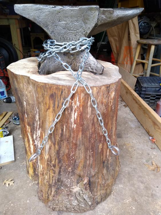

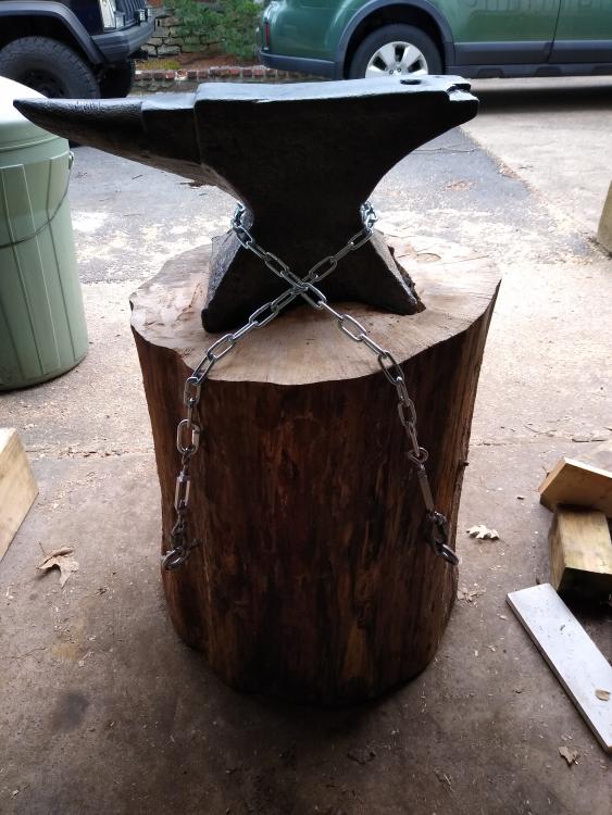

Got it mounted up. I had leveled a little pocket for the base to sit in, so hopefully it isn't going anywhere. The chains can be tightened if they loosen up. I threw some extra chain around the waist, but I'll experiment with it. It isn't anything, but I heated some rebar as hot as a MAPP torch will get it and smushed the end. I felt like Hercules... Can't wait to get my real forge set up. Thanks again for all the help everyone.

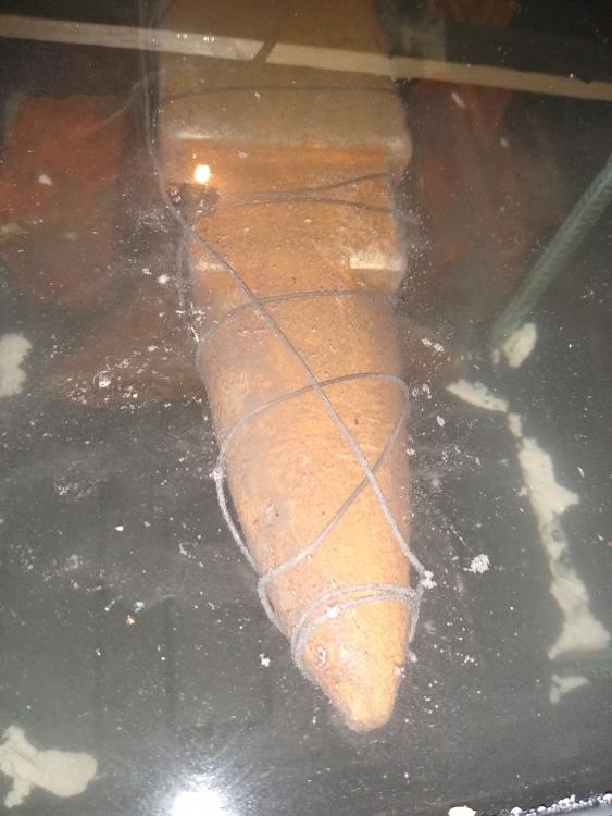

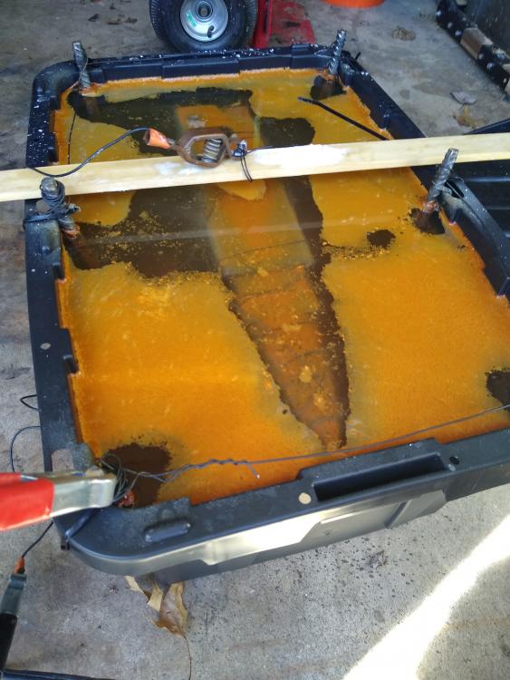

Just the regular washing soda. I think the ratio was like 1/2 cup per 5 gallons of water.

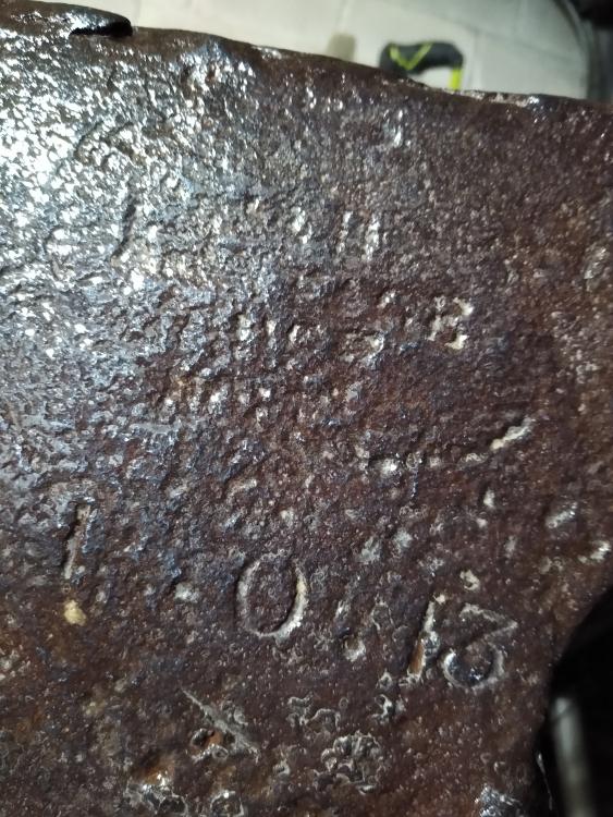

Please help ID vintage (English?) anvil

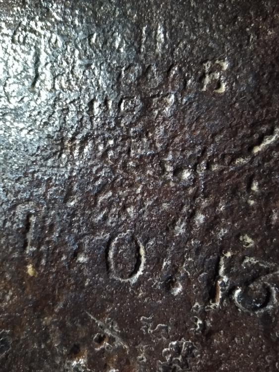

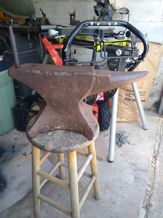

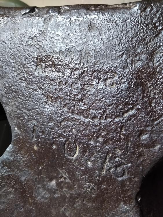

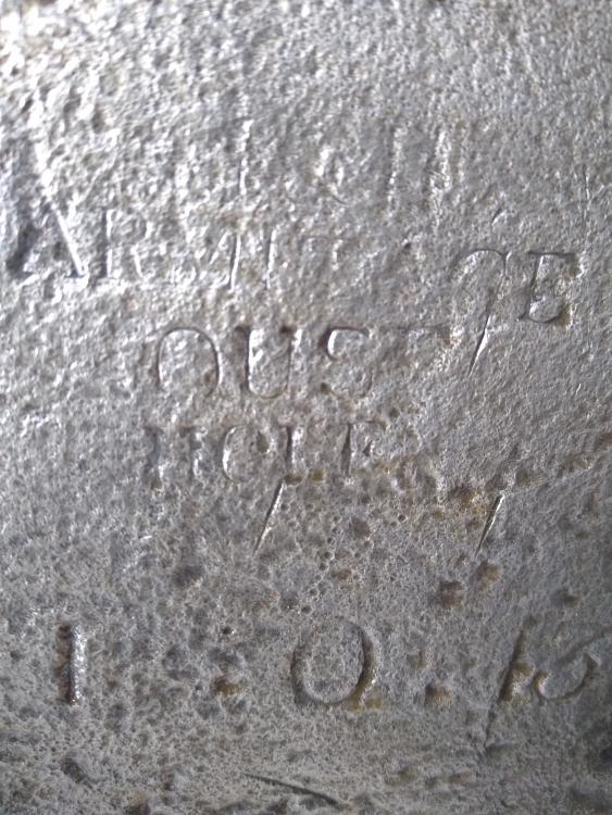

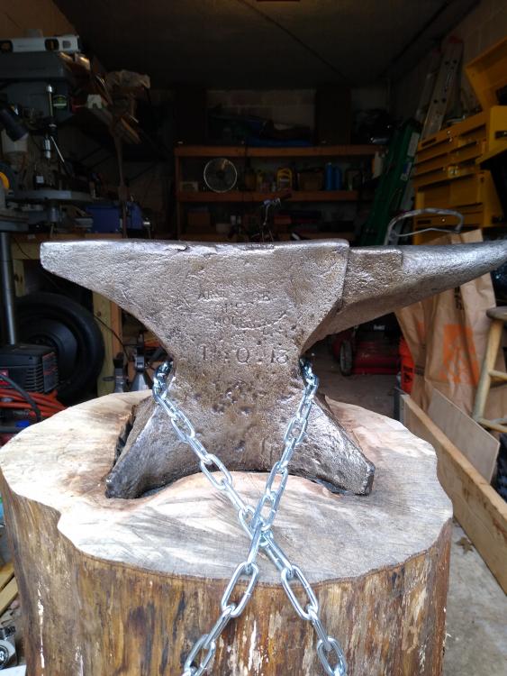

I figured out what it is. 1830-35 Mousehole. The stamping is: M&H ARMITAGE MOUSE HOLE 1.0.13 I've got the Anvils in America and Mousehole Forge books by postman ordered. Things became a little more clear after some vinegar cleaning. Next I tried electrolysis, and I was very impressed. I'm going to mount it up on a stump that I happen to have, but I need to level it. I'll post a picture when it's all mounted (if I remember). Thanks for the help everyone! Jesse

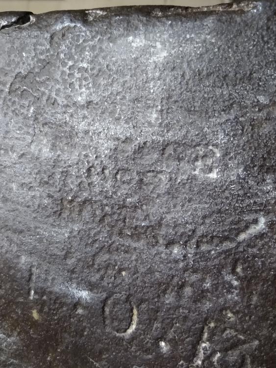

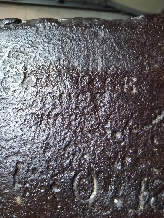

Thank you Steve. I'm in SE PA too, just North of Philly. Originally from Central NJ. The seller said when he sprayed it with WD he saw the date and Foster, or something like that. I don't think he was trying to deceive anyone, but I'm not seeing it. I hope you are right about it revealing itself in particular lighting. I'm going to try to do some gentle rust removal (no grinding). I don't want to risk damaging the stamping that is there. Hopefully that makes it a bit more clear. I'll need to get myself a copy of that book. Does anyone know if the hundredweight markings would make it most likely English? When did they stop using that system? I'm hoping to get a date range at least. The pritchel hole commonly began in the 1830's I believe...

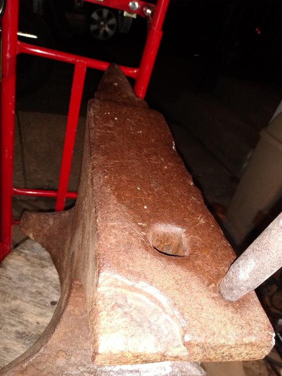

Hi, I bought my first anvil today. The seller said it was a 1840 William Foster, 150lb. I'm not sure I trust his assessment as I see 1.0.13, which to my very limited understanding would be 125lb. Anyway, I don't see a crown, or a date, or anything else that would ID it as a Foster. It's just too hard for me to read. I tried baby powder, oil, and a combination, but I can't read a thing on there except the weight and a few letters. Does anyone have an idea what I've got here? Regardless, I'm pretty excited to start using it. It's in pretty good shape except the chip in the face at the heel. Edges on the one side have dings, the other looks good. Thanks in advance!
