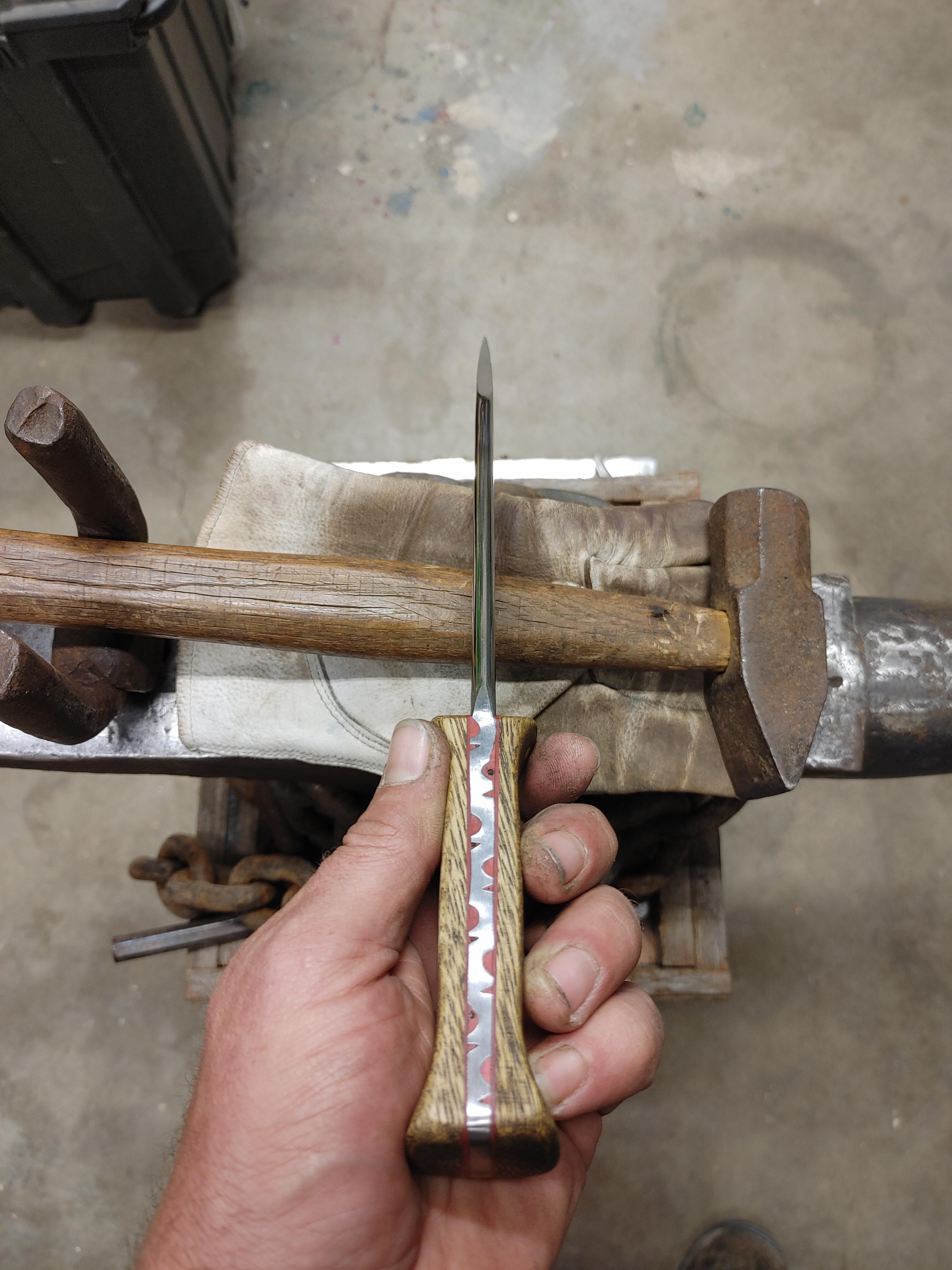

  4. So I just made the knife shown in the picture bellow and was wondering if anyone had suggestions on what I should use as a finish coat on the handle? I was thinking maybe bee's wax or linseed oil. I don't really want to do a poly coat though.

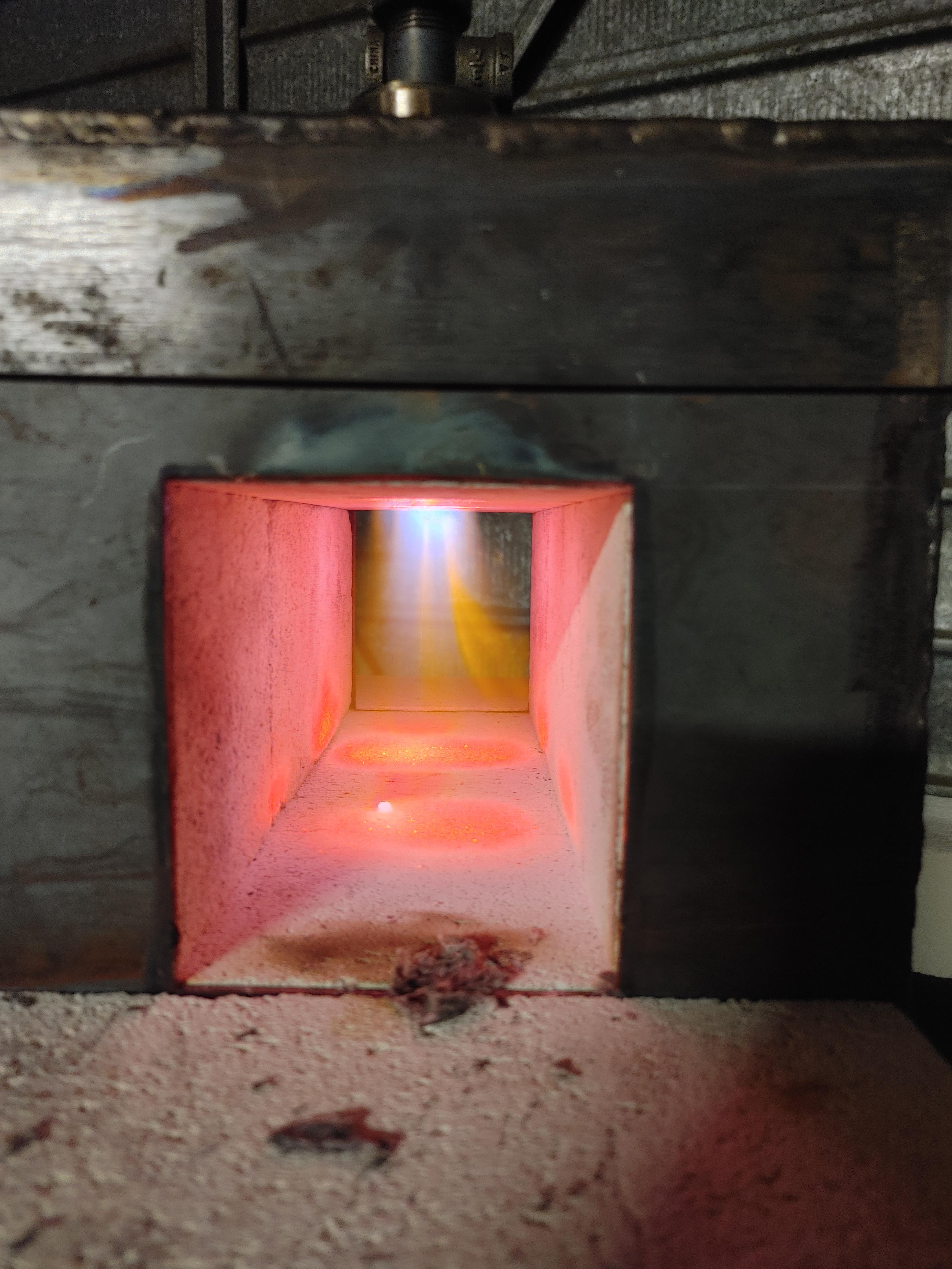

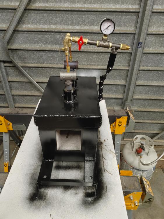

    So here's the forge after making some adjustments to the fuel lines adding a fuel line support. I felt comfortable enough at this point to add a coat of high temp engine paint. Also included a picture of the burners running with the adjustment that Friday made mention of.

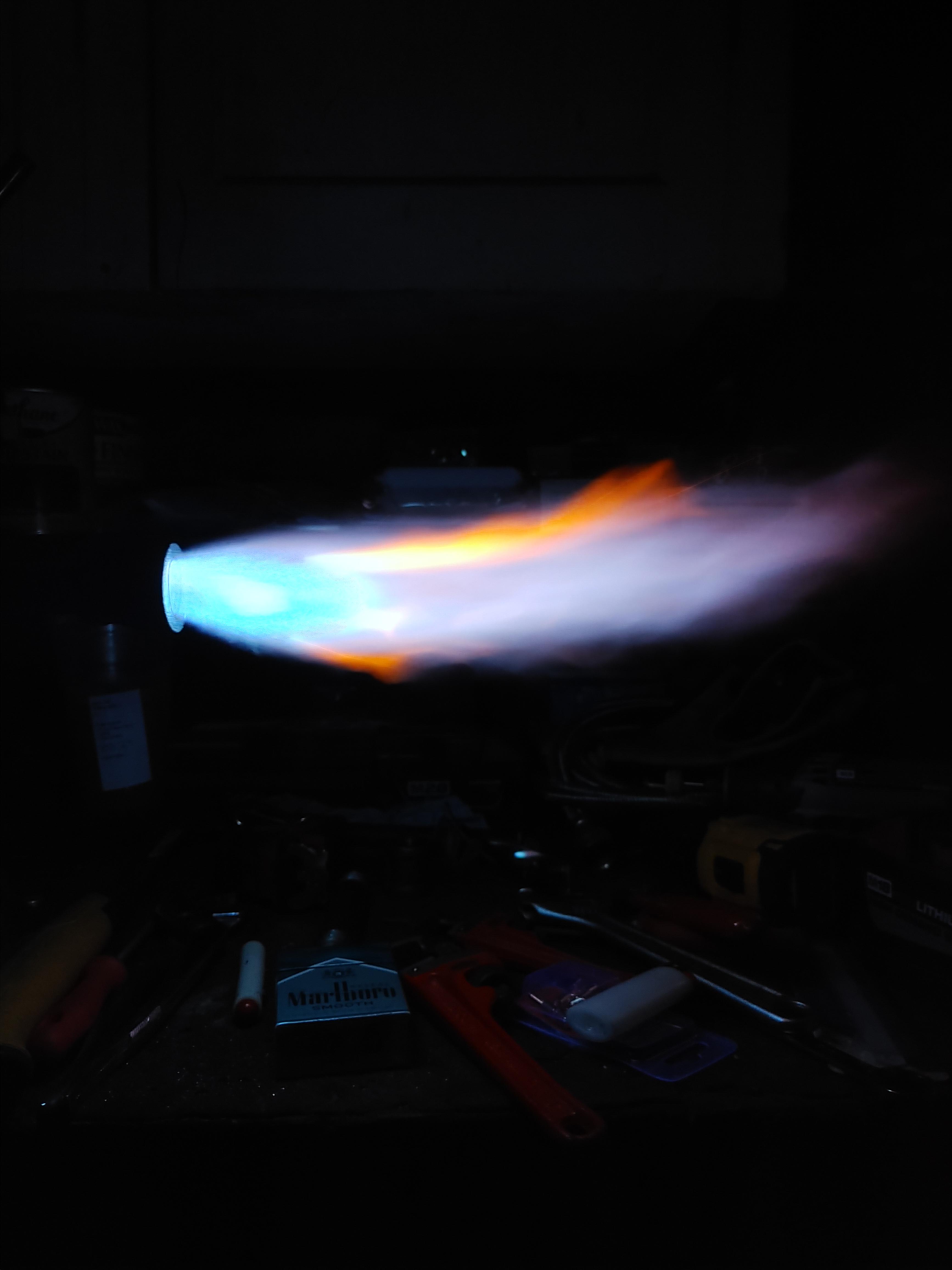

    Well, here it goes. I first repaired the leak. Turns out I forgot to put thread paste on that fitting, (I did use threat paste as I know teflon tape doesn't react well with propane). Still had the issue. Next I took the mig tip out and cleaned it out with the proper sized mig cleaning tool. Put it back together and it worked just fine. Frosty, I realize that my setup is a bit unorthodox with the copper tubing and brass fittings and all that. I was doing the best I could with the supply that I have at hand. With 3 different hardware stores in close proximity to me I was unable to find the hard lines that I've seen so many people use. I currently don't have an official support for all of it, but the braided propane hose is stiff enough and the way it sits on the tank provides just enough support to take the stress off the copper lines. However, I do plan on improving this part of my design in the very near future. I'm thinking I'll have to go to a plumbing supply place in a different area entirely to find what I need. Check out the picture to see the burner in action and let me know what you think of its shape, color and if you think I need to do anything to make it neutral. The top picture is of the problem burner after I got it going again. The last picture is of all the plumbing.

    Hello everyone, So I've completed my forge build and started my burners. One burner stays on with no issues but the other one has a flame back up into the mixing tube and sputters with small flames coming out of the air intakes. I am running 2 1/2in burners at 4.5in apart, my interior dimensions are 4.5Hx4Wx13.5L, if my math is correct I'm at 243cu. My burners are both dropped into the forge at roughly 3/16in. I've tried increasing and decreasing my fuel pressure from 5psi up to 10 and back down to 3psi. The sputter at 10psi is much faster at this point with less flame out the intakes. The one burner continues burning just fine. Any ideas on what is causing this? Some pictures below.

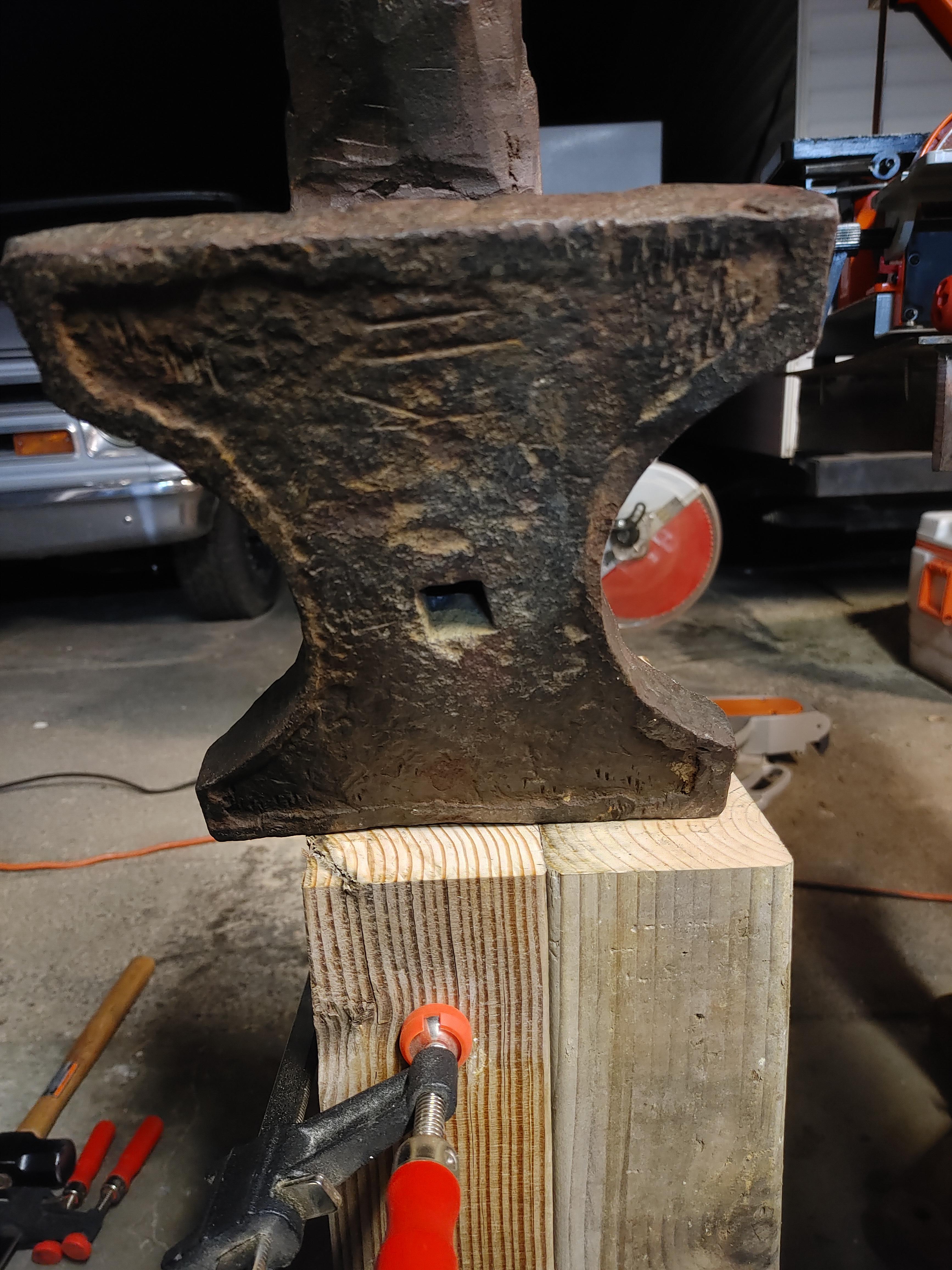

  19. Hi everyone, I just bought a Hat Budden anvil and I've followed the info trail to lead me to believe it is a pre 1895 HB. It's a 96 pounder and has the Hay Budden company logo on one side with weight under it and on the other side has B&H OUR BEST on it. Below the horn next to the handling hole is either a 6 or upside down 9. It has 3 handling holes, one under horn, one under heel and one in center on the underside of the base. It looks like it could be a three piece anvil butt it's hard to tell. The numbers on the left foot face appear to be 43548 or 48543. Any help determining the year this beauty was born would be appreciated. Thanks

  22. Okay, so here I am again! I've changed the length of mix tube, done a little fine tuning of the orifice, tapered the inside of the mix tube so that there is a smoother transition between all the parts down from the T. The mix here are some pictures of what I'm working with now. The flame shown is while running my propane at 5, 8, then 10psi. I feel like I'm close, but please tell me what y'all think.
