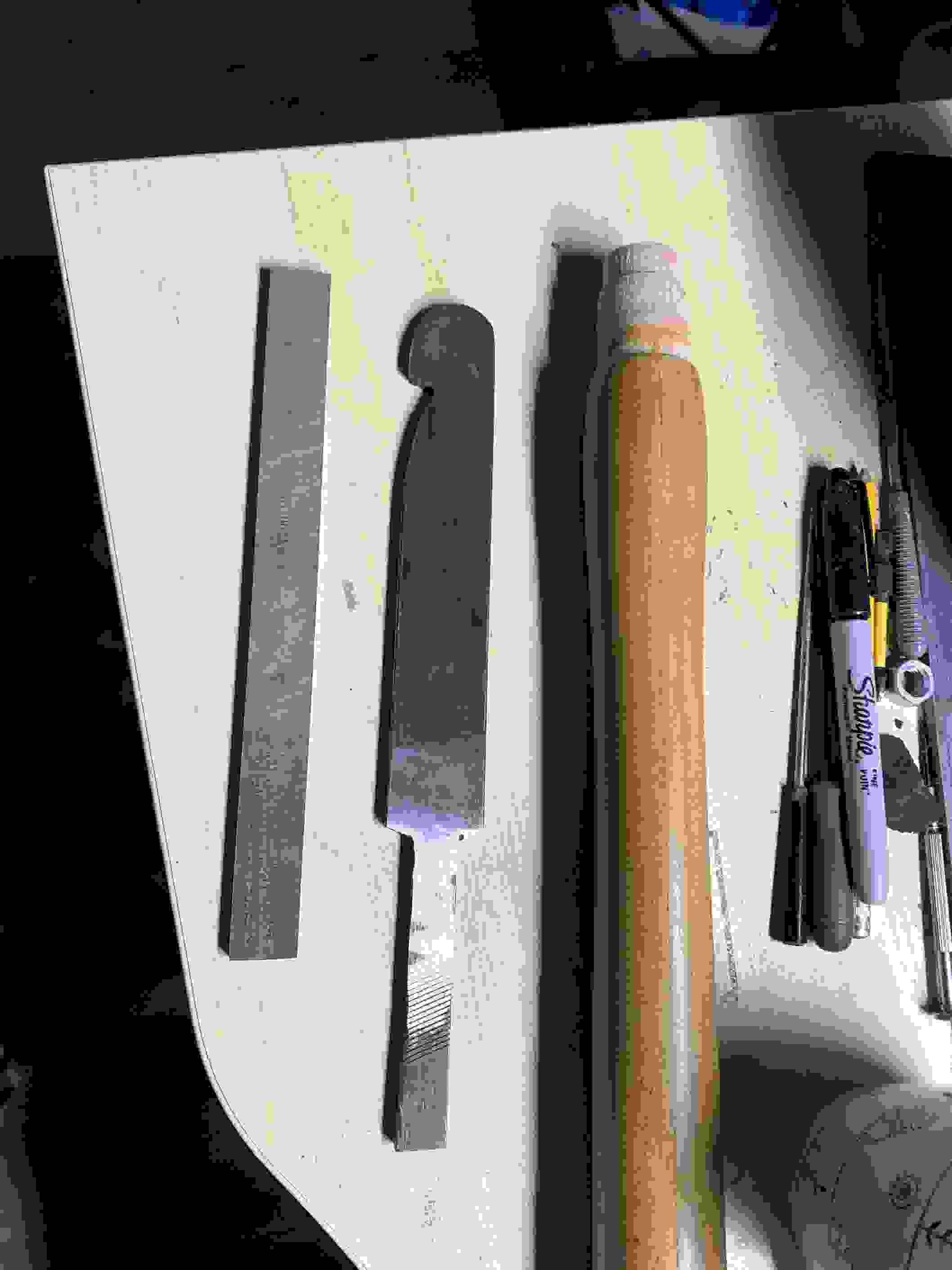

  1. I made a few carbide tools but scrapers work better inside a bowl. I hardened and tempered the file. The M2 is ready to go. No treatment.
  2. Its hard cant file it, Just needed a bevel to sharpen on the wetstone. Is prybar steel high enough carbon for a wood tool? I have a few that have become too flat to actually pry something, Yield Strength: 50,000 psi Hardness: Rockwell B95 (Medium) Heat Treatable: Yes Max. Hardness After Heat Treatment: Rockwell C65 Specifications Met: ASTM A600
  3. The file I ground to shape, heated till non magnetic in a "coffee can forge" plus a few minutes, then into the oven for a few hours. Seems hard enough when sharpening and real sharp. The M2 I just ground to a sharp edge. Didn't require any shaping.
  4. The square scraper is M2 off of Amazon. Probably turning Mahogany, maple, Oak and any species pen blanks I can get my hands on. Epoxy and acrylic too.

  7. Made an S shape tool rest for a wood lathe, in a mini paint can forge from some 5/8 rod. Not enough material for the post. I am trying to buy a small 5/8 piece from metal center, but not sure which to buy, [hot/cold rolled] or if it even makes a difference welding to some unknown steel.

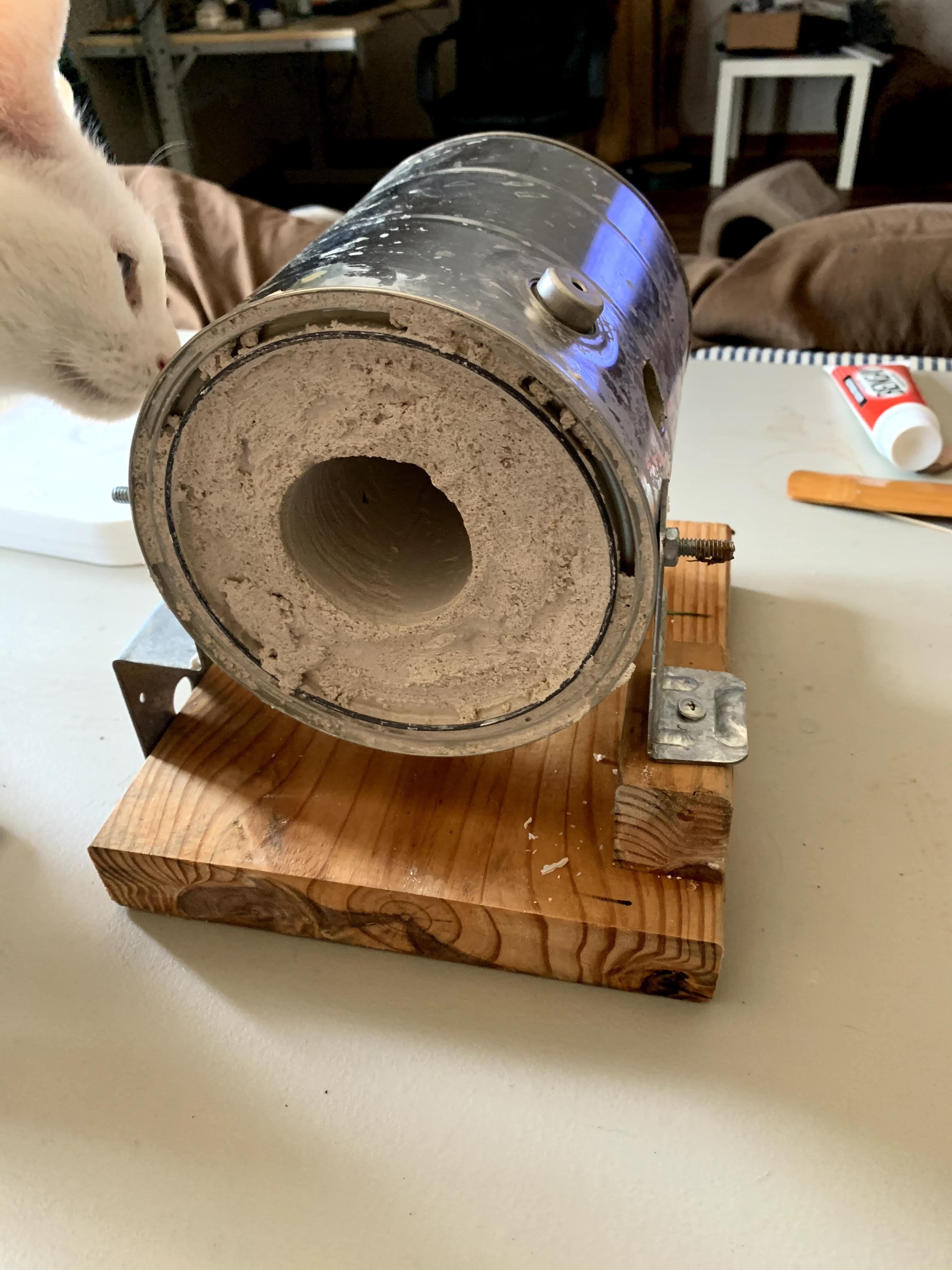

  8. The M2 is just a blank off Amazon. No idea as to specs. Searching the web for tool steel suppliers, all seem to want to sell 3ft plus, no small quantities. The 3mm thickness may be an issue but cant find small thicker pieces anywhere. uxcell HSS Tool Bit Square Lathe Turning Grinder Cutter Mill Blank 3mmx30mmx300mm
