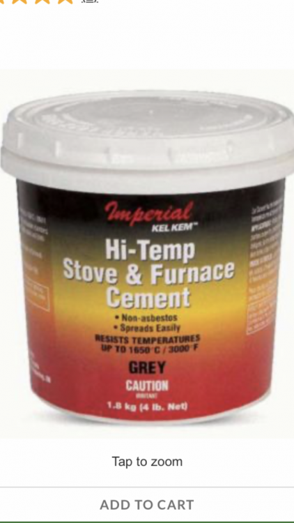

  5. Awesome that helps a lot. I will probably just go with the 9.2lb and fallow up with a coating of ITC-100 once the kastolite is cured. Thanks Jasent!
  6. I found some kastolite 30 that is in Canada. My last question is how much will I need for a forge that is 5.6” x 5.6” x 16” long. it comes in two sizes. A 55lb bag and a 9.2lb bag. Does anyone have any idea if the 9.2lb bag will be adequate? Thanks for your input pnut!
  7. I’m from Canada. But yes I’ll do that it makes complete sense I will update my profile right away. Thanks Glenn I will update my profile with my location ASAP. Thanks for your input appreciate it!
  8. I just recently purchased a forge and have a few questions about where to go from here. The forge came with a rigidizer which from my knowledge is just to harden and hold the kaowool in place. I know ITC-100 seems to be the go to refractory but it’s not available in my area. I uploaded a picture below of some stuff that’s readily available which says it’s heat resistant up to 3000F. Wondering if that’s a waste of time and money to use that product. TIA!
