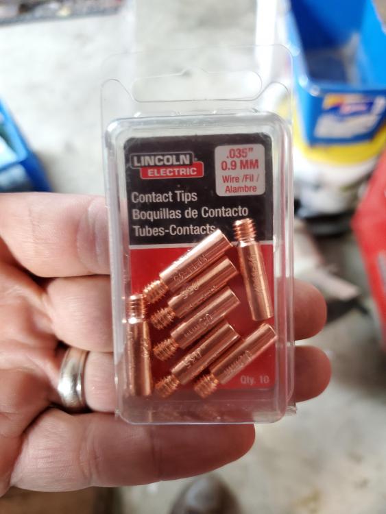

  1. Thank you for the tip, Buzzkill. You're correct. My mixing tubes are 6" long. I'll be getting some 4" tubes today and playing with the flame again. Two weeks ago, I tried using some stainless steel pipe coupler instead of the 1/2" to 1" bell reducers. I don't know if it was due to the long mixing tubes or what, but the flame didn't like the pipe coupler setup at all. One of the burners absolutely refused to stay lit. I will try the the couplers again with the shorter pipe and see how it does. Thanks again for the tip!

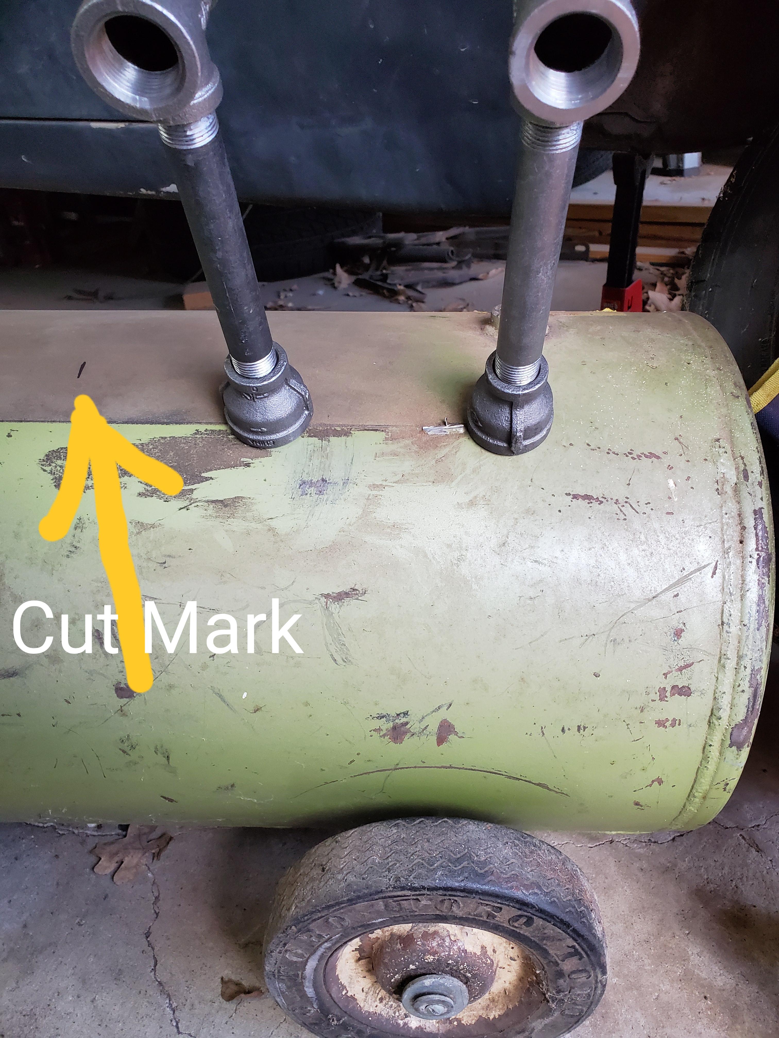

  11. Lol... Will do! I'm pretty sure the tip in the burner furthest from view still need to be trimmed a bit. It's a little longer than the other. I just figured I'd wait until they were in the forge to do the final tune. Should the holes in the tank for the burners be cut to fit as tightly to the half inch pipe as possible while still allowing it to slide up and down (when not tightened, obviously...) for adjustment?
  12. My burner spacing look ok? I haven't cut the tank in half yet, but I put a black mark where it'll be cut to show where these burners will be centered. Should the holes in the tank for the burners be cut to fit as tightly to the half inch pipe as possible while still allowing it to slide up and down for adjustment?
  13. Tried to just reduce the 3/4 T down to 1/2" pipe... (1st video) That certainly didn't work... So I went and got the 3/4 - 1/2" T and, trimmed the tips back quite a bit, and it looks like I'm back to a similar flame as where I was with the 3/4" burners. I'm gonna leave it a lone until I get them mounted in the forge, at which point I'll finish tuning them. Anybody see anything right off the bat that I missed or could do different/better? 20191206_100805.mp4 1/2" burners, take 2... 20191206_134823.mp4

  20. My username isn't a joke. I'm as ignorant in these matters as they come. I haven't come here thinking I know anything about what I'm doing. I've come here to make sure I do it as close to correctly the first time as I possibly can by asking those who've already done it correctly. The reason my tank is as long as it currently is is because that's what I was given. I've done a lot of research looking for answers to questions that I have, but there are many questions that I don't even know I need to ask. What interior diameter/length should I shoot for? Should I avoid building something that requires two burners for the time being? While I'm not currently aiming at forging sword-length blades, I am interested in doing some 18-24" blades along with the other smaller blades that I'll do more often. I'm not married to any particular dimension. I'm here for the sole purpose of humbly asking those who know to teach one who doesn't. Tell me what I'm doing wrong and I'll fix it.
