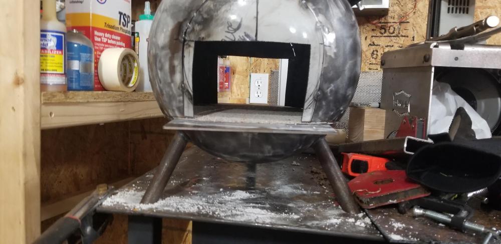

  1. DanR- it seemed to have a swirl effect in the forge.... im just happy it worked at this point. My jets are a tapped a little off. I haven't calculated the cubic inches, I will do this weekend. I am glad I put on an idle circuit. I will order the light firebrick and put in a proper shelf. Mikey- I was surprised how quick it heated up, my expectations we exceeded. It was nice to put a hammer to some steel. It has been years. I appreciate your guys' input. Ill put the metrikote on this weekend and hopefully make a few hooks or firepit tools.

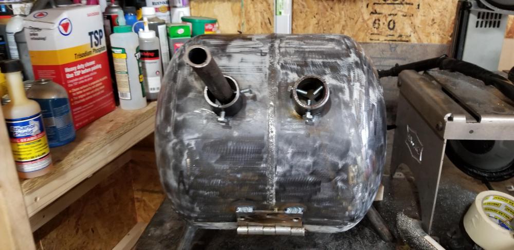

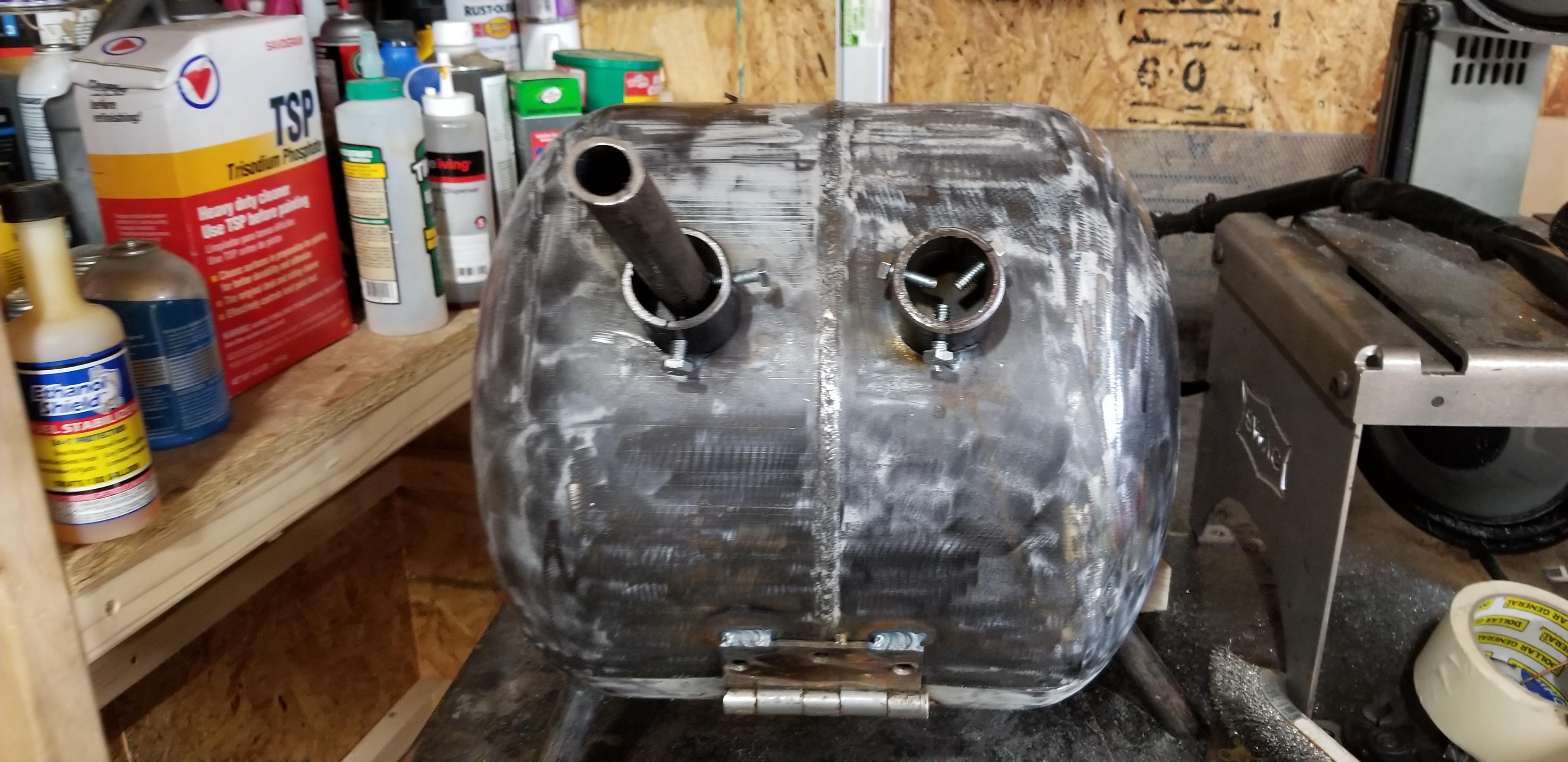

  2. Fired the forge for the first time. Definately need to look at burner tuning.
  3. Irondragon. Thank you!

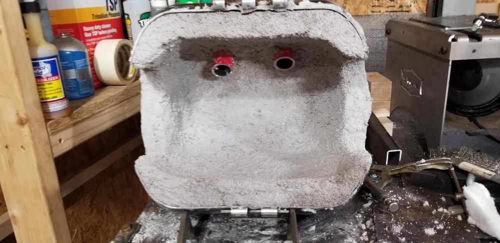

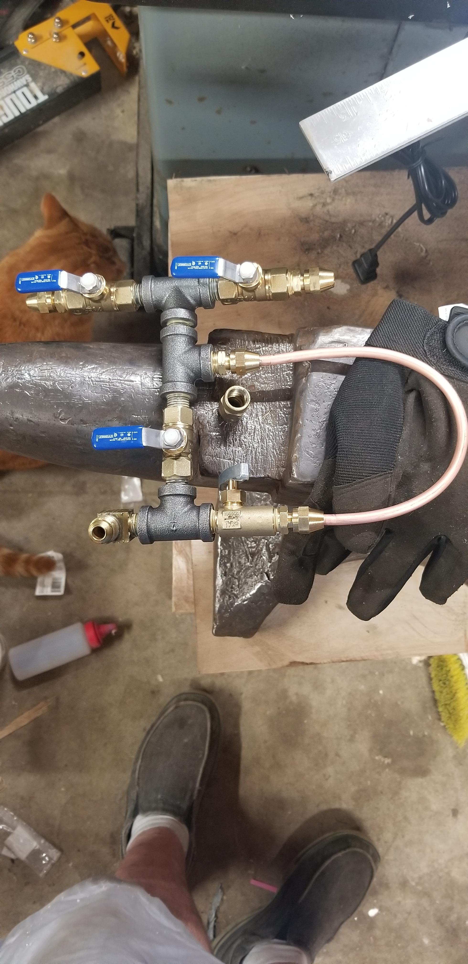

  4. Idle circuit. Hopefully fire burners tomorrow and finalize cure of kast o lite. I need to add a bracket to hold the burner controls. Is it ok to weld the shell of the forge with the kaowool? Or will I mess it up?
  5. DanR no worries! Mikey98118, I made a crude tapered form on a wood lathe. Glued it to a piece of pipe and covered in duct tape. Not sure yet of it was effective enough.
  6. Thanks DanR, The tubes are just forms for a small taper, i will recess the burners.
  7. A little bit of pull away from kast o lite/ kaowool. A few touch ups after this firms up. Hopefully I can fire this on sunday.

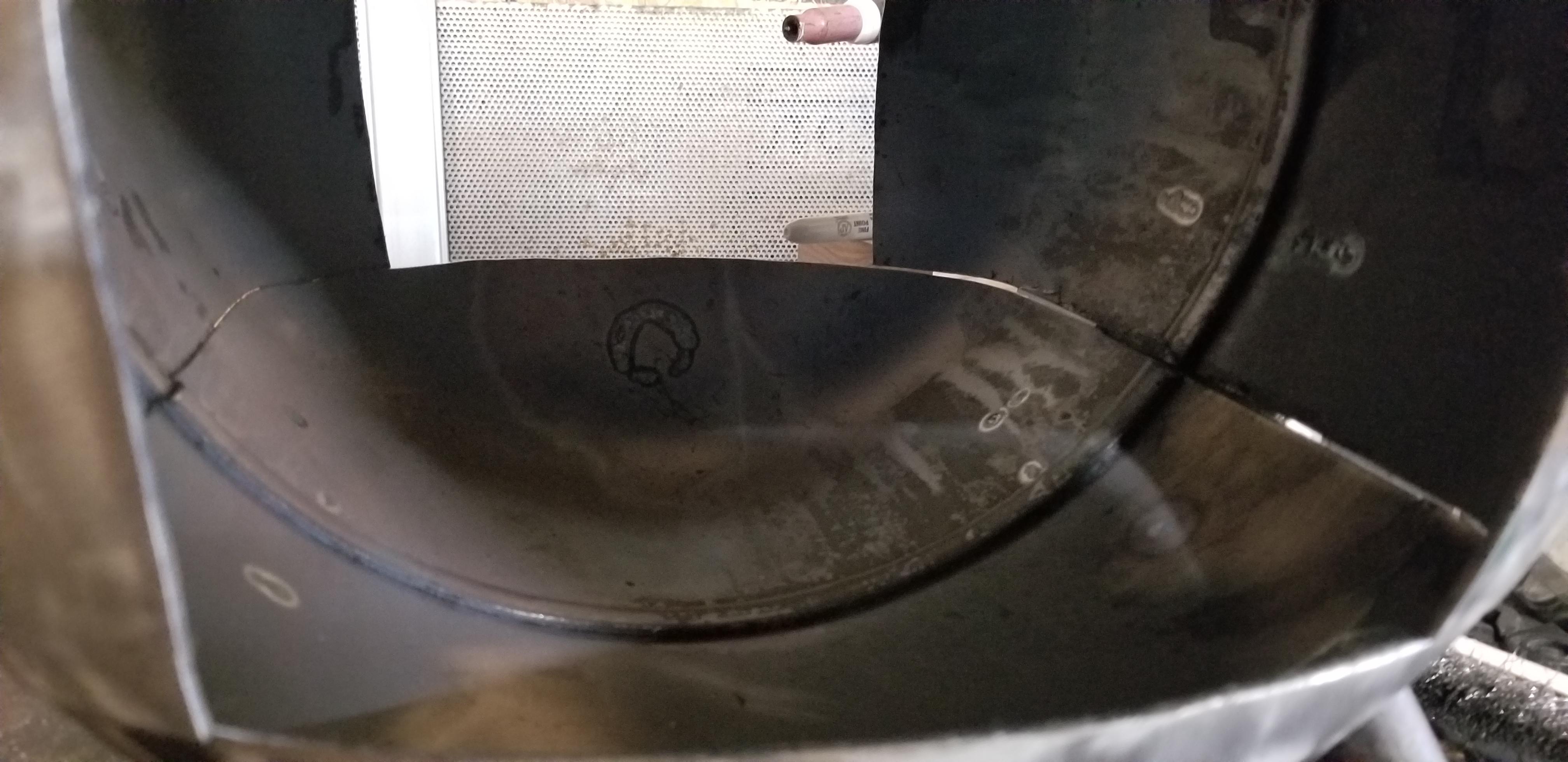

  8. I believe this will help. Can cover with one brick for adjustment.

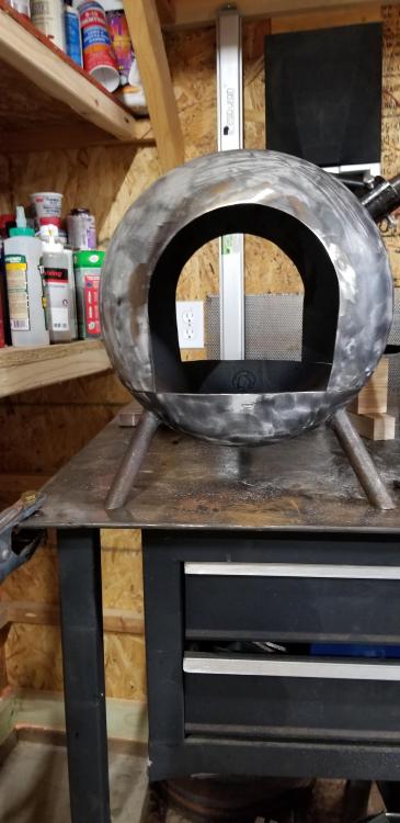

  9. It does seem large. I have the cut offs i can weld back in. I followed Wayne Coes plan. The opening i have both firebrick and some of the insulation board that i thought about putting kast o lite face. Decisions.
  10. OPStarted a 20 lb propane forge based on Wayne Coe's design with 2 3/4 inch Frosty T burners. Please let me know thoughts on burner location etc. Before I put in the ceramic wool and kast o lite. I plan on putting a shelf on front and back to hold fire bricks. Thanks! Shelf

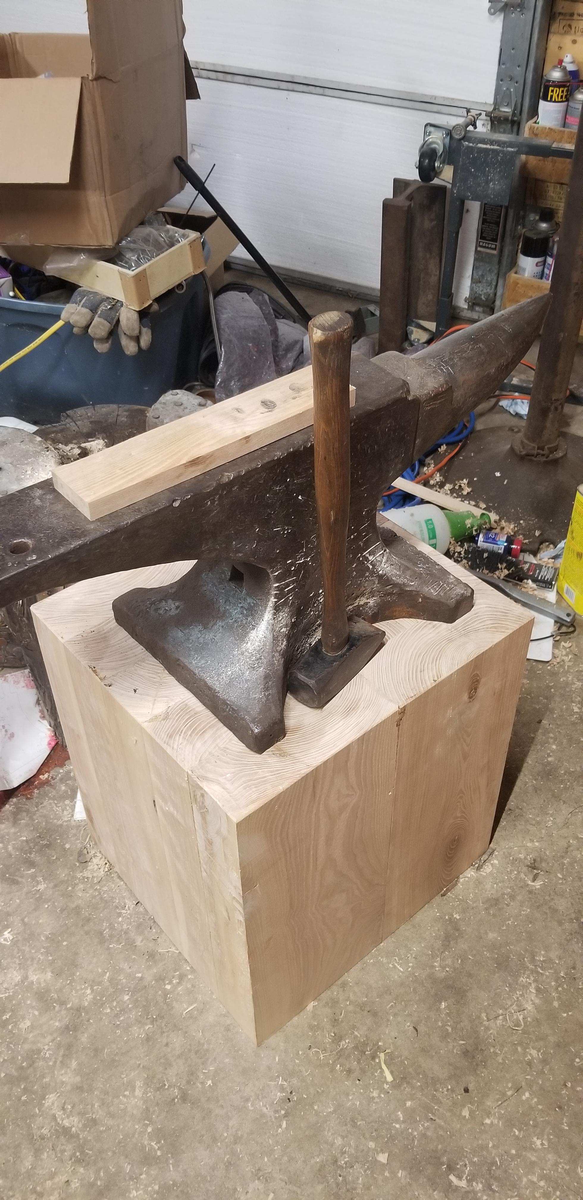

  11. I made a better stand, however I over did it. I had some 4×12 ash cants from my property drying for several years. Now to figure out how to take about for inches off the sides.

  13. Hey Im happy I got a deal for once. Guy even gave me a couple hardie tool, hammer and tongs. Now I just need to get me a forge built. The rosebud needs to retire.
  14. Amish gentleman wants 900 dollars. I figured it was worth it. The one i got is about 175# for 1/3 the price. It would still look cool in my shop. If only I knew what i was doing!
