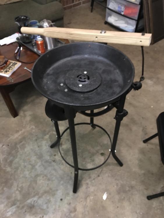

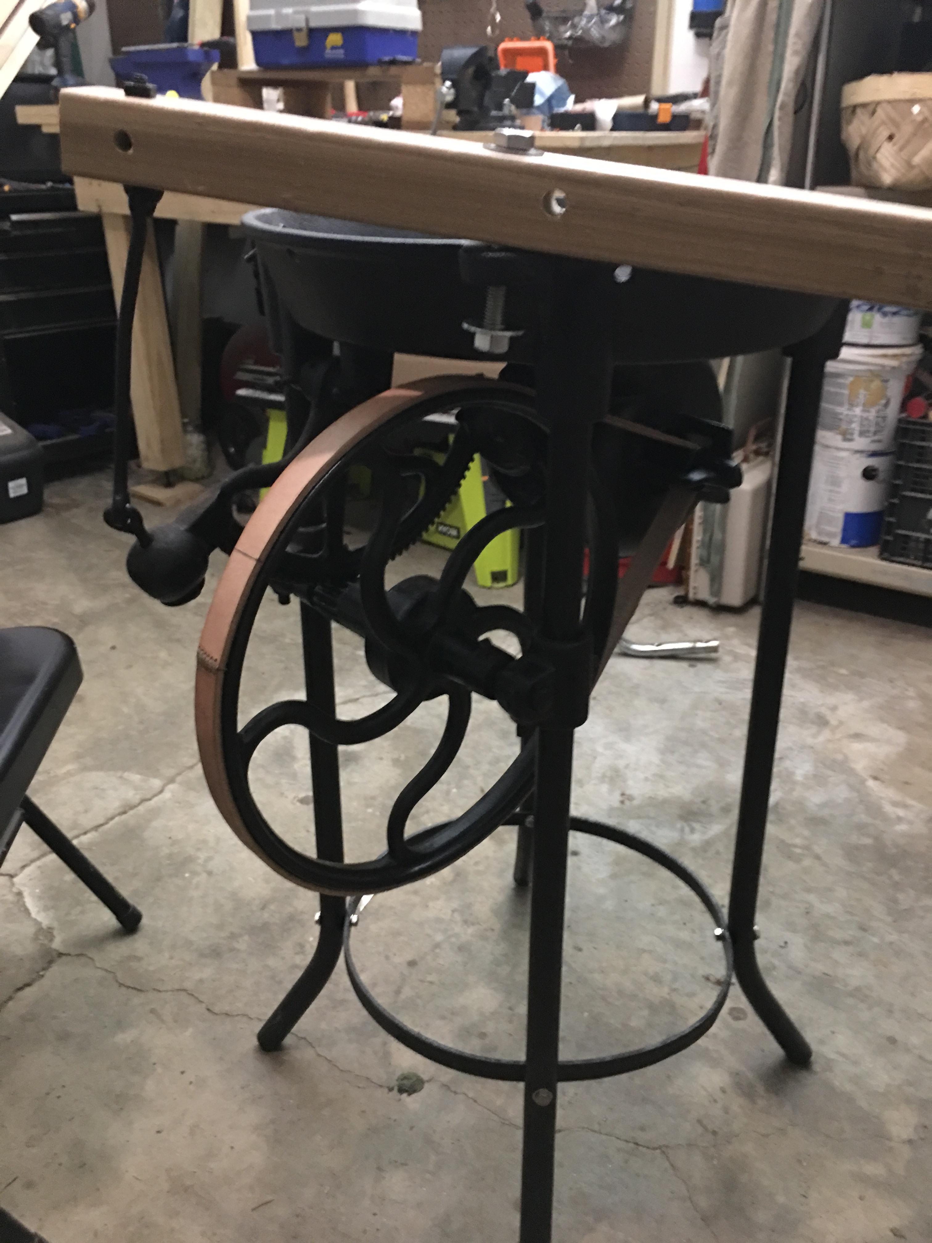

  4. - Your glasses are fine. Lol. I’d seen those in pics of similar forges, and was planning to rig one up for mine. What I’ve got now is already denting my new handle. - It’s the same length and hole positions as the one I got it with, but that could’ve been a replacement handle already, and been shorter. - Thanks for the tip! I just got some refractory in a couple days ago. I’ll slather some on there. Steve - the fan still had one blade attached, and it’s cast iron, almost the same thickness as the stock I used to make the new blades. Ideally, in the near future, I can cast an entirely new fan, but we’ll see how that goes.
  5. I used bar and chain oil. Got everything turning, but my homemade blades were wonky, and catching on the edge of the blower housing. Got ‘em ground down and straightened, and they’re setting for the next 24hr to let the adhesive cure. Barring any other oversights on my part, I think I’m good! Fingers crossed, I should be up n running tomorrow night! Tuesday at the latest. - Kagé
  6. After much searching around, I realized I never lubed anything after I put it back together. Rookie mistake.... Now the handle, 1/4 gear, and drive wheel turn, but the belt just slides over the small wheel with the fan. *sigh*
  7. It does. 1/4 wheel ratchets the drive wheel. And thx for the welcome. I’m excited to get started!
