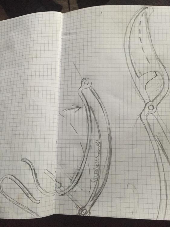

  3. Just a Pennsylvania warehouse worker here trying to learn smithing. I've been forging for a while now but only recently acquired my own equipment. I love to see what I can repurpose old tools into, whether it be something useful or just for S n Gs. As for the nonsensical screen name? A Roman comedy character; useless college latin classes leave a lasting impression, and are great for filling a language core. Ego quod ego.
