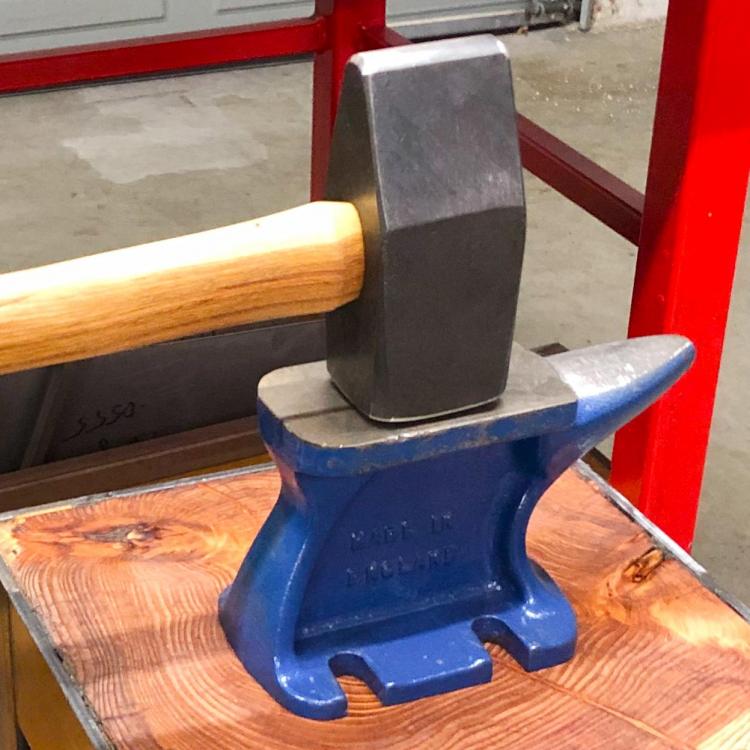

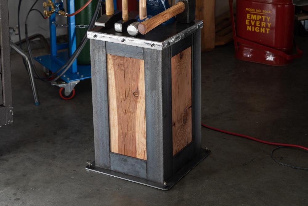

  2. My idea is a steel frame, 1/4 inch thick material, welded together with a base. Capped with a removable 1/4 inch plate/box, the anvil "footprint" cut-out in the plate should captivate the anvil. The anvil will contact the wood, with hold-downs threaded into the cap plate. The hold-downs should pull the anvil into the wood and steel frame.
  3. Might not be hard enough for horseshoe nails - it's not great in the rebound department :). And then with a smaller hammer - I could use the straight pein for the anvil?
  4. I'm trying to find a larger anvil :). Maybe just go with a new small/mid size Ridgid Peddinghaus - tired of looking.
  5. Thanks Chris - I'll probably add/weld 2 backing nuts under the 1/4 inch cap plate once the anvil footprint is cut out and the hold-down locations are established. Those nuts will have counter bored clearance in the wood. Also maybe a thin piece of sound proofing material between the anvil and wood.
