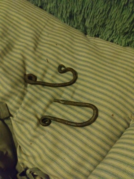

  17. Scotty30815 posted a topic in Tongs
    Well working on my first set on tongs. What style donno just yet. But here is the first half of them.

  21. Well day 3 of practice...got more done...stopped trying to pound the bejesus out of the metal...my arm isnt so rubbery tonight..used coal instead of charcoal...a little goes a LONG way...reworked yesterday's striker...and made a 2nd...can see a stress crack going all the way up the striker. Also made my first hook...ill post pic of the hook tomorrow...got it sitting on top of the hot coals trying to soften it a bit...the boss man is going to attempt tapping a screw out of it.
  22. Next stupid question...lets call em stress cracks...can those be reworked and essentially fixed somehow?
  23. As i will be getting this specific spring frequently...suppose ill figure it out. Cant beat 50 cents for 5ft of rod
