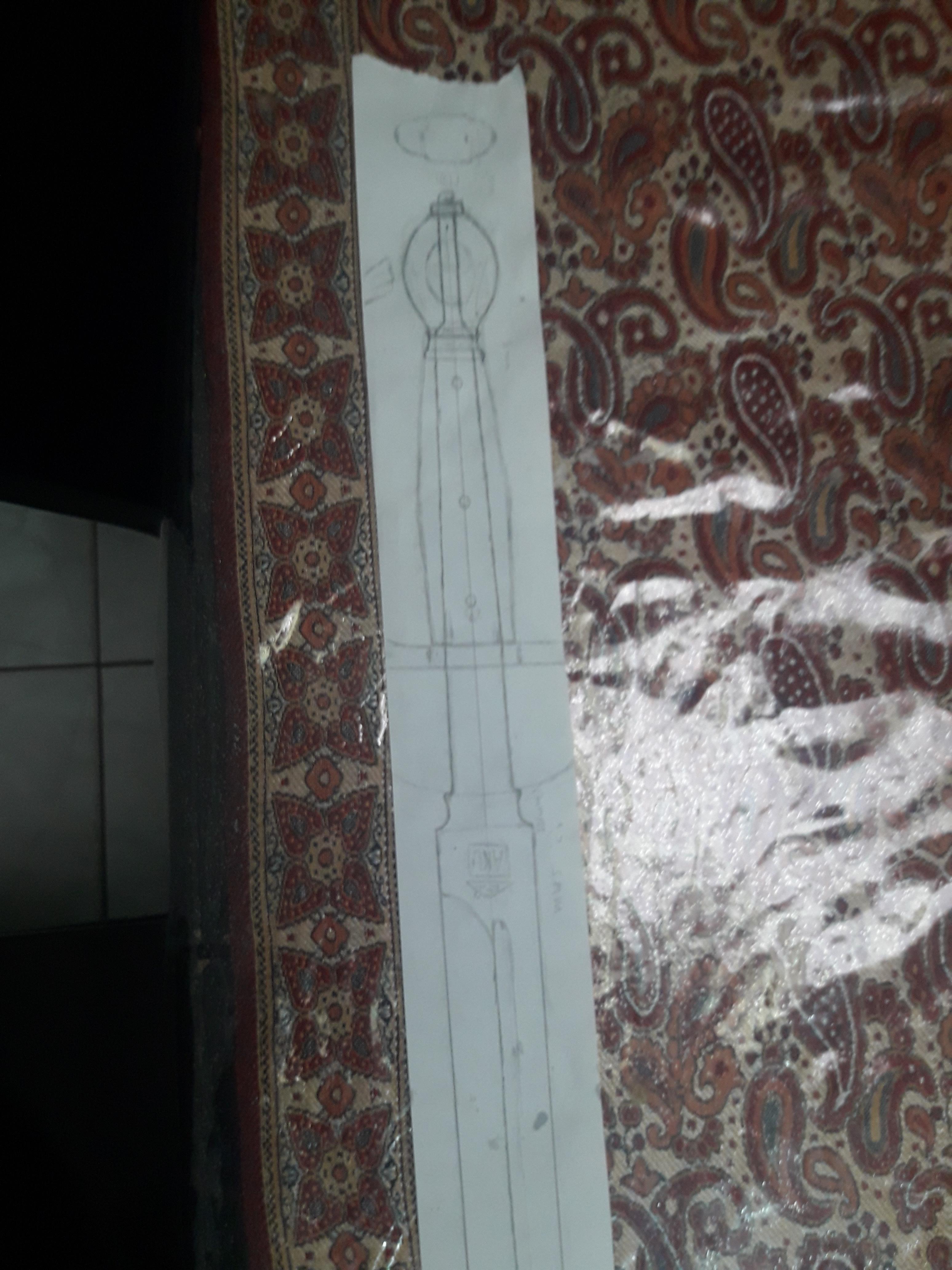

  3. Harmonics are my main concern; I'm sure they won't be as good as they can, and I find it hard looking for tips on them. I'll generally try my best with tapers and weight distribution and hope the harmonics will come with it. Grips are my stronger side, wire wrap might be harder than it seems. In regards to the design I'm thinking about switching to a sidesword, might be easier. Not fatigued, it was kept as replacement and didn't see much action, only collected some rust. I'll still buy new stock if I find good ones, but overboard is a lot of shipping costs and over here it's nonexistant/comes in tonnes. I'll probably search for someone with an electric kiln big enough because I doubt my abillity to get even, good heat. I probably have the connections needed for this and will beat this obstacle once I'm there. A good kiln solves all the problems. Once I'm done I'll try a safe flex test to make sure it won't break when it's not in a controlled environment, and of course never fling the thing violently at hard objects, especially when said friends are within launch range.

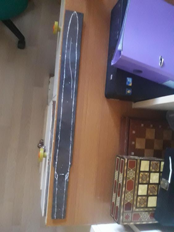

  11. Hey, me again! Not much progress with the sword, as to be expected. I'm still setting up the new place, I will hopefully make a killer forge in a week, and then some tools to pile up. This is the problem: I want to make a sword with a base thickness of 5-7mm, base width of 2.5-3 centimeters and length of at least one meter, and a lot of extra material to grind because I don't trust myself enough with making clean forging work in there. I've got a 5mm thick 6cm wide 70cm long piece of spring steel. to get both higher thickness, length and take advantage of the axcess width I want to upset as much of it as I can. My question is: What is the width to thickness ratio at which the leaf will no longer upset but just mushroom or crumble? or more simple to me: the maximum width at which you can still upset a 5mm thick bar? I'm no expert in this and I don't want to fight metal for too many hours, so this needs to be a reasonable width as well, I will square the bar beforehand with a disc, but I'll also cut the final working bar out then and for that I need the width. I changed my mind and the bar will not be sword shaped as in the picture but just rectangle. I'd also welcome some general upsetting tips And a quick question: How'd you recommend for me to show the advancements in the sword project here?

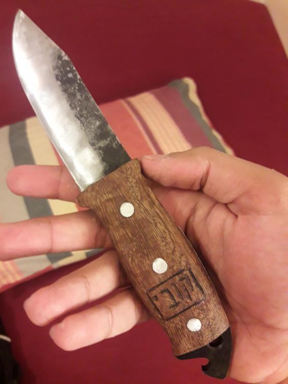

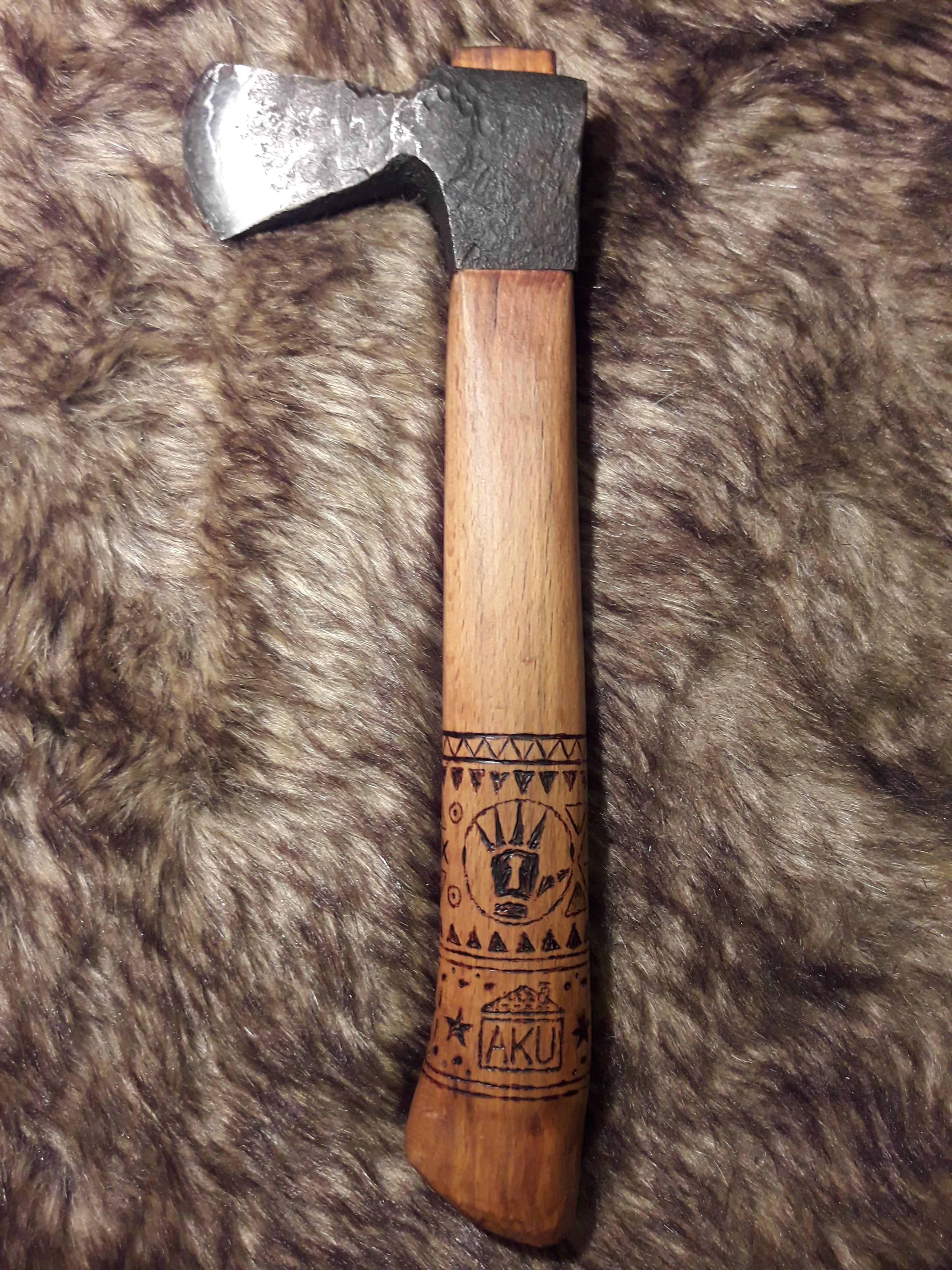

  20. (I hope I'm quoting okay^) I'm not here to fight either, but I can't have productive discussion when you presume I don't know anything about forging and get this "Don't feel lonely though, you aren't the first teenager to want to jump into blacksmithing by making swords. We hear it all the time" disregard. I get that you are probably approached everyday by people who didn't use a screwdriver their entire life and want to make a greatsword/katana from rebar they found in their backyard, but please be patient with me, I know what I'm doing (hopefully) I know my limits, and I know the proccess of making a sword. My plan is simple and up to my limits- a short not-sure-you'll-agree-it's-a-Rapier-at-all-sword, wide and with only a true edge, which will be made with 60% stock removal. I've already drawn it and done most of the planning and dimentions (I actually came here to ask about upsetting for the sword because I want to get it to 7mm in the base instead of the 5 of the leaf spring but the width-thickness ratio is borderline too much for that not to just fold/ shroom). I've made stuff before, I already talked about it so just have the images (I'm a very artistic person who shouldn't use fake fur). You can judge however you like based on that, the smaller knife was made from THAT spring... × I could use more practice before making a sword, and will probably get it before I get access to the tools. Engineering and blacksmithing have major differences, if you haven't ever laid a hammer on hot steel then a sword really is not gonna come easy, but not attempting isn't the way. The first year and a half of my forging was soft ugly props for costumes, I came here by doing things out of my skillset until I got the skillset. I made a xxxx "Katana" two years ago- soft crude fat construction steel atrocity with no real handle. Did it kill me? No. Go make a sword, mess it up, who cares. You'll live on, and then you'll make better swords. My first forge was mud and bike pump, my current one is grill and vaccuum cleaner, but I need to quench the sword somehow when it's all hot, and generally have a forge that doesn't melt my steel in its whims (it ate an entire knife). And that grinder is better off in the trash, it's already almost done for (but xxxx, it did cost only 20$).

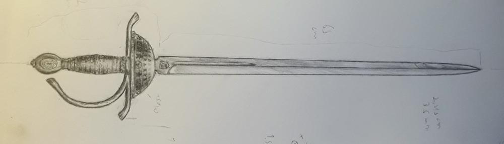

  22. Why so hostile? I don't have a space where I can both keep the tools and work, I spend hours moving them, modifying them, buying them, working in different locations and just wasting time because the tools are too slow/not made for the task. I've made multiple knives, some fully forged, all of them hardened, some axes, a hammer, a shield boss, an arrow head, and a bunch of other stuff. I've been forging from time to time for more than three years. I want to make a sword and I probably can (with the right tools).
