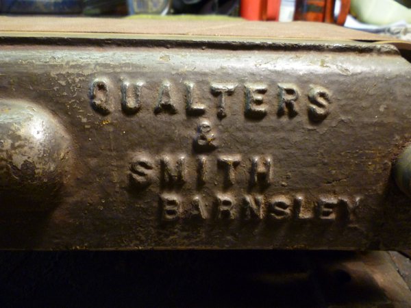

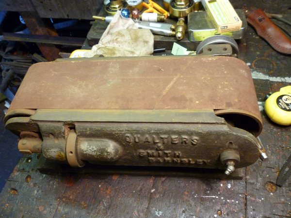

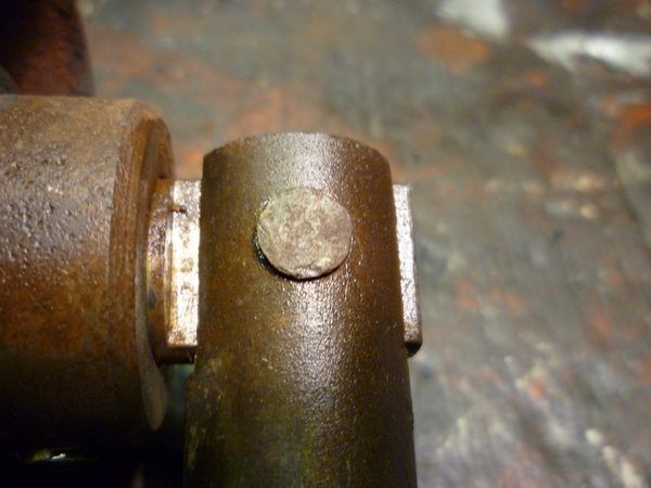

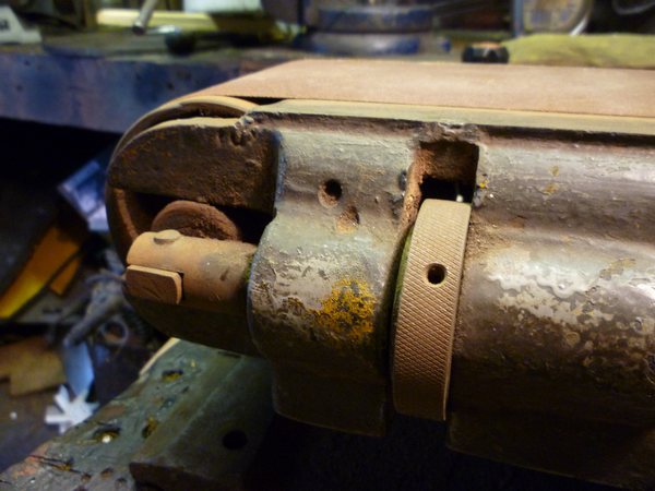

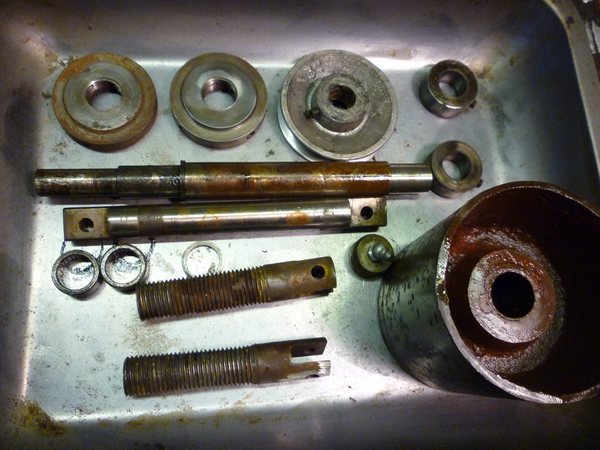

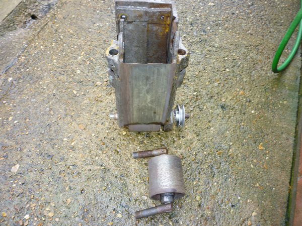

  1. Right.............since my absence from this forum ...i have been busy...i have found an old pre-war flatbed Linisher machine made by Qualters & Smith of Barnsley..(trust me you dont want to go there)...and i am re-building and modifying it....putting new roller bearings in it and have designed a raised steel (milled) plate to be screwed to the flat bed to allow a precise plunge cut/line.......... what i have also been doing is "wading" thro' the multitude of different ways to harden and temper 01 tool steel..........and they all seem to contridict each other..regards number of times to do the process and the time taken between each process look im a poor simple English fellow and i need something simple to follow... i do not have pyrometers or gas forge...i use my eye for colour and magnet for hardening...the stock is already in an annealed state.... These are my thoughts harden first...(magnet...then into warmed / heated cooking oil point first and straight up and down... clean into forge onto plate and watch the colours to "light straw at 229deg's C quickly remove and into shallow bath of warmed oil cooling bottom third of blade...cutting edge and some ..leaving upper and full tang to cool naturally .... Question... am i on the right track.... what will happen to the air cooled part of the blade and tang will there be a problem where the 2 heats zones meet (the interface)..... im looking to get a hard but not stupid hard culling edge with a softer spine and tang............. what do you rekon Steve................would be interested in your procedure............
