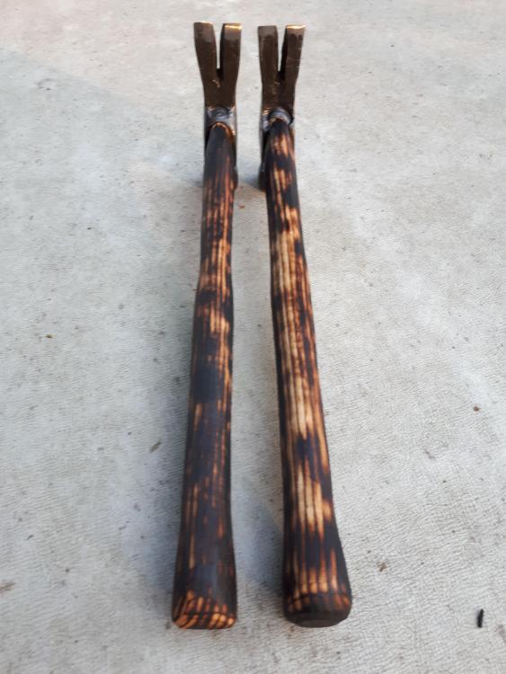

  2. I've considered framing hatchets. I've only made one attempt at making one so far. I still need practice making them. I've been practicing a lot more with the hammers. Do you think there would be a market for handforged framing hatchets?
  3. I've done a light char on ash sometimes as well. I like how the ash grain really pops out when you do that. So far what I've been doing is giving the handles a few coats of boiled linseed oil. I generally haven't buffed them, but I do tend to give them a good rub with a shop towel or something. What are your suggestions as far as steel? Is 1045 a good choice for framing hammers. I like it because its fairly simple to heat treat with a coal forge, nothing to fancy about it.
  4. Thanks for the feedback!
  5. Interesting. I think what I should do is let a carpenter use some of the hammers I've made, and get him to test them on a real job site. I'd like to make them to sell, but I do want them to be worth buying. I appreciate your opinion, thankyou.
  6. I haven't done any real tough tests. The tempering colour obviously depends on the kind of steel as well. I figure for 1045, being a medium carbon steel you wouldn't want to temper it to soft. Just get the brittleness out of the eye and the areas next to it. But I'd definitely rather have the claws bend than have them snap. Good point! Personal preference I guess... I hadn't really thought of it before. I guess they are a little blotchy.
  7. Thanks for the feedback. I'm happy to get feedback from carpenters!! I see what you mean about the slot for the nails. I'll try to fix that in the future. I used 1045 steel. So I quenched in water and then stuck a heated drift through the eye of the hammer to do the tempering.
  8. Hey can I get some feedback on these framing hammers? I've been experimenting quite a bit and would like some constructive criticism.
