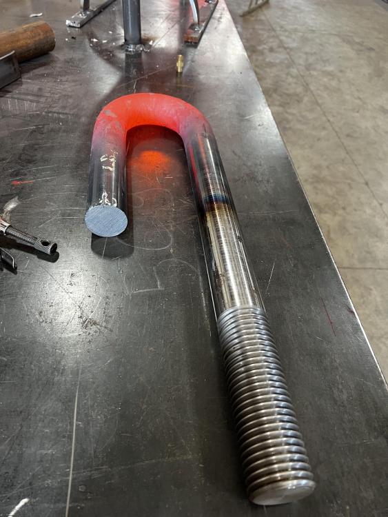

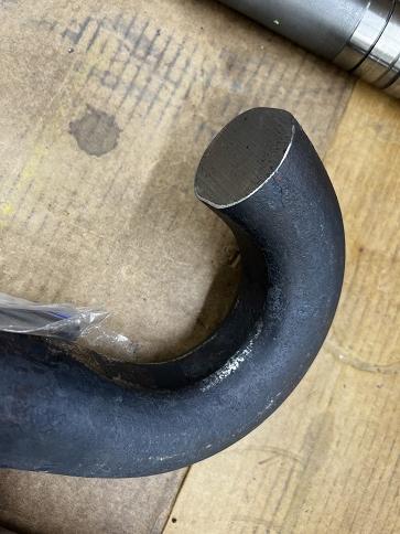

  6. Success! This forum has been an amazing resource. I'm just beginning my blacksmithing journey and this is the first time I really brought my forge up to temperature. Two guys on a cheater bar and wrapped around with minimal effort. The only issue we have is the radius came out about an 1/8th in larger than what we wanted. We have five more to do and are planning to make the pin smaller to help tighten it up.
  7. Current plan is take a welding table outside and anchor bolt it to the ground. We will then weld the fixture to the table. We are going to place another pin on a fork truck and use that to move the bar around. We have a skid steer and larger flat bed trucks as well. We were actually worried about the bar sagging once we place it in the fixture. Doesn't sound like that needs to be a major concern.

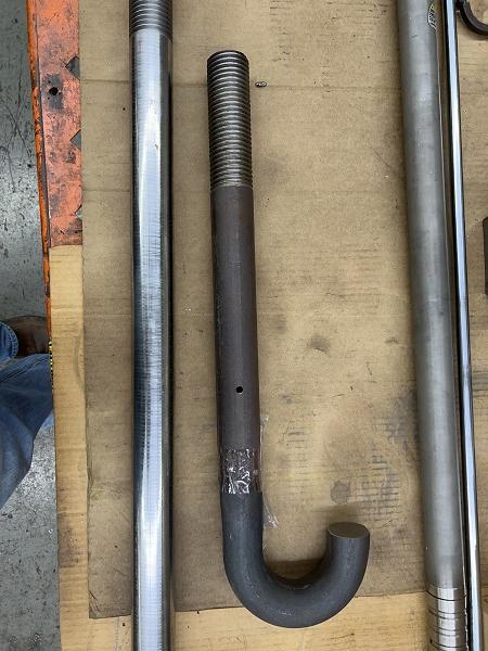

  8. Twistedwillow - These are not load bearing. They hold down a lid for a large melting vessel. The head of the J bolt rides on a bar as a pivot point for a lid as a pair. David - We are making a total of 6. Going to try the first one and see if lengths are good. The drawing the customer provided is so old we can make out the dimensions of the mating piece. I would think the main concern is making sure we have the 180 degree bend. We can always throw it in the mill and clean the inside radius if need.
  9. I was hoping to get some safety advice for a project. Being a small machine shop, we usually try to avoid heating up work pieces. We signed up for a job to make some large J-Bolts. We have turned the threads and are ready to attempt the bend. The bar is 4340 annealed 2" DIA and the radius on the bend is 1 -9/16". Length is approximately 40in. Any advice, cautions, or recommendations would be greatly appreciated. My main concern is safety. We are going to practice moving from the forge to the fixture cold before going hot, but I have no idea how a diameter this large is going to behave. My other concern is providing enough heat. We are using my home built forge. I am still in the learning process of getting to tuned properly but I can get metal to a bright orange. The picture below show the sample bolt we received and the machined bar for our first attempt. Thank you for your time, Don
