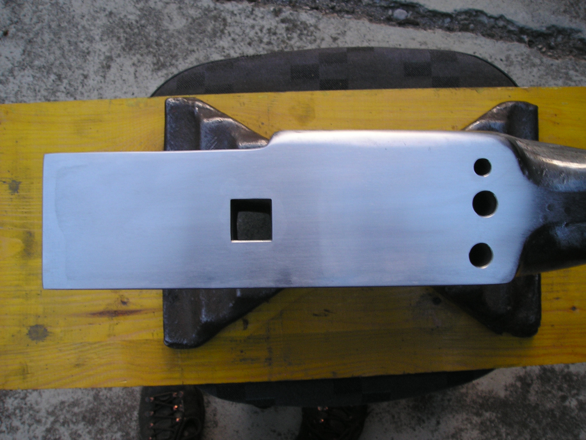

hi Marc! Those holes are blind. Its an oval shape between the holes that is hardened. Before the grinding it was just a as somewhat bigger oval but there are traces of it extending beyond the holes, that is why I suspect the anvil had been reground at least one time before. And also the ones I have seen that were in mint condition had an 90% rebound all ove the face. Like I said already in my first post I knew it was a functional anvil as it was and it still is, but that is not what I am after. I know I am weird been told so ever since I was a small child, never followed the crowd, its not even a choice. Cheers! -

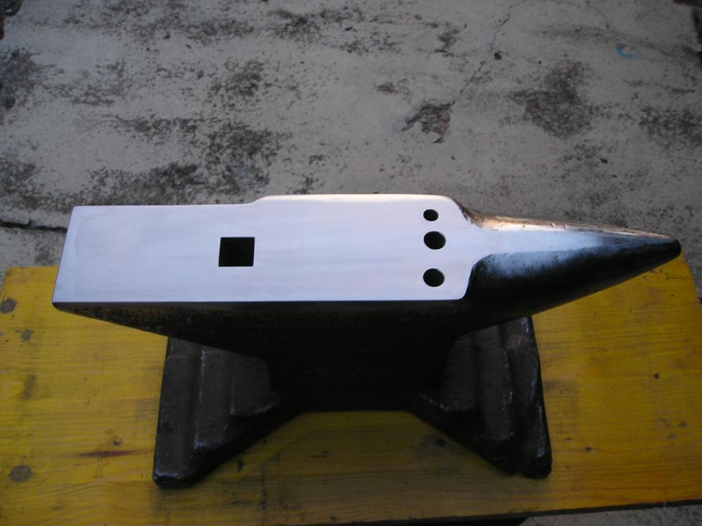

I believe those are called Pritchel holes Not sure about the spelling, English isn't my first language. I don't know why there are three, I was meaning to ask the question my self. their diameters are 10mm 14mm and 17mm roughly, those aren't perfect holes. I have an idea about hardening the face of the anvil which I intend to share here to get some feed back from you guys. if nothing else I expect it to be fun. As far as the hardened material goes you can clearly see it as darker portions on the face. If I drop the ball bearing on those parts it rebounds roughly 95% and around 60% on the softer surface which si basically everything south of the hardy hole, in short only the middle part between hardy any pritchel holes is still hard. and also the welded areas are now hard. I didn't wory about welding those small parts with a soft metal tig wire because I know from experience that carbon will migrate during welding and the welds will be hardened to a degree. But the hardness is not great I estimate it being around 50 hrc, with some effort you can file it, that's how I finished the hardy after welding.Cheers! -

Hello. So here Is a picture of what is missing from the horn of my anvil and this is roughly what I would like to weld on and then reshape in to an almost needle sharp end, I wouldn't want to prick myself, so I will round the point a bit. Of course I will be welding all the little dings and cuts in the horn as well. And then I intend to grind the horn smooth as I possibly can. I'm doing this regardless of any ones opinion, but that is not to say I do not value others opinions, I do, any kind, I learn from it. But I would very glad if someone could share their experience of welding cast steel (possibly anvil) with stick. Thanks. I will be posting more pictures of the anvil as it is now and as it was before also. Cheers! -

Hello. I am new to this community as well as to blacksmithing. This is my first post as I would need some advice from you guys. So after a long search I purchased a used 50kg (110 lbs) Austrian style anvil. The price was relatively cheap and the anvil wasn't in a horrible shape. I believe it is a cast steel anvil, it has a beautiful ring to it and the rebound is also excellent ( over 90%; tested with a ball bearing). The face is hardened but its not extremely hard. A file cuts it. The anvil had a lot of dings and cuts also the edges were slightly mushroomed, the very tip of the horn is also missing ( 20mm or so; less than an inch). With that said I am sure the anvil was perfectly usable as it was, but... I wanted, what any real man wants, to be able to forge an axe on the anvil and then shave my face with it while monitoring the procedure in the anvils mirror like surface. Kidding obviously, but I do want my anvil to have a nice flat and smooth face with crisp edges. I achieved that already by grinding off around 2-3mm of the original surface which left me with a few imperfections in the form of low spots around the hardy hole and on the edges. To take those out I would have to grind the surface down another 2mm. So I decided to just weld those areas. I welded it with tig adding vac60 1mm filler metal (ordinary mag wire that I get for free). The welding went smooth with no issues whatsoever. I didn't preheat since it was really only minor welding. And I did the welding hot and fast with lay wire technique so as to minimize the heat input. Then I ground the welds flush with the surface. The next thing I want to do now is to rebuild (and reshape) the tip of the horn and this is where I would need your advice, since filler material choice is more critical here than in the minor welding I did on the face. Its less then an inch (20mm) in length but considering the volume its a bit to much for tig welding. So I would like to use stick but cannot decide on the appropriate electrode. The selection of electrodes is mind boggling. I am leaning towards the type of electrode that is used for railroads, hammers, crushers, etc. designed to withstand severe impact and pressure, it also work hardens. It is a manganese chromium alloy electrode ( E Mn14Cr4) that is supposed to work on manganese and carbon steels. Would this be a good choice in your opinion? What do you recommend? What ever I will end up using I will test it first on the corner of one of the anvils legs which is a bit mangled and needs some purely cosmetic work. The issue here is also that I do not know the type of steel the anvil is made of. I am certain that it is cast steel though and not cast iron. Like I said, with tig and on a ground clean surface it welds with no problems. No porosity, no cracking. But I was welding only very small portions, volume vise much less than a cubic cm. The sparks the Anvil throws when grinding with a flap disc are very similar (dare I say identical) to the sparks from a piece of railroad track I have, and that is suppose to be manganese steel. For welding up the horn I intend to do the preheat and all. But like I said I am unsure of the electrode that would be best suited for the job. Your thoughts, opinions, suggestions... are very appreciated. Since I have put a lot of work already into this anvil and I am very pleased with the results so far I would really hate to xxxx it up now. Although I realize many would consider the work I have done to the anvil redundant and even damaging (it was perfectly useable as it was), since I ground of most of the hardened surface, yikes. But I enjoy restoring things to the very best of my abilities and gaining new knowledge and skills as I go along. So for now this restoration is my main goal with actual blacksmithing somewhere in the distant future, since I have a lot to do prior to hammering red hot steel, like building a gas furnace and stuff. With that said, for the final step I also intend to heat treat and reharden the anvil surface and I will be asking for your advice on that topic as well, but that's for another day. Thank you for now and cheers!
