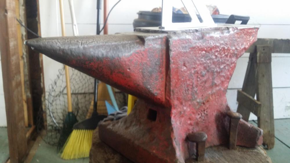

  3. Njanvil, is there any way to tell if it was made in Maine? The guy I got it from believed it was made before the move to NJ. Thanks for reassuring me about the dull tone! I was also told the cutting face and horn were covered in harder steel, and there are seams that support this idea. You said work with what I have, so I'm assuming the cuts and dings on the cutting face and horn are no concern either? I prefer old things with character, so grinding just to make it pretty isn't something I want to do either. Oh! One last thing I've been pondering, the mounting of this sexy beast. I'm going with wood, but my question is do soft woods absorb my hammer strikes more than hard? Am I losing anything using soft wood? I've got some pretty big pine trees, but my land is scarce in larger hard wood. Should I wait for the wood to dry, or mount it wet? Was figuring the wet wood will really lock in whatever I use for fasteners, but was also thinking it may warp slightly when it dries which could ruin the flat and level fit.
  4. So, from what I've read, it seems repairing an anvil is a last resort. I bartered for an anvil yesterday, not sure of the manufacturer, but the guy I got it from seemed to believe it was made here in Maine. The ONLY letter on it that I can make out is an "A" on the rear left foot. My real question is, is the damage on the left side of the working face something I should consider repairing? I think it shows evidence of prior poor repair attempt(s). It also has very little ring when struck, which, led me to believe someone already ruined the heat treating. If that's the case, can I reheat it and heat treat it again? Lastly, I HATE that it's painted red. Is there any paint removers I should avoid? I've also been cleaning it with Zippo fluid, and it occurred to me that I should ask here before continuing to clean with it. I figured the oily residue it leaves behind would help prevent rust. I've taken some pictures, let me know if anyone needs something else for IDing the maker, or damage assessment. Much thanks to all!
