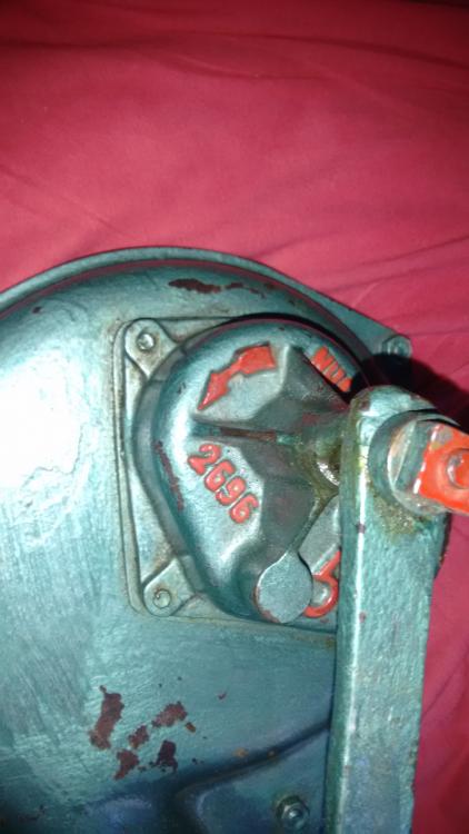

  3. Picked up this hand crank blower. It's working really well, no broken parts or strangers sounds and it moves smoothly. Although I bought it here in Brazil, the ad said it was imported.
