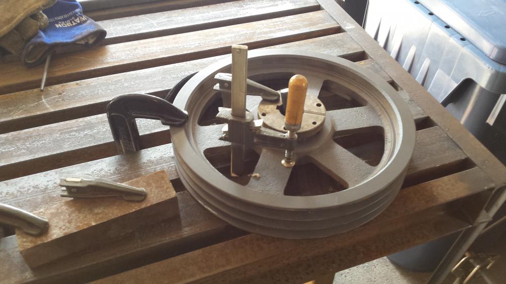

  6. Finished except for final welding and paint, and hinges, and install etc. The 5/8 bent fairly easily, only needed a cheater bar on the tighter bends near the ends. Jig did the job. Another question though.... the frame is cupping up towards the welds, will welding opposite sides reduce this? Sorry about the sideways pic, haven't figured that out yet. The pulley was actually going to the metal recycle, but I thought it might come in handy for just such an occasion, which it did.
  7. Went with the KISS principle. Kept it simple. Put my stock up against the block and bend around the form. Do a series of small bends for the more gradual curves. Working well so far.
  8. Like your bender Dodge! So you're just making a series of smaller bends to get the radius you want I assume?
  9. I was hoping someone would come up with some "I did that easily with.........." kind of story. Wishful thinking. I've never done something quite like this. I do have a small hydraulic ring roller I can try.
  10. I am building a gate for a friend similar to the picture. My round bar is 5/8". Can this be bent cold? Should I jig or just try free hand? Has anyone tried something like this before?
