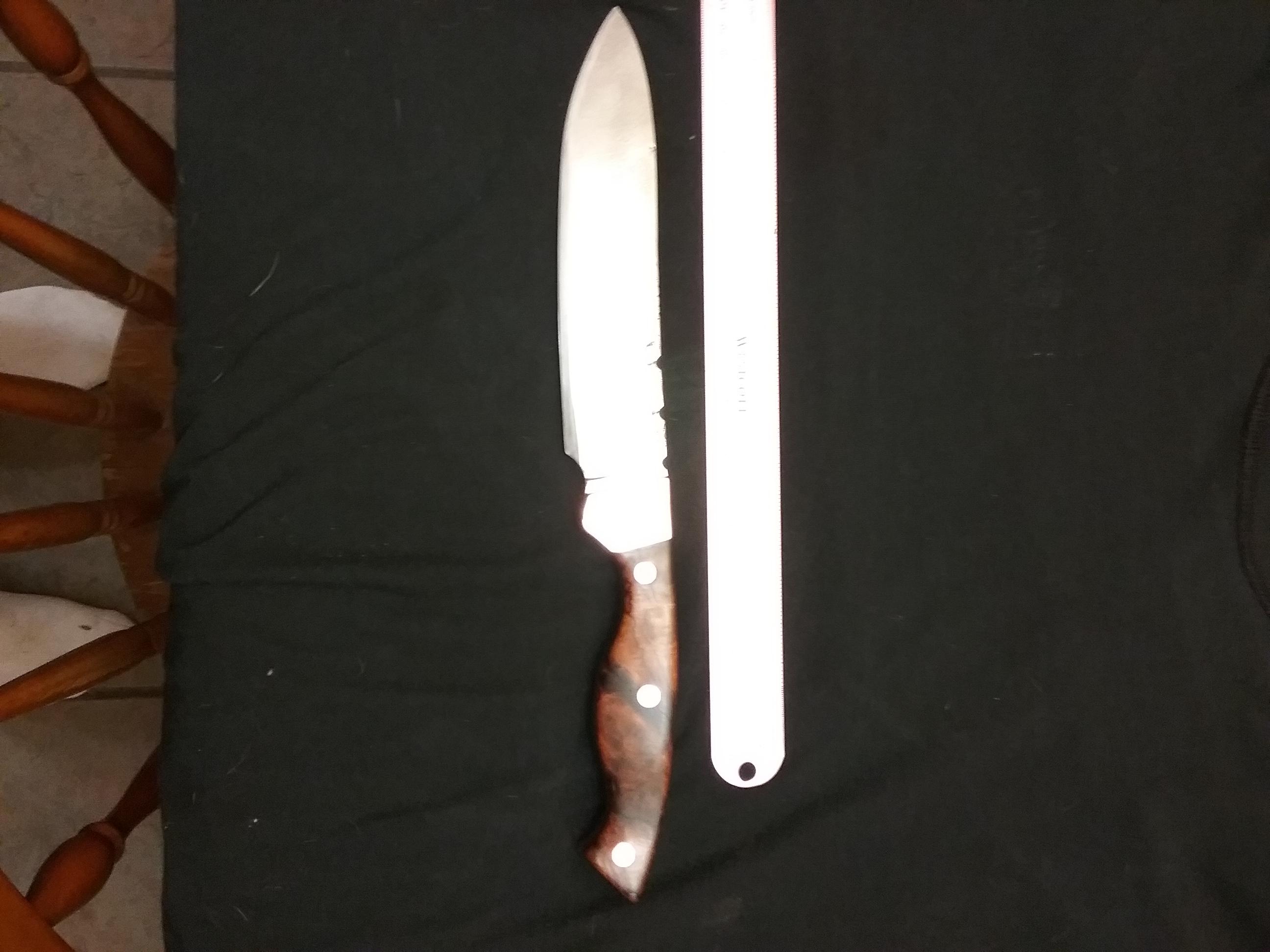

Good afternoon friends. Just finished this bad boy up, it was more or less a stock removed project. A friend of mine at work gave me 2 sets of leaf springso from a 60s model ford p/u. The bottom spring had the serial # and the fomoco emblems stamped into it so I thought I would save that into the blade. Basically I just heated and flattened it out and shaped it. Then used a hand grinder to put the bevels into it. Nickel silver bolsters and a red dyed burl wood scales. The fit and finish was where I ran into problems, the fit up was good but I'm still struggling with final finish. Overall I think it turned out to be a suitable trade/gift for the springs. What yall think.
Thanks guys Robakyo, that blade your referring to was made out of a mudflap hanger off a big truck, the handle was made out of some red cedar I had laying around, the bolsters were nickel silver with copper pins. It was heavy and felt solid in the hand. Just a cool scrap together knife.
