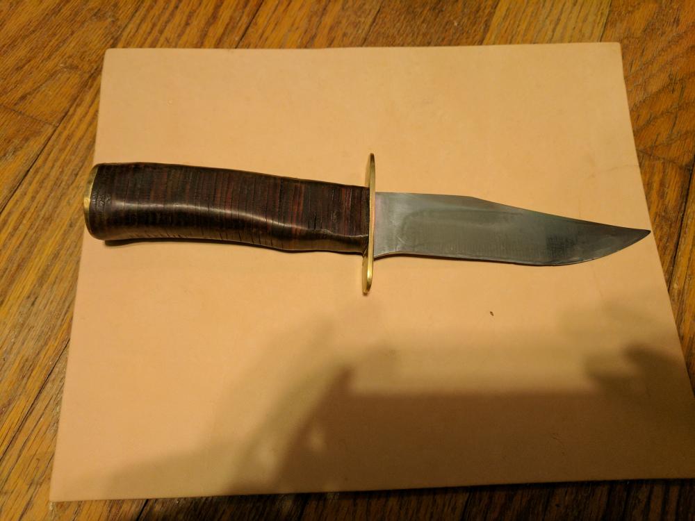

  3. This knife would be only my fourth attempt at making a knife! I have spent much time learning new tricks and methods since my last knifemaking adventure, and due to some recent inspiration, I had decided to make this knife: 1080 Steel, a stacked leather handle, hand-cut brass guard, and a brass butt-cap(attached by peening the tang). This time, to attach the guard, i soldered it on, so it would most certainly stay secure, and polished the blade to a mirror finish. Also, I finished, sanded, and waxed the leather handle to a moderate shine, and shaped it to be secure but comfortable in the hand. Leather is one hard material to shape from my experience. In addition, i differentially tempered it, and lightly etched it, but the hamon line is only very slightly visible due to the polishing process... my lesson learned with this knife however, was to let the refractory cement cure onto the knife where i want the hamon line, or else it may get scratched off by coal in the forge... What kind of feedback can you guys offer?

  5. I'm still pretty new to all of knifemaking in general so I really do appreciate all the advice. I will greatly consider polishing the surface after I solder the guard.
  6. This leather I have used for previous knife sheathes before, and is generally effective for preventing rust on knives. I find what helps is to put a small bit of oil in the sheath (not drench, just a little), and it also helps prevent moisture from entering the leather. Either way, I care for my knives as best I can, although I'm always open to new tips and tricks. Whatever helps is valuable. I just figured the forged finish would fit the theme of the knife, personally.

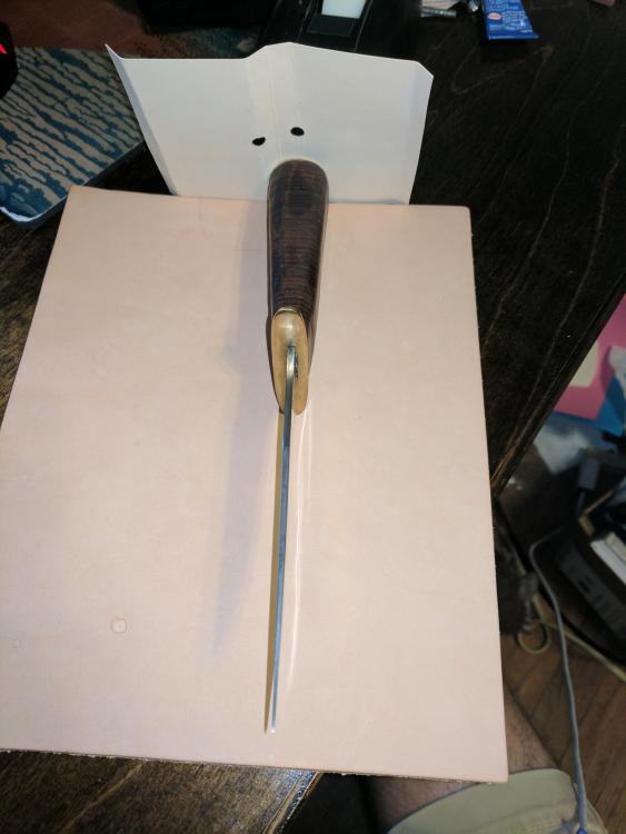

  7. the polished surface carries a good point. Thanks for the advice. I'll certain solder it when i get the chance. I figured the coating would prevent it from rusting long term. I thought maybe a polished surface would rust more rapidly, and lose aesthetic value once the tool goes through some use.
