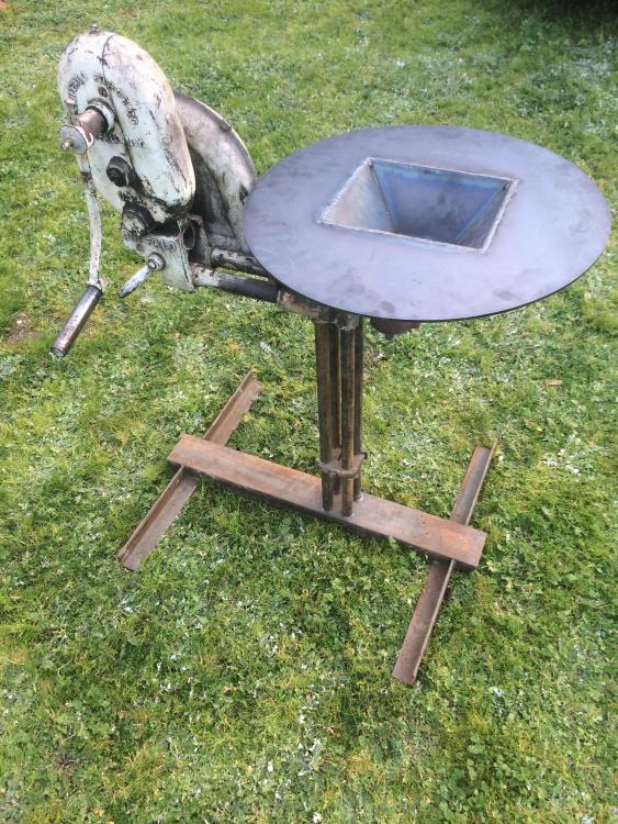

  8. Hey everyone, I'm a bit of a lurker here, having only posted once or twice before. I thought I should contribute to the content as I use the forum a lot for inspiration, ideas and information and find it extremely useful. This is my improved rivet forge. My blacksmith friend from up in the high country who I obtained the blower and stand from had already welded the feet on, which I think is a great, simple improvement on the original splayed feet. It's very sturdy. A friend and I spent the afternoon putting together the new fire pot and surface. The fire pot is 250mm x 200mm at the top, 100mm x 100mm at the bottom and is 125mm deep. The surface is 550mm in diameter. (10"x8" top, 4"x4" bottom, 5" deep, 21" dia) The construction is all 5mm thick mild steel with the exception of the 100 x 100 bottom plate which is 10mm. It is TIG welded together. The blower is a buffalo forge co. number 210. It may look a little rough but it runs beautifully. I'm not really interested in cleaning things up for aesthetic appeal, though I admire it when others do it well. I have quite a small shop in an old shed in the bush, so the rivet forge serves me well. I intend to put a lip around the edge in sections for banking fuel up against but decided I would use it for a while first and decide exactly where I want them to be as to not block the steel's path to lay flat. I want to feel it out a bit first. For the moment I use charcoal that I make from off cuts of Australian hardwoods. I'm happy with the way it turned out and the fire burns beautifully. Thanks for looking. I'm interested in hearing your feedback and suggestions. Cheers, TD.

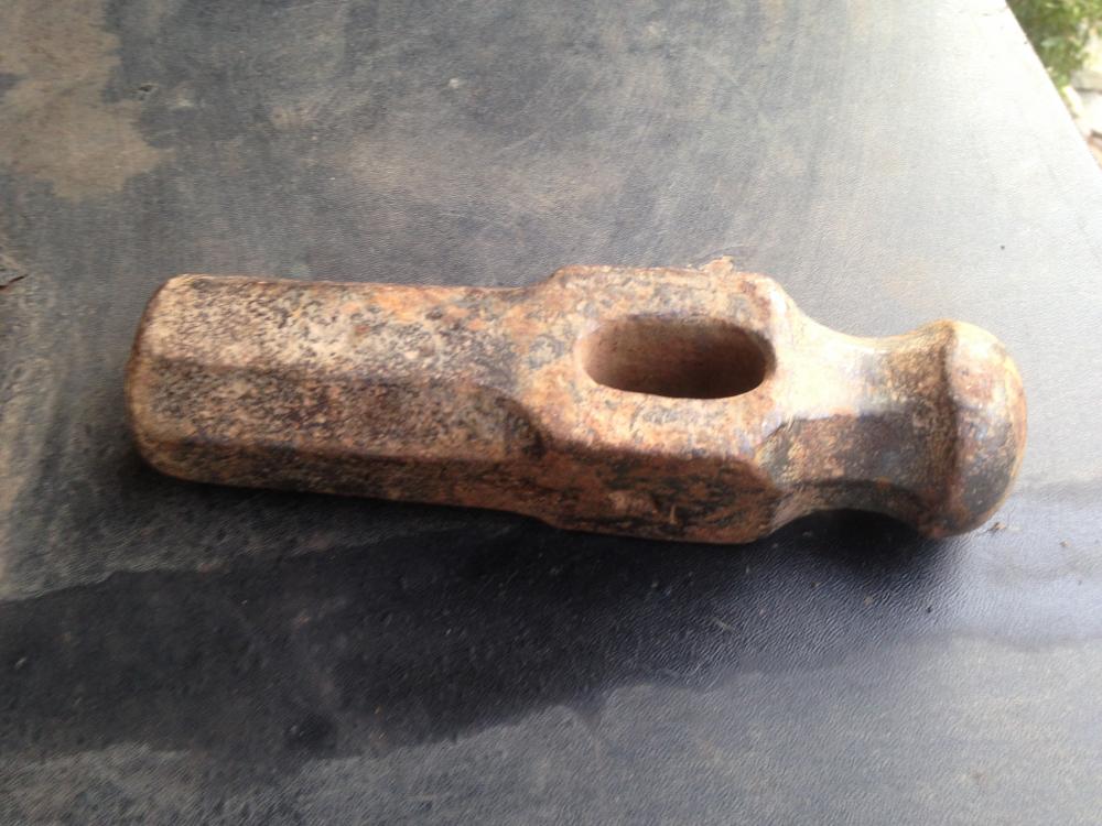

  10. Hello everyone, I often enjoy browsing this forum for tips, inspiration and to have a look at the gear people make and acquire, but this is my first time posting. I got an interesting hammer today from an old fella who lives down the road here in the central goldfields of Victoria, Australia. I would describe it as a forward weighted ball pein I suppose. It weighs roughly 2.8kg (6 pounds) and measures 200mm (8") in length and 50mm (2") across the face. There appears to have been a makers mark at some stage that has since worn away. I just wondered if anyone has come across one like it before. The second image is where I believe a makers mark once was. I should have placed something in the photos for scale as it is much bigger than it appears there. Thanks, T
