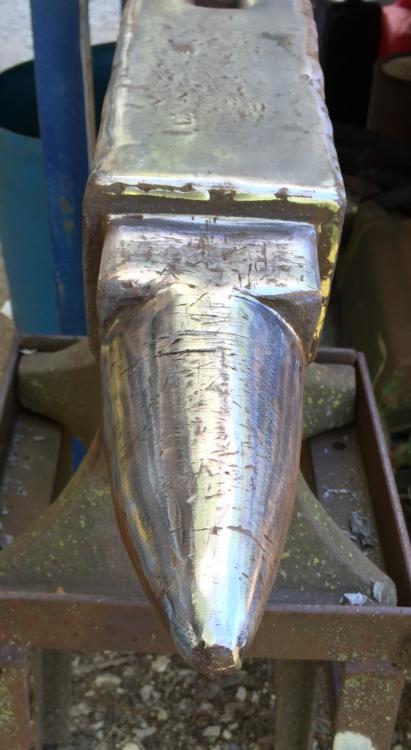

  10. Quick update: Welding went well, put 2 layers down, and machined of about half of it, that was the plan. That is the as milled finish, I used a Sandvik Coromill 245 with a fresh set of corners for the finish pass. I was getting 55-60 Rc on surface before welding and now have 50-55 Rc on the face. I am happy with that. I knew I would loose some hardness. I lost less than I was expecting to loose. Still have a lot of finish grinding to get the edges radiused proper and a little die grinding on the hardie hole. I was going to put a 1/4" radius about 4" long behind the table and a 1/8" radius around the rest of the face of the anvil, and clean up the table and horn. Wire brush the reminder of the anvil. Question, I see all these nice pretty black anvils, what to you all use to get that color in them?

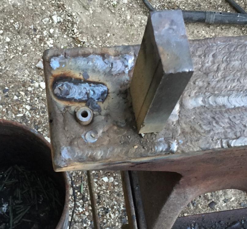

  11. A needle scaler does not have the energy required to deform the weld to relieve the stresses induced during cooling. Think of it this way, would you use a needle scaler in place of a hammer when forging a piece of steel? As the weld puddle solidifies and cools it contracts, peening the weld, deforms the weld back into the base metal and relieves the tension stresses created by the cooling of the puddle/weld. If you have good access to the weld, you can use the ball end of a ball-peen hammer, if not I use the taper punch with the end ground half round.
  12. Grind out a good vee, generally a 70° vee is normal for welding to get good access to the root of the weld, if you grind from the opposite sides of the anvil this will give you the best access with minimal grinding and welding. Vee-ing out 4 sides is both not needed and just extra work. I don't know if I would trust much of the previous welding done to it. Also and this is important, you need to alternate welding one side then the other side on every pass this will keep any stresses equal and keep the weldment straight as you weld. I would suggest some preheat, 200-250°F. If you are stick (SMAW) welding start with E-6010 in your root passes. This will aid you in getting good penetration and cleaning out impurities. Peen the weld well after the first pass to reduce stresses. Every pass from here on should be peened well. In deep vees I use a tapered punch ground slightly round to do the peening. The remaining passes can be run with E-6013, E-7018 or E-7024. 6013 would be the easiest to run and the cheapest route. 7018 rod is a low hydrogen rod and must be kept dry or you could get hydrogen embrittlement. A proper rod oven will keep the rod at 250-300°F. (an old fridge with a light bulb is useless, xx18 high titania flux is hygroscopic) I tend to steer people away from 7018 for that reason. As mentioned 7024 is a fast fill, slow freeze rod and must be welded in the flat position and requires a 250 amp class or better machine so you can have the duty cycle you need also it is not a rod for the beginner as you can easily get inclusions in your weld. If you MIG (SMAW) get a good 70S-6 wire, like Lincoln's L-56, and run with 75/25 argon carbon dioxide mix gas. Again peen all your welds and alternate sides welding. Welding in the flat position will help, if your machine is capable you can run spray transfer or pulsed spray modes, which require different gas mixes, and can be machine dependent.

  14. A short note, as I am beat, hot and really stinky! All went well. Welded 2 layers on the face the copper block cold shunt worked outstandingly well. The brass shunt for the pritchel hole not as well, the welding part great the getting it out was a widdle difficult but I got it out. The copper block I used for the edges and then machined a wedge in it for the hardie hole. Worked better than I hoped. Attached are pictures, I have it covered to cool slowly overnight, wrapped well in welding blankets.

  16. Checked the hardness this morning. 60 Rc on the face 30 ish on the table and horn.
  17. I have done a lot of hard facing of there years, standard steel filler will not hold up. The correct hard facing filler makes a huge difference, I am a fan of the Stoody products and support you get from them.
  18. What rod or wire did you use to weld it up? Pre-heat?
