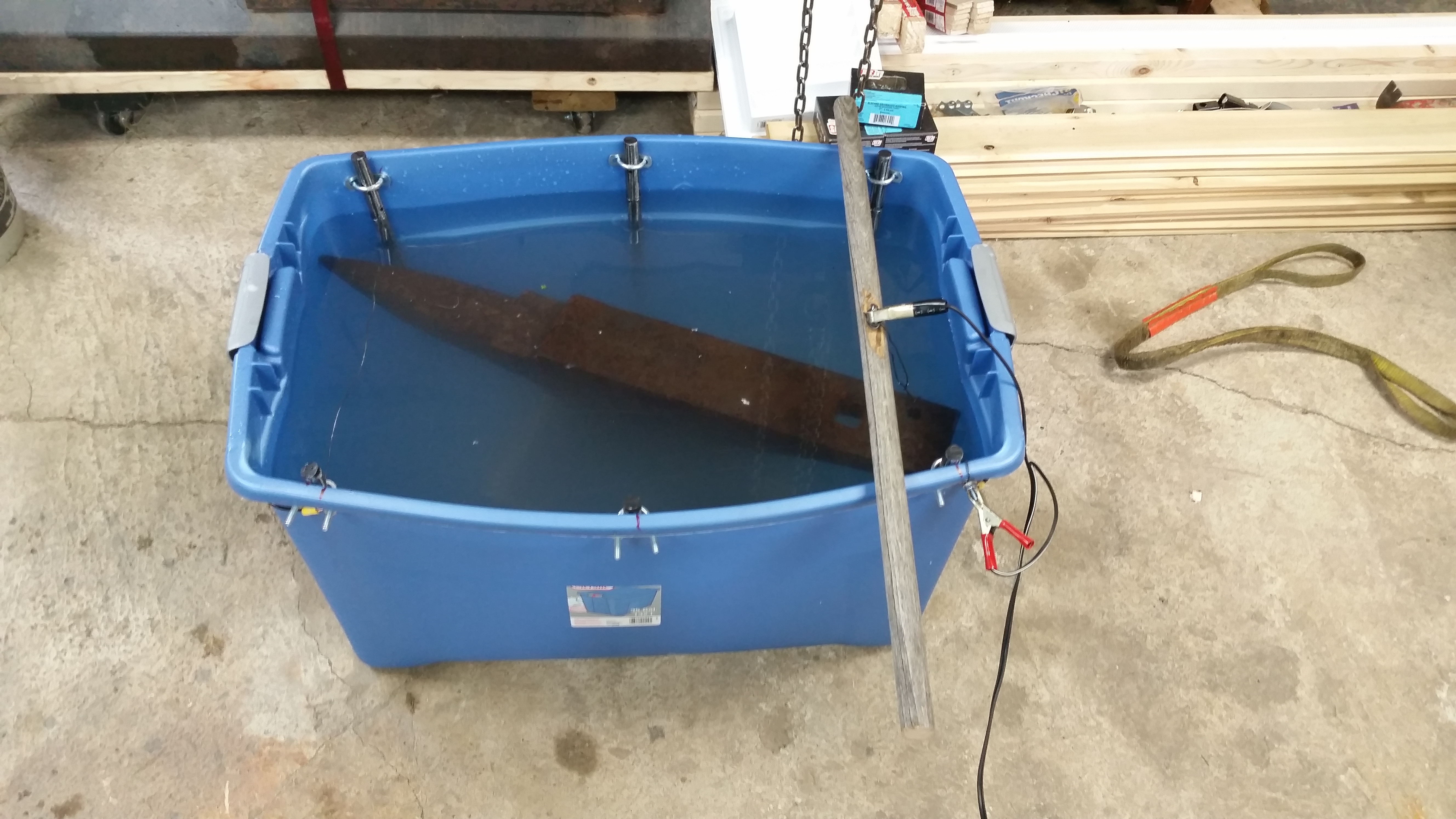

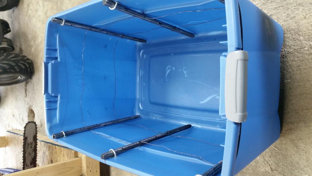

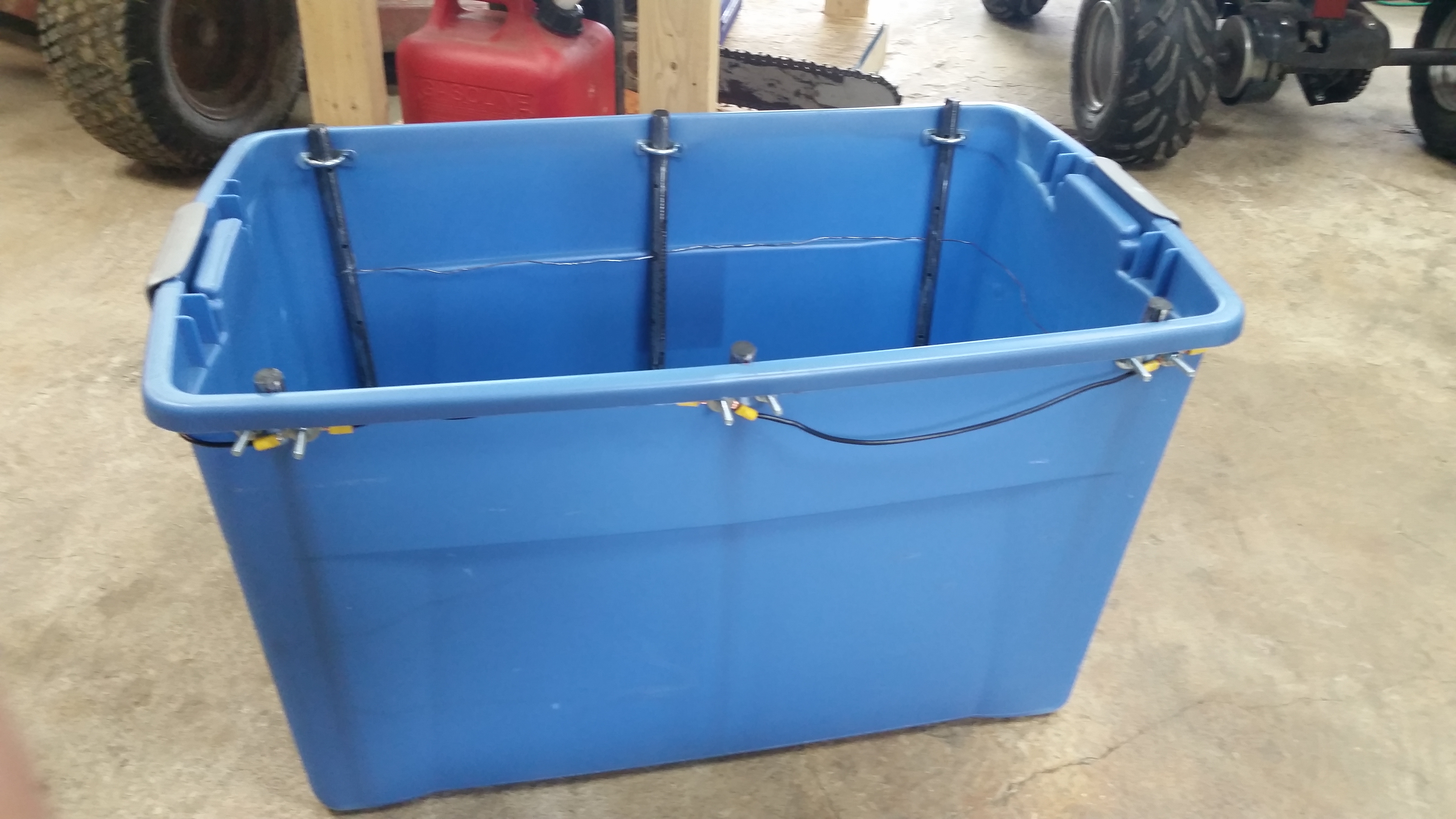

  1. I had to flip the side with the leg to get it all cause it was so long so that side took 2 dips. And now all the old paint,scale, and rust is gone. Rubbed it down with boiled linseed oil after each part was completed Thats my temporary tank just a regular storage bin and it has worked awesome so far

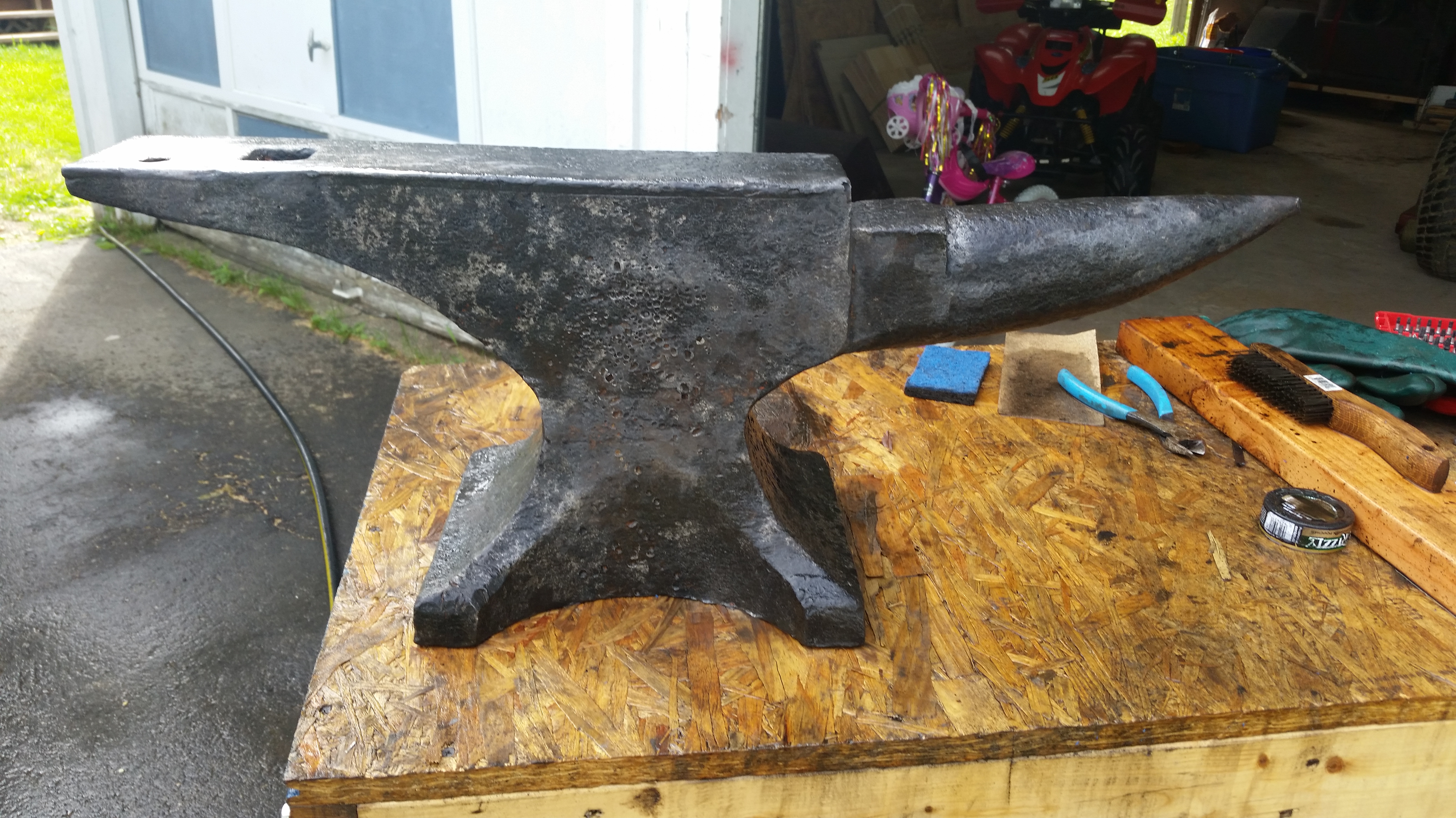

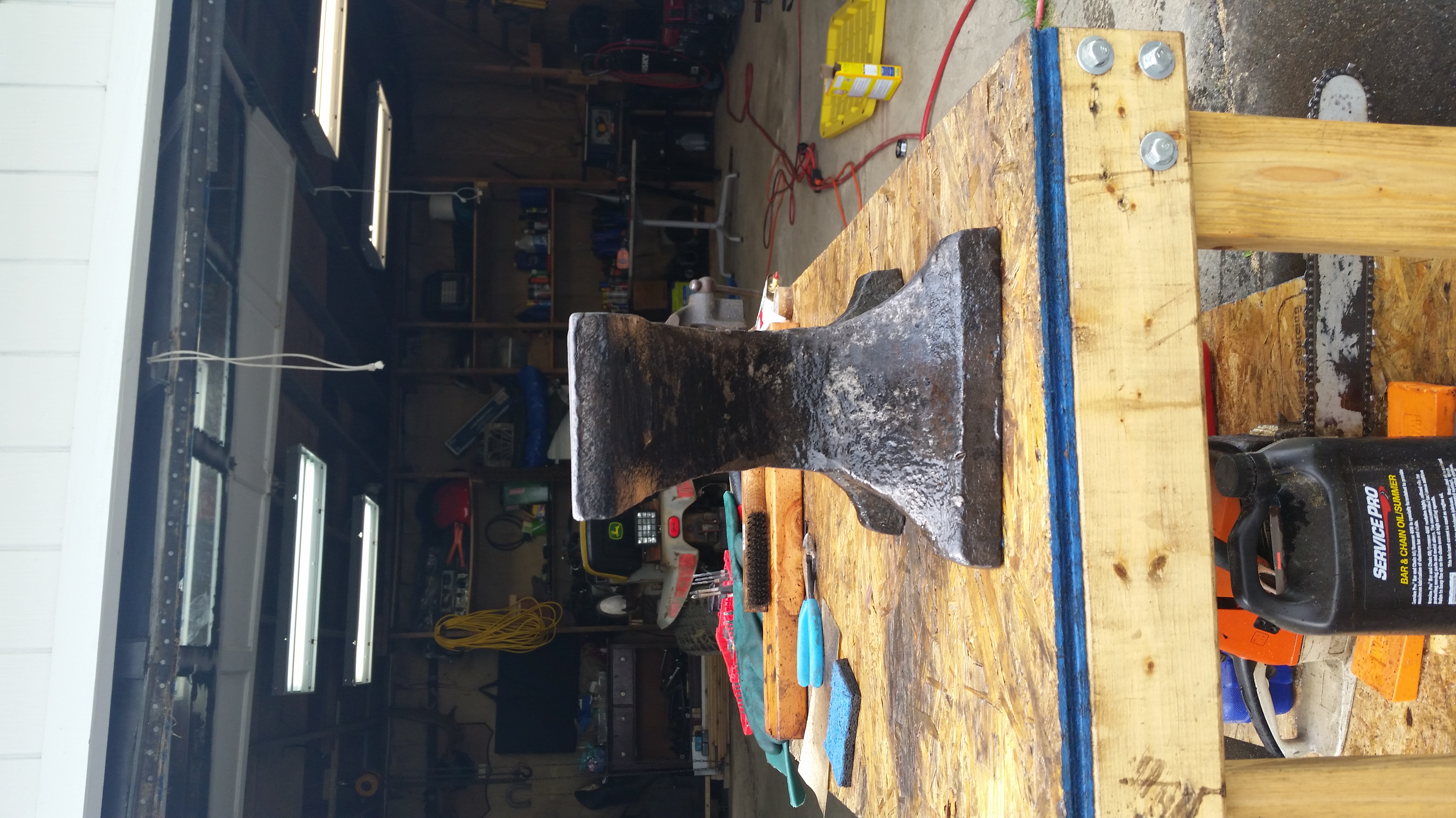

  2. Took it apart and dipped it in the etank to remove all the rust and it looks alot better than it did in the previous pictures.

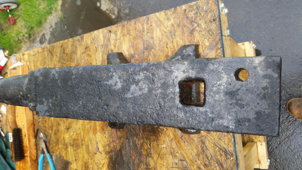

  17. Here it is after the second dip and boiled linseed oil rub down
  18. Thanks i just put it back in the tank to get the last of the rust off then i will coat it with the boiled linseed oil

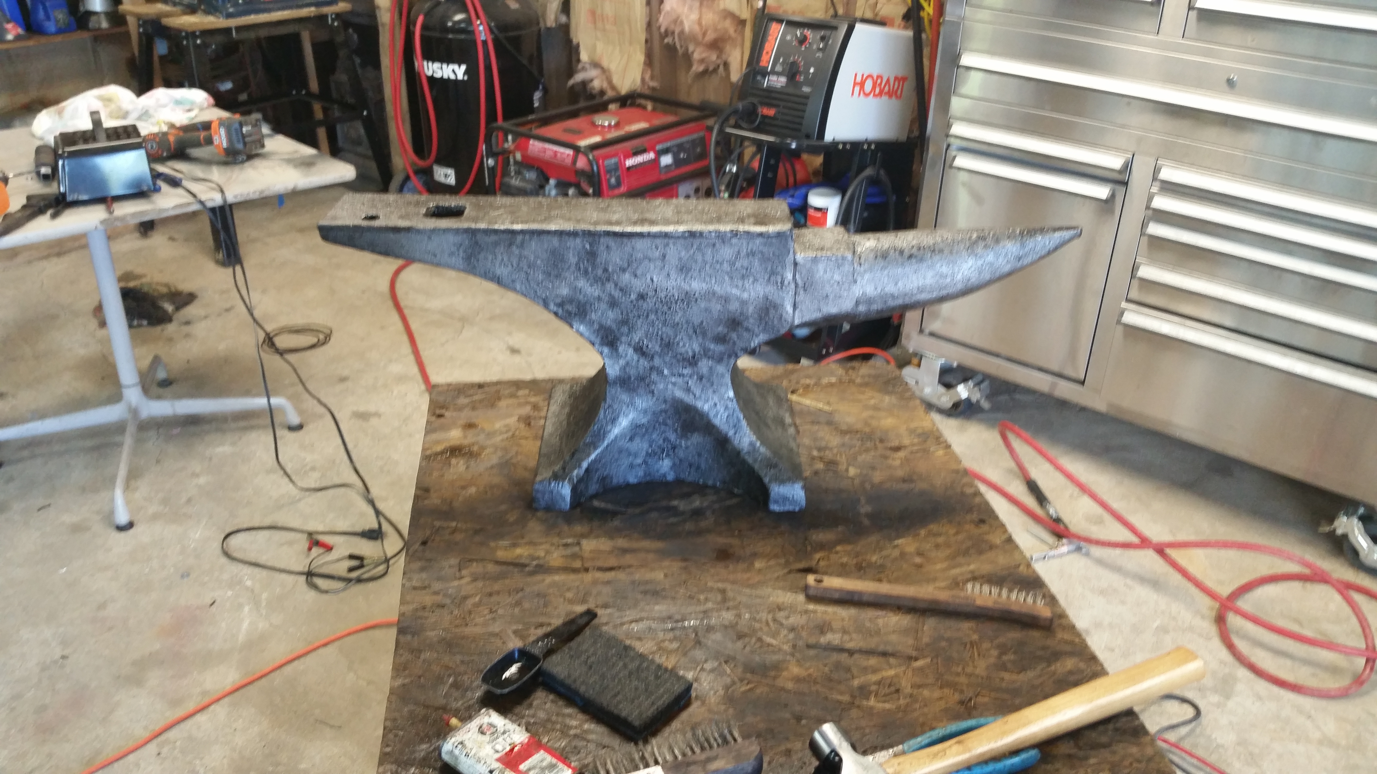

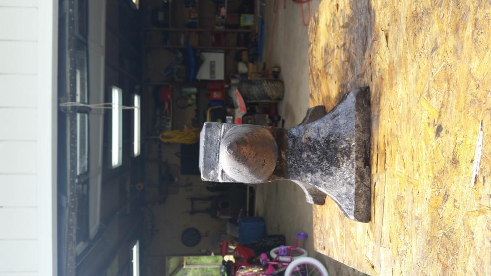

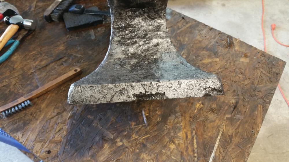

  20. After 12hrs in the tank all the scale and 98% of the rust is gone. I still havent found the trenton markings... I did notice it looks like it sags or curves more to one side. Is that the side it was worked on more?

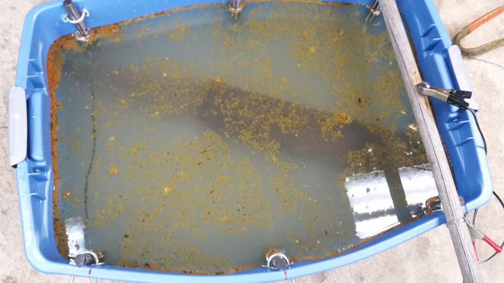

  21. An hour in the tank and its looking pretty good
  22. Well i did some research and decided to try electrolysis to remove the rust. I guess only time will tell if i did it right but it seems to be working quite well.
  23. I will get it cleaned up and post some more pictures. I didnt notice any markings on or near the horn location but maybe after i clean it up something will show... the guy did say he found it burried in his yard so maybe it rusted off??
  24. I just went and bought it.. whats the best way to clean it up? Wire wheel for a grinder?
