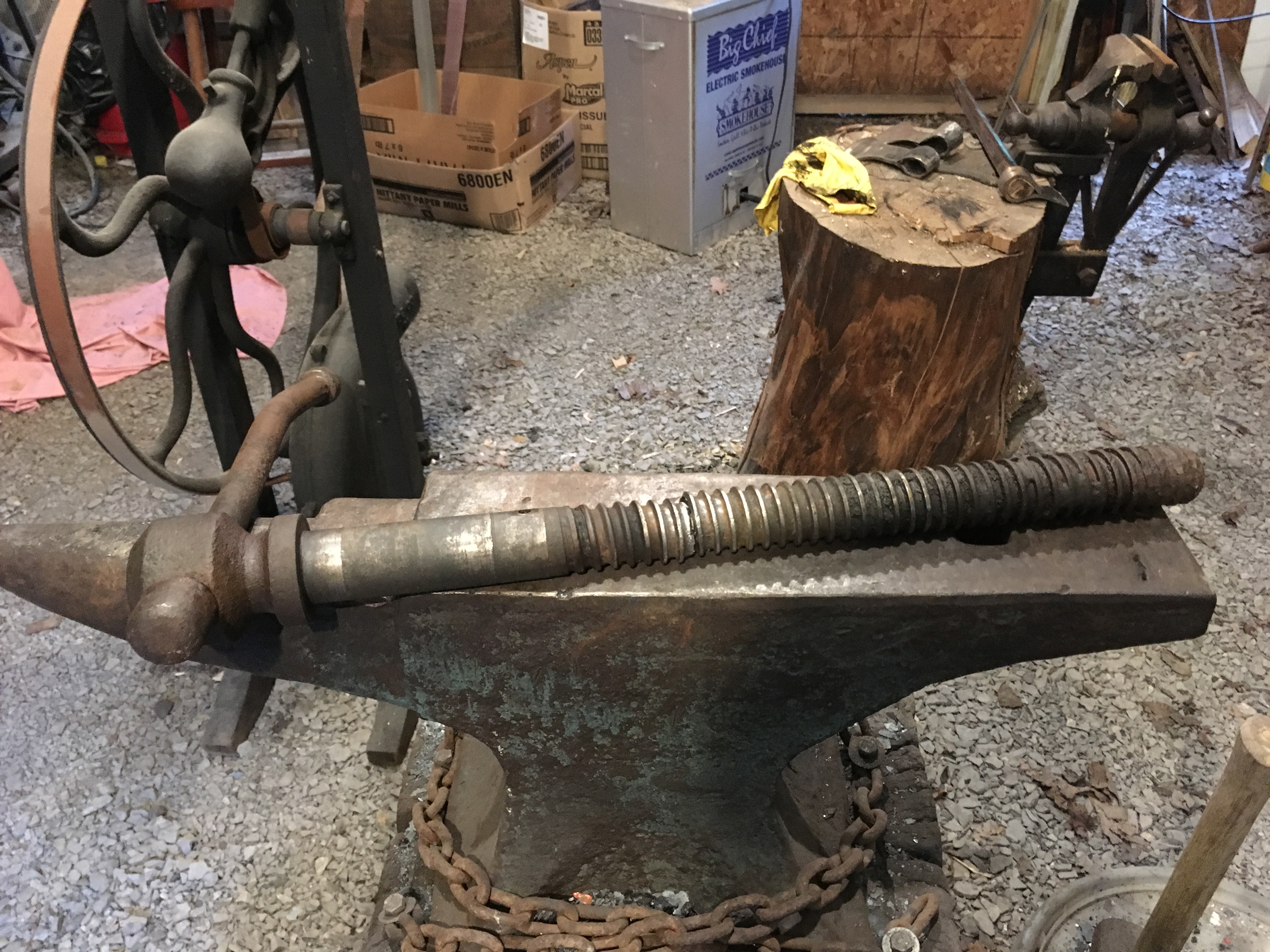

  1. Hi again guys and thank for all the advice.I just got done welding the screw and after grinding it looks pretty good.I have a bit more work to do with the file and hopefully tonight I'll get a chance to see if it'll screw in. I hope there is some slop in the screw box on these since I'm sure it will be off some.When I thought it was cast it kind of scared me a little. Not to much of a stick welder but OK with a mig. Thanks again Mike
  2. Ok I see what u mean now looks almost like it’s been peened. And flattened out. Well I kind of felt bad I had thought I broke it getting it apart. I gave it a few whacks with the hammer. If I can get it welded. I don’t mind spending some time with a file or maybe even the dremel tool trying to get the threads cleaned up and usable. The vise is dated 1913 it will be nice to get it back into service. I find gathering up the old tools a nice addition to the hobby. And thanks again. the knowledge base on this board is very much appreciated. Mike
  3. The shiny parts I wire brushed to clean things up a bit. The break fits pretty close together. I doubt I ever find another one of these vices. At least not one I would pay what I’ve seen them selling for. Getting one machined would another option like you said. Hopefully i can get to a welding shop tomorrow and see what they say. When I got it I wasn’t even sure I’d ever get it loosened up. Thanks Mike
  4. I had thought I read somewhere about them being cast. Glad it’s regular steel should be a easier fix I hope. Thanks mike
  5. Hi everyone,after a few months and a few cans of PB blaster then Kroil penetrating oil i finally got the screws moving in the Fisher double screw vise. Unfortunately the top screw was broken in half.what would be the best way to repair this. From what I've been able to find out on the web my options are brazing it( I've been practicing but not too good yet) or weld with nickel or cast rods but I'm not good with a stick welder.if welding would be better i may have to go to a pro and have them do it.never thought I'd get it loosens up.thanks Mike
