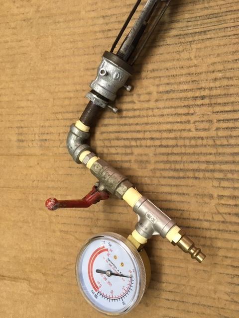

  16. Mikey, Thank you very much for your time and help. I am glad did not disappointed you. Actually I did not want a green flame, but I thought the burner was going to react in a different way with the choke movements. The flame was taken with the choke about mid position and it has a lot of different tones of blue until opened completely. Now comes the forge ....What do I want the forge for?....not having any basically I want to start learning, making some tools like tongs and eventually forge some small knifes. Trying to make a forge with your standards will be difficult not having all the refractories you have on hand, so I will have to use what is available and just try to make a decent one for the purpose. I have been searching locally and found a few vendors of refractory materials that probably could be used but let see if the sell them in small quantities. Before I start contacting them could you please check the following link to see what could be used: http://www.jjmedina.com.ec/ Please check in "Productos: materiales refractarios and fibra ceramica" They have each product information in pdf. Thank you in advance, Mario
  17. Any tip for taking flame pictures?
  18. Back to do some work. Made a new gas pipe. I like the idea of a threaded tip better than brazed as you can disassemble it if you need. Inserted a steel piece a shaped more aerodynamical. This time it is a long mig .030 tip and the insert of cooper tube is all the way through. Got rid of the pipe reducer lip and the three adjusting screws. Here some pictures. The flame picture does not seem to good. The burner worked ok but to get a green flame you have to close the choke almost al the way. Will try to get better pictures tomorrow.
  19. Mikey, Thank you for your followup. I got the long .030 mig tip but it has a different thread, so I have to make a new gas pipe. Past week was busy, and the weekend was fishing time so I hope will continue as soon as I get some shop time. Will keep you informed.
  20. Frosty and Mikey, thank you very much for your replies. Learning is not easy and it is even more difficult if you work on trial and error. The reason for posting here at IFI was to get your experience on the matter and I do appreciate all your comments and advise. They are very welcome. I am not only learning about burner and forges, I am also learning English as I have to read your posts again and again to understand them with my limited knowledge of the language ....... as you see it is all about learning!!. As far as I understand T burners and Mikey jet burners do not behave the same so I guess the wiser will be to follow the nine diameter rule of thumb for now. I also thought on using torch files to bore out a few thousands of an inch, but the ones I have are so poor in quality that will not make it possible. They bend very easy. I will try to search locally for a .030" tip but probably if they do not sell the wire then they will not have the tip. Will see what I find. Just now I will follow Mikey advise to "slow down and take a deep breath" and will read the posts again to realize if I finally understood the meaning of "uncontaminated continuing, or perhaps ongoing, explosions? " Mario
  21. It is worst. Very frustrating. Now I can't keep it burning, and is continually burning back. Have been changing choke position, tip distance, nozzle overhand but It seems as it just does not like the .025 tip at all. Checked again, no leaks. Put 1/4" cooper tube as liner in the gas tube, that makes about 3/16" inside diameter. Maybe the mixing tube size is not correct. It is 7/8" inside diameter and 8 7/8" from front of air openings to forward cut off end. Chart in page 22 tells you 6 3/4" and your rule of thumb 8 x diameter. What should be the proper length?. Maybe what I need is a MIG tip between .035 and .025.
  22. Today got some free time and did some work. Got rid of reducer´s lip. New gas pipe. 1/4" cooper pipe inserted with a cone in the intake. All silver brazed. Put some teflon in the tip and tested for leaks. New MIG tip is 0.025. Tried a quick test but had trouble firing it. It backfired 4 times!! I stopped for the time and will try later or tomorrow. Any reason for backfiring?

  24. Mikey, Thank you for your reply. No problem with the burden I think can handle it. Before I proceed with the changes want to be sure I am getting your ideas clear. Numerals 1-2 very clear. 3.) 1/8" pipe is hard to find around here, reason why I used 1/4". I guess only have two alternatives: insert a 1/4" copper pipe sleeve inside to reduce the diameter and try to make a more streamline match or, making the advanced accelerator from page 49. Do you think it will work OK just inserting the sleeve? Regarding the MIG tip too large, it is a bit confusing. The chart in page 22 calls for a .023" or .030" tip but in the list of materials asks for .030" -.035" and in the notes just .030" but you always mention a 1 1/2 inch tip, and in this case it is a short tip. What size is you suggestion?. 4.) The area beyond the MIG tip is clear, it is just an illusion from the picture, what you see is the other side of the pipe. 5.) Flame retention nozzle is not tapered. It is a stepped version, inside diameter 1.260" One extra question, a couple of times when firing the burner and warming it up, the flame got out on the outside up to the tip and really scared me. It happened when I made some modifications with the nozzle overhand. Any special reason for the burner to do this? Mario Hi Mikey, yes I am. Sorry if sometimes I do not get quick answers. I am not retired yet and some weeks are very busy, just enough energy to go to bed.
