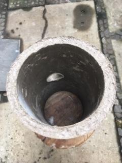

  1. Floor is a separate cast on the same kastolite. One crack is under the floor and the other on top. They have gone worst, very thin but almost all the way to the back, if this happens I will eventually have two separate pieces!!
  2. Thank you for the replies. Yes, it is insulated. 2 inches of ceramic blanket.
  3. It happened during the firing. Tried to be gently, 5 minutes, cool for a while, 10 minutes cool half hour, 15 minutes, cool.........cracks!! Too hot, too soon!!....I do not know. Guess now it needs fixing. Read in another post to butter it and use the same Kast o lite??. Any comments. No metrikote, no plastic, no ITC100 around here.

  6. Here the cast!!. Actually it came out better than I thought for a first timer The molds are still reusable. If I have to do it again would try to use some type of funnel to pour the cast, as it was not easy. First I calculated the volume and add about 10% more, then got the weight. As per the instructions measured 2.75 oz of water /pound and got ready to use 3oz just in case. After mixing with 2.75 and then 3.00 oz realized it was way to hard to pour it in that shape, so I add a little bit more and got it better. Guess I was l lucky the amount of mix was just enough to complete it. Next time will put 15% more instead of 10%. I used car wax on the outside and the burner tube as release agent but did not put nothing in the inside. To my surprise it came out very easy, being opened on one side. I am planing to cast a small flat portion at the bottom to use it as a kiln, but I am not sure if it is a good idea. Suggestions??
