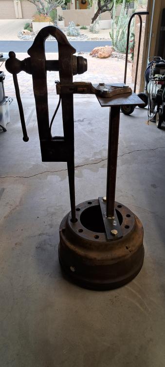

  4. royboy47 posted a topic in Vises
    This works good for now. I'm adding a larger table. Also fetching ideas to keep it from moving. Anchoring the floor is not an option. I move it to our summer home.
