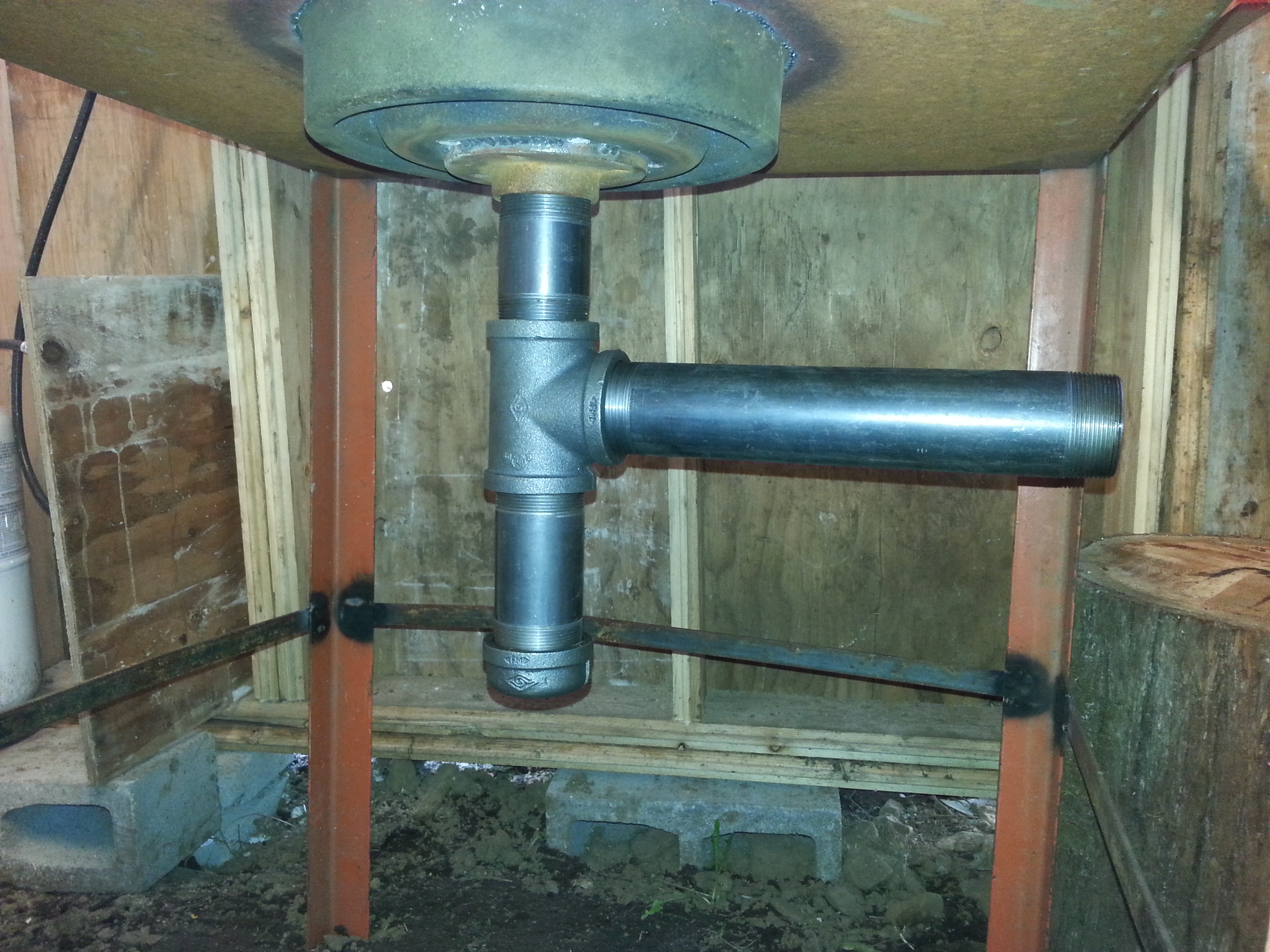

20140414 162242 Android Share https://www.iforgeiron.com/gallery/image/38189-20140414-162242-android/ Share on LinkedIn Share on X Share on Facebook {lang="reddit_text" Share via email Share on Pinterest More sharing options... Followers Im using this method for the air and ash.
LastRonin Members May 14, 201412 yr Author stats It looks good to me. I found out pretty quick though that the cap will rust on pretty tight and be hard to unscrew, not to mention the heat if you're needing to empty it during a forging session. I got around that by having mine extend down into a metal five gallon bucket full of water. The ash, clinkers and what-not fall into the water and cool off, no issues. Clinkers sink.
wildmanz Members May 14, 201412 yr Author stats I would make a counter weighted trap instead of the cap like LastRonin said would happen. And I used a 4in gate valve instead of a butterfly to adjust air flow.
Oregon Duck Members May 20, 201412 yr Author stats I got a lancaster #40 hooked up to it now. it is hard to take off the cap even after forging.
