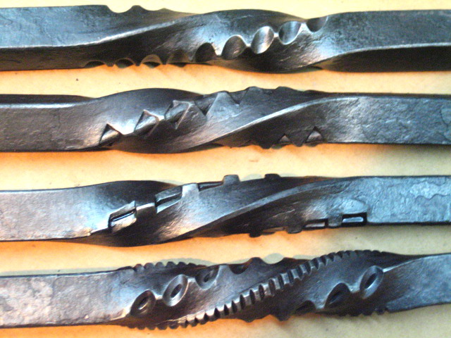

HOFI TWIST P Share https://www.iforgeiron.com/gallery/image/21362-hofi-twist-p/ Share on LinkedIn Share on X Share on Facebook {lang="reddit_text" Share via email Share on Pinterest More sharing options... Followers 3/4'' SQUER MARKED HEAVILY WITH A FLAT SHARP EDGES FULLER 7/16'' AND THEN INCISE IN THE MIDLE OF THE FULLER MARK WITH A CHISLE THE SAME WIDTH OF THE FULLER MARK THEN TWISTED180 D
James E. Kroll Members December 23, 20178 yr Author stats Is there any way I could get you yo email me where you got the tools to make these imprints?
Glenn Deceased December 24, 20178 yr Author stats Make the designs with chisels, fullers, punches, etc that you already have in the shop.
ThomasPowers Deceased January 3, 20188 yr Author stats I'm pretty sure the makers of those twists could have easily and cheaply made the tooling to make the indentations. Just a piece of H-13 square stock could make the triangles and round stock for the semi circles. It's the visualization that creates the designs from simple tooling and I'm afraid that's not for sale. May I suggest you take some modelling clay and some simple forms and see what designs you can work out before you get to the hot metal.
