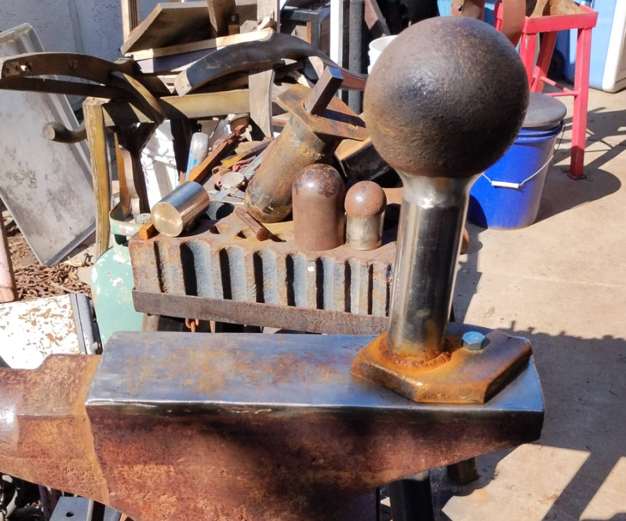

I just ran across a Facebook post showing another interesting method, where the smith has run a bolt through the pritchel hole to hold the base of a ball stake securely to the anvil face.

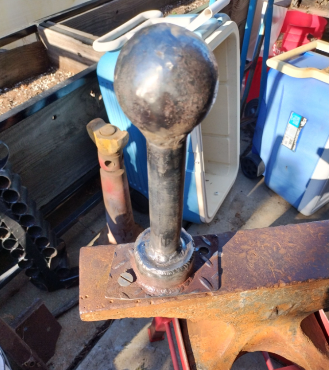

Here's a photo of another version from the same maker:

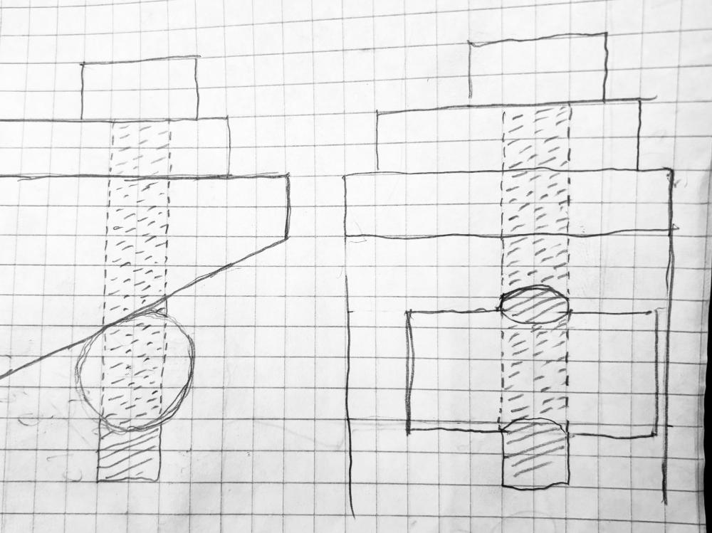

Presumably they're using some kind of tapered washer on the underside, to keep the bottom nut from pulling at an angle, although it occurs to me as I write this that a large barrel nut would also work:
This would have the disadvantage of making it harder to switch out tooling quickly, but for setups that are going to be in use for a long time, it might be a viable alternative.
Hey all. I put a bolt the same size as the pritchel hole so there's no need of a wedge shaped washer. The larger is 7/16" and the smaller is 3/8". I do nut the bolt and tighten down. Only takes a minute. But there is no movement. I'm in the process of making a few for my 400lb anvil...it requires a 3/4" bolt. If you do want to use a washer, beam washers are close enough. On the stainless plate I made for the other anvil I did use a beam washer. That was in the early 80s. I've evolved since then.
