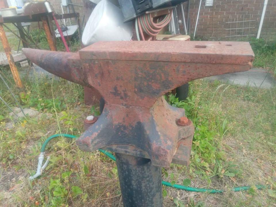

Identify this 500 lb anvil please
I'm trying to get in contact with the seller.  I don't even know how I'd get a 500lb anvil back to my smithy, but it's a local listing. He may just be guessing at the weight.  Will find out.

Didnt someone post about this anvil a month back?
Probably not 500lb.

The lugs and that squared off faceplate scream fisher-norris, but there's no eagle, so...that. As I recall, a few of the later models were marked with big oval stickers. If it has decent rebound and approximates the weight they say, then great, and it doesn't really matter, but I'd beware of a pig in a poke.
