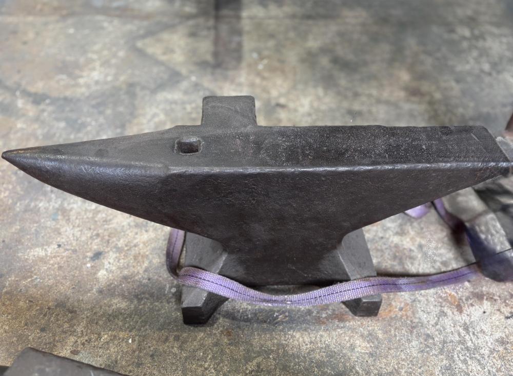

1887 Holthaus (?) with unique base
A bit of show and tell but I’m also wondering if anyone has seen anything with an integrated upsetting base like this elsewhere? I’ve seen a couple of examples with both the sloping side and shelf ("brust und voramboss) but not with a base looking anything like this.
Although the markings are quite obscured I make out, amongst the three partially visible markings above and beside the date stamp, the pythagorus theorem squares and triangle that make up the Holthaus stamp. Unless anyone has any other suggestions?
Weight is 195kg/430lb.
The Holthaus stamp from the “Anvilks Museum San Martino” web site
The closest likeness that I’ve found elsewhere is No. 31 here but I can’t read the description:
Hello!
This pattern is called "Schweizer mit 1 Horn, Voramboss und geschlossenem Stauchfuß", which translates to "Swiss with one horn, side shelf and closed upsetting foot", the "closed" not in a way of locked, but meaning something like "cohesive/one piece".
The kind of breast often found on swiss pattern anvils is called "half breast", because, well, it's half the size of a full breasted model.
You are absolutely correct with the Holthaus stamp.
Cheers!
Julian

Thankyou Julian, that is terrific information and very much appreciated!! Just the detail that I was looking for.

It’s certainly very unique here in Australia and from what I can find online it seems unique elsewhere as well, but would it really be considered so in Europe?
It is not as common, but not unique either. I've come across several examples over the years, but they are most definitely rarer than other patterns.

Well I am very pleased to finally have my rather handsome Holthaus "Schweizer mit 1 Horn, Voramboss und geschlossenem Stauchfuß” back home and given a throne for display. It’s definitely not positioned for working on (at the moment anyway) but this one is here for its company rather than its functionality :) - as unique and as splendid as this anvil is, the somewhat pitted face doesn’t really lend it to the work that I do (and I’m not about to try and dress it down).
