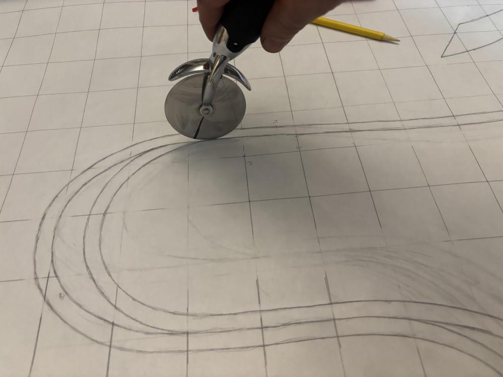

And here’s a new one, a variation of the classic wheelwright’s traveller: If you have a pizza cutter with a 2-3/4” wheel, its circumference is close enough* to 8-5/8” as to not make a difference in shop conditions.
Just make a mark on the edge of the wheel so that you can count the revolutions.
* 8.639” vs 8.625”, less than 1/64” difference.
