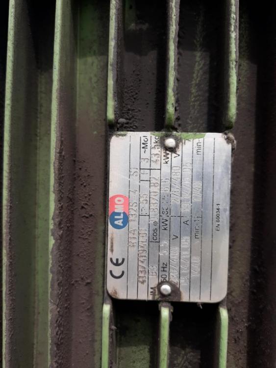

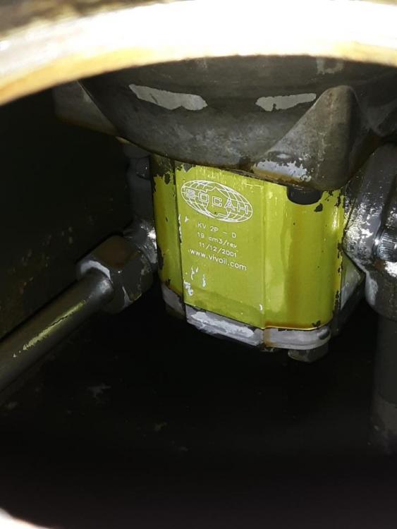

No idea of the stroke or speed. There's some writing in it, but I can stumble along in russian. Definitely not Italian.  I can post a picture is anyone speaks Italian.

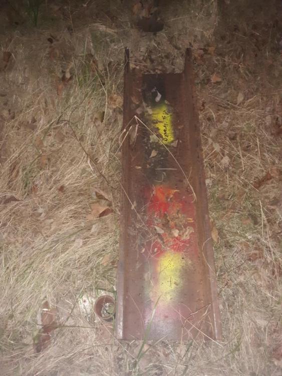

,  but turned 90° with a pass through in the main beam probably 6" x 6" for those longer jobs. The main beam is a probably excessively stout. 12" x 14" x 12" & 7/8" thick x 5' long. Found it years ago at a job for just a few bucks. The cylinder and anvil are to be mounted in the channel of the beam with the legs acting as guides.

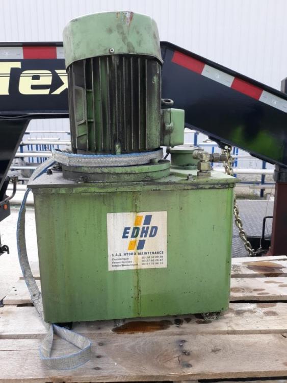

The tank / pump / motor will be mounted to one side with the controls to the other side with some type of protective cover over the flammable bits. Red hot metal & pressurized oil could be fun.  Just not right in front of my face.
In case it's not apparent,  I'm winging most of this & using as much scrapyard finds & reclaimed materials as I can dig up (not the hoses though. Those'll be new). This is mostly a fun project for me & if I end up with a press to do canister & billets with, super. I'm at a early point with this & still have to answer most of my own questions.
