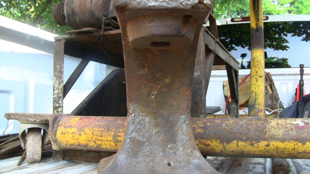

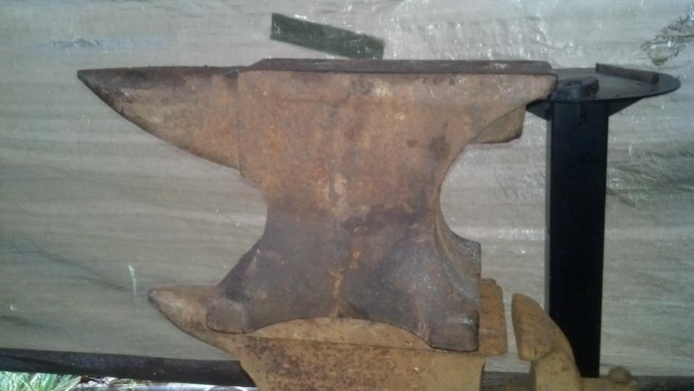

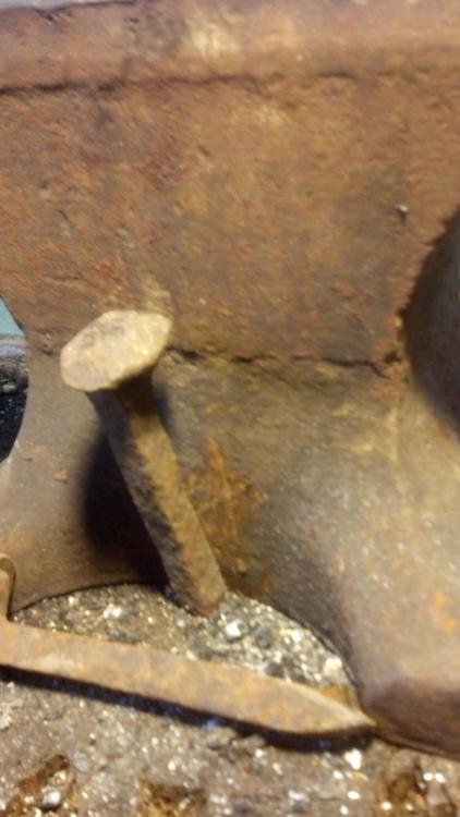

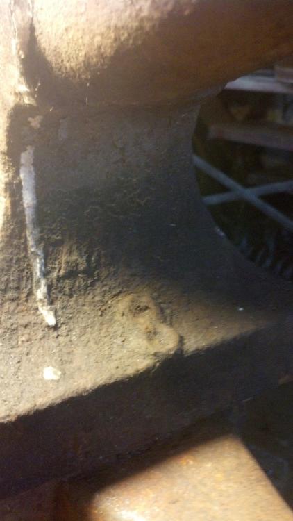

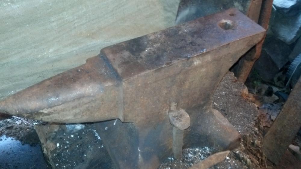

IMG_20151224_085710_488.thumb.jpg.956bd3I was given this anvil and cannot find info online, it weighs about 70#, its only marking is a 8 under horn, 3/4" hardy. Visible welds between feet/body, body/face. Does not have much ring but does have decent rebound, I almost broke my nose when I missed a hammer strike(got snuck up on, startled mid swing). Mostly just curious, thanks for any help.
I don't think that is a weld line, more likely a mold line from the casting pattern. With that protrusion at the hardy hole, it might be a Badger.
My second guess was cast marks. That's the second opinion I've got that its a badger. Thanks for the response and info. Happy Holidays.
My immediate thought was a Badger as well. Good anvils from what I'm told but I have never used one personally.
