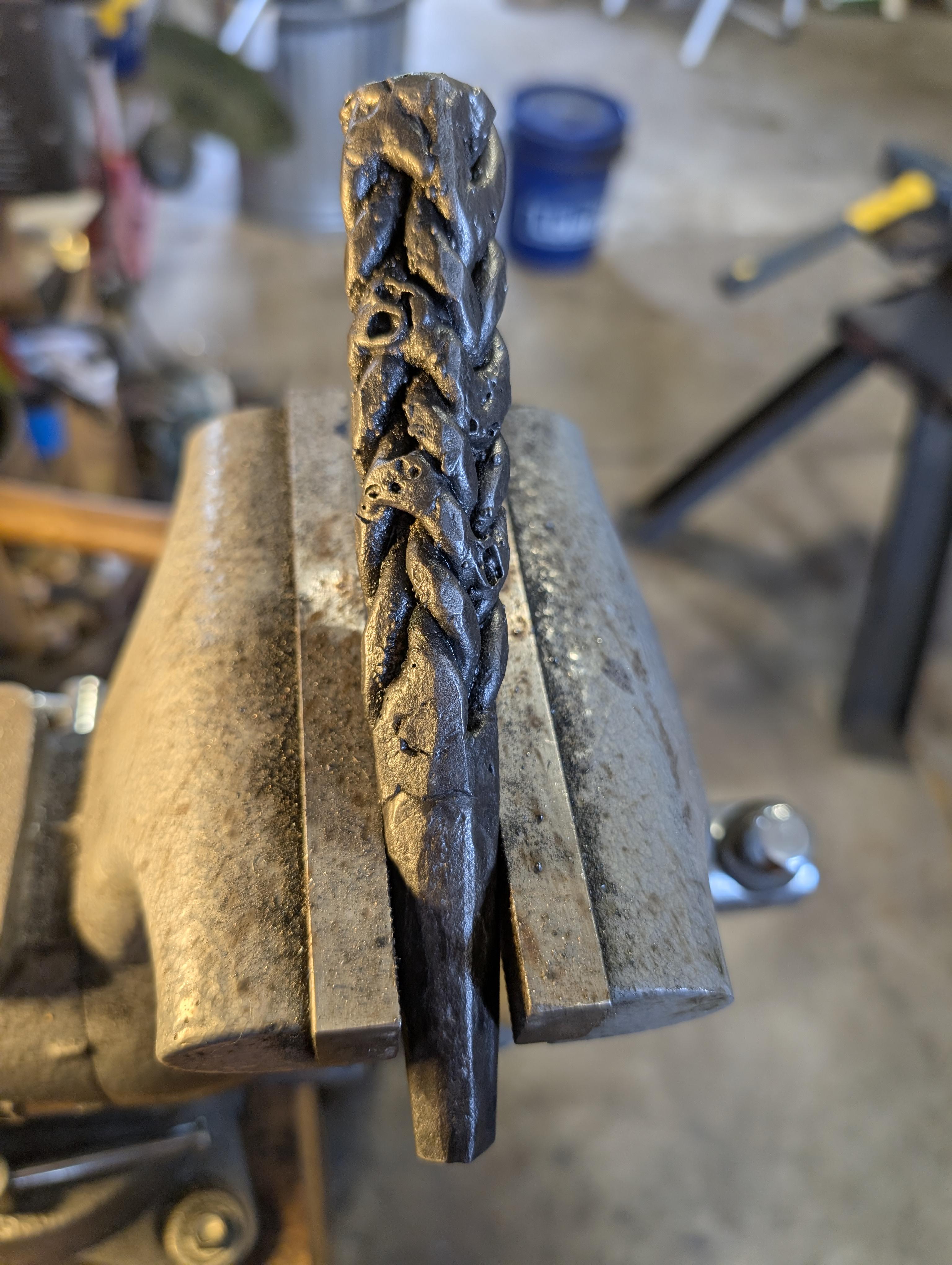

I think I got close with just some flux core mig wire, but Tig would be better. It is just a Chevron/wheat twist with 4 pairs instead of 2. I welded a bridge on the alternating twists. If you are careful, you could leave the bridges up like they did, I, however, was not.
