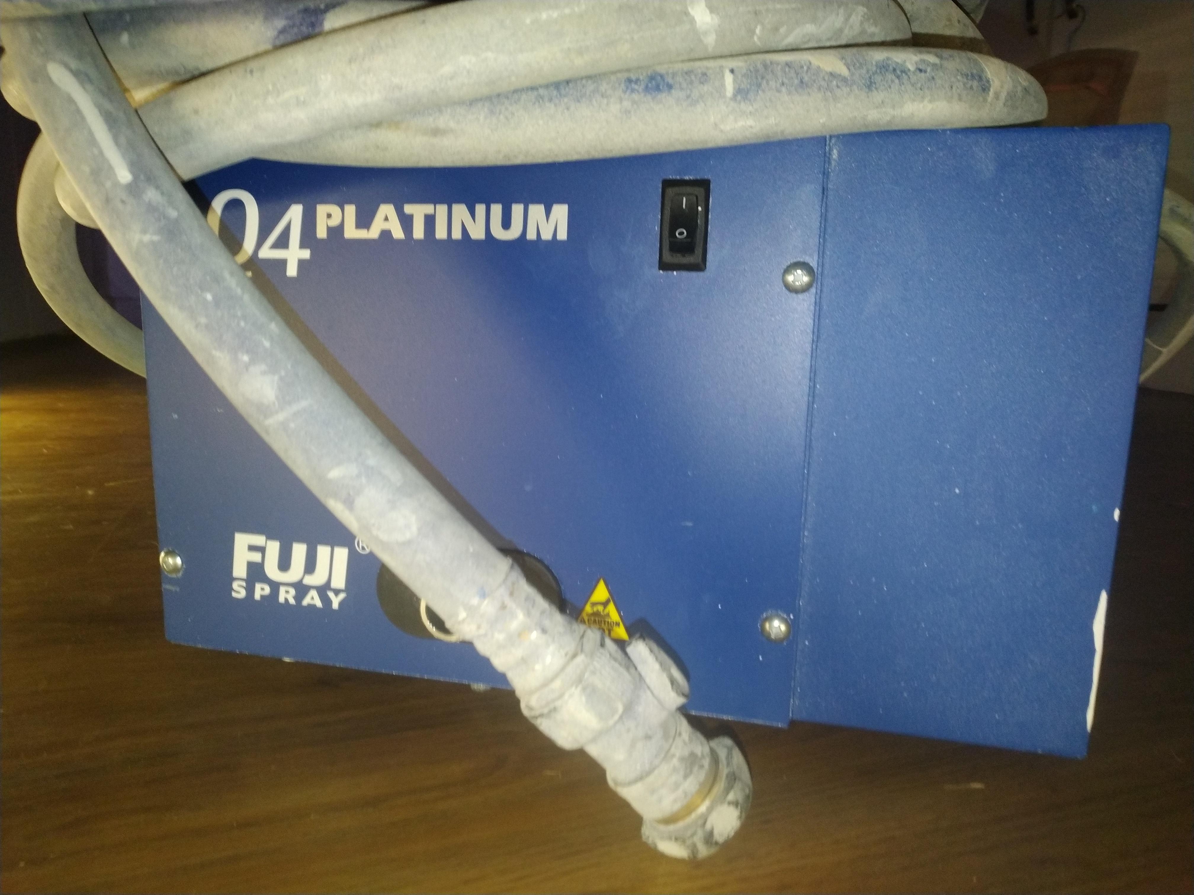

  1. Thanks for your reply. Not sure that's a problem with the Fuji Q4 Platinum turbine system?

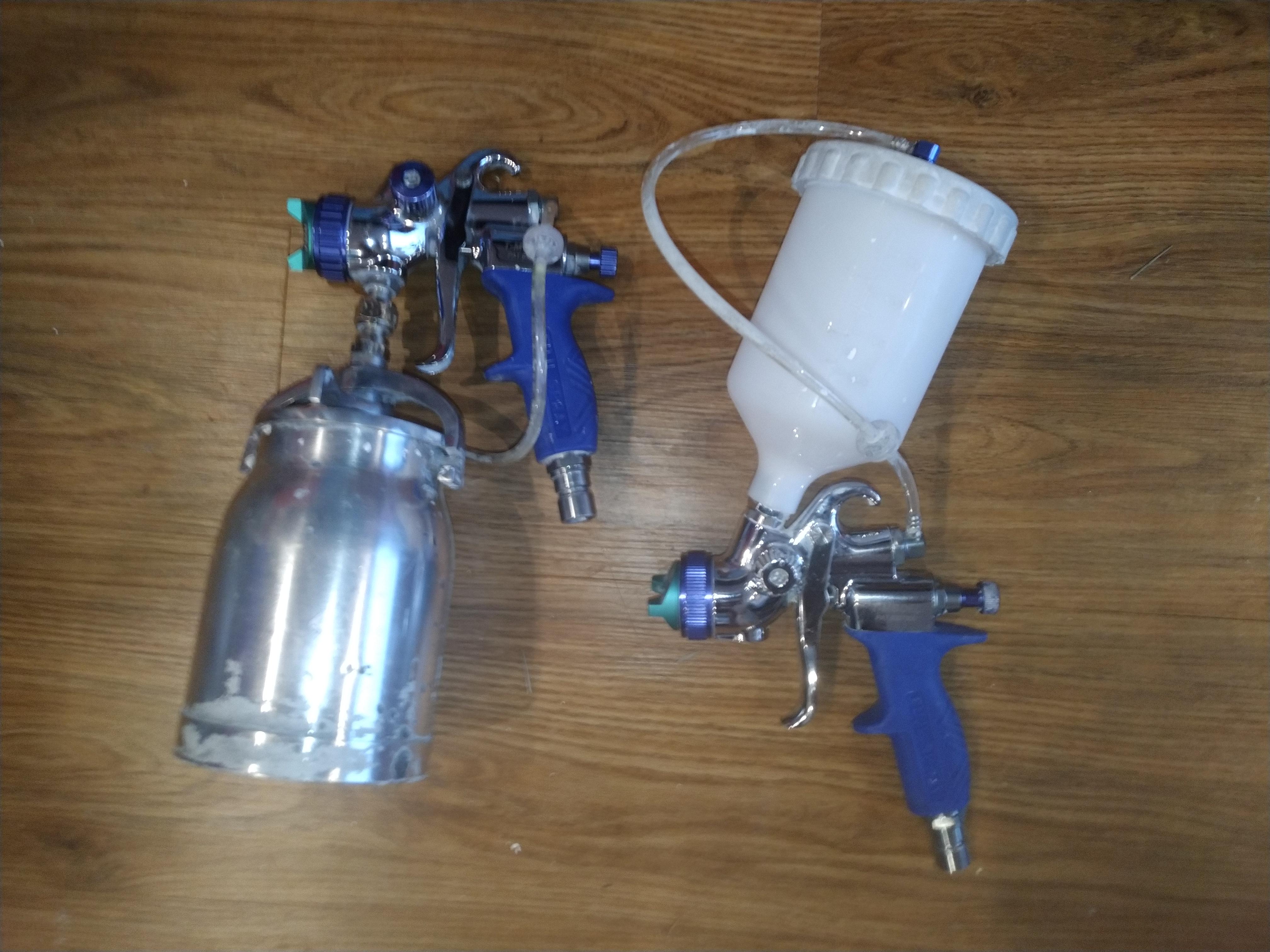

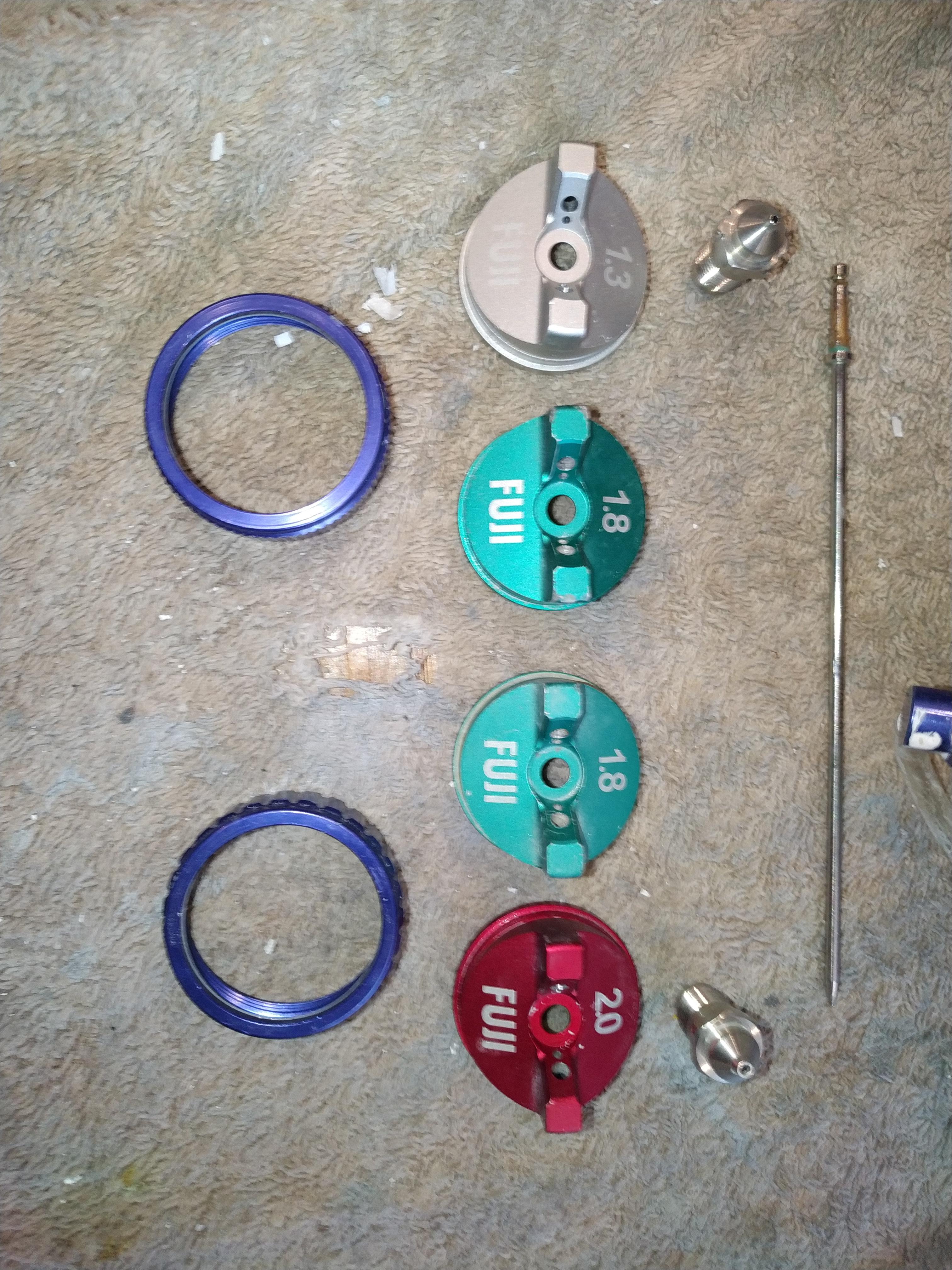

  2. Thanks for your reply. There is something similar in the UK using Dulux paints, would they be suitable for this project? Here's the kit I have for this.
