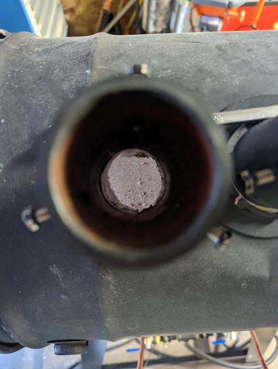

  1. Ill try all that tomorrow and see how it goes thanks again for the help. You guys are awesome. I should have to in the holder to adjust if not I'll pull the fire brick out for testing to see if that's the issue
  2. How would I go about seeing if it's picking up exhaust glasses? Should I seal off the burner holder to burner tube? I could try shortening the nozzle again didn't seem to help last time though. I don't have a co detector but when it was in the garage it was only ran short times. I now have it set up so it gets set right outside the garage when it's running Ahh ok. Mine is satanite but probably about the same thing
  3. How long does it usually take to burn of all the binder? I'm more than happy to just let it run for a while if that's what it needs. Since the last coating I've had probably 5 full heat cycles. I can also try getting some smaller mig tips. I have double checked the ones in it and there is no bur and orifice is nice and straight.
  4. Alright I just pulled a burner and plugged the hole. These new pictures are of 1 single burner running 1 pic is cold the other 2 are after heating up
  5. Ok I'm just turning in for the night. I'll give it a try in the morning and report back. Thanks for the help.
  6. Sorry won't use that didn't know it caused issues. It is 311 cubic inches. It still gets about 6" of dragons breath with a single burner. Would plugging the second burner with some kaowool make a difference over just leaving the one off?
  7. Just tried pulling them back farther and the only thing it changed was making the burner holder alot hotter but still had the dragons breath
  8. This is with the burner flares recessed 1" into the kaowhool PXL_20220817_022349389.mp4
  9. I've been having issues getting my frosty t burners tuned. I have a foot or more dragons breath coming out the front. Nozzles are centered, .035, I have tried long all the way down to super short, I am running stainless 1:12 flares. I slid them up the burner tube and got slightly better results, doesn't matter if I'm running 1 or 2 burners, roughly 6x11 chamber, if I remove all fire bricks I get dragons breath out the front and back, tried 5-15 psi, 2 in kaowool, satanite, plistix 900f.
