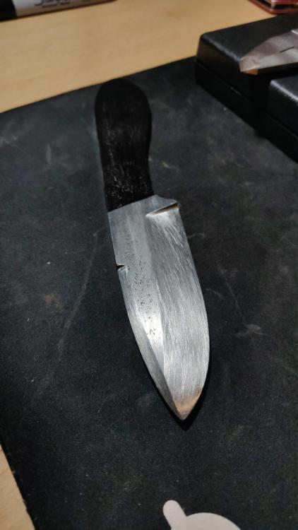

  4. bevels roughed in. i got good symmetry, too. sanding with 80 grit now.
  5. those metal uprights with all the holes in them are from computer racks, they used to hold a set of battery backup units that got junked. it's pretty easy to change angles by moving up, down, forward, and backward. the rows of holes are offset so that makes it even easier to get very fine changes in angle. A lucky coincidence, this is because I'm a borderline-needing-an-intervention hoarder
  6. the trashheap file jig works pretty well! it took me a little over an hour, on and off, to file this bevel. its a lot neater than my previous attempts with my 1x30 delta grinder.

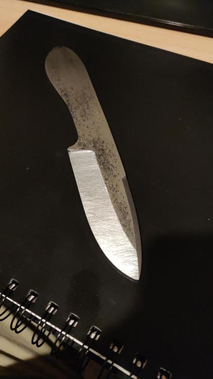

  7. wish me luck, fellas, me and my pallet wood filing jig are starting!

  9. Thanks for that, Bob. If you look at my very first pic, you can see that I have a very long swedge, almost the entire length of the blade. Will this thin the point out too much? The peak (if that's what it's called) of the swedge will be centered on the drop in the point. I see that usually knives are only made with a swedge about 1/3 of the blade, is there a reason for that, or is that just style?
  10. I just re-read my post, and I shouldn't try to do math after midnight. The steel thickness is 7/32, not 15/16. I'm not grinding inch-thick steel, lol.
