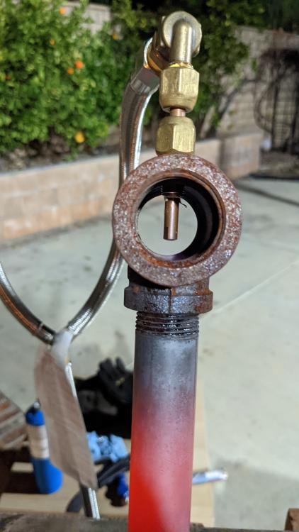

  1. Yeah that's a good idea I don't know if I can change the topic header or not. I started the tap in my drill press and went to do the rest by hand. I'll try the 0.035 when it starts working properly?
  2. Nsayegh started following Frosty

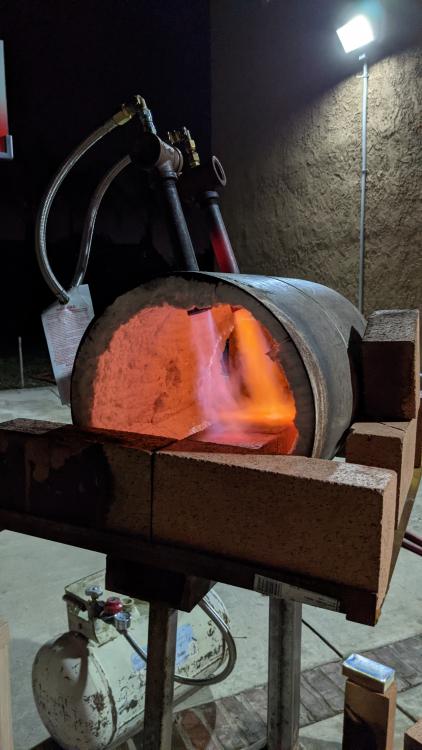

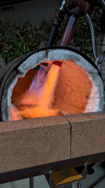

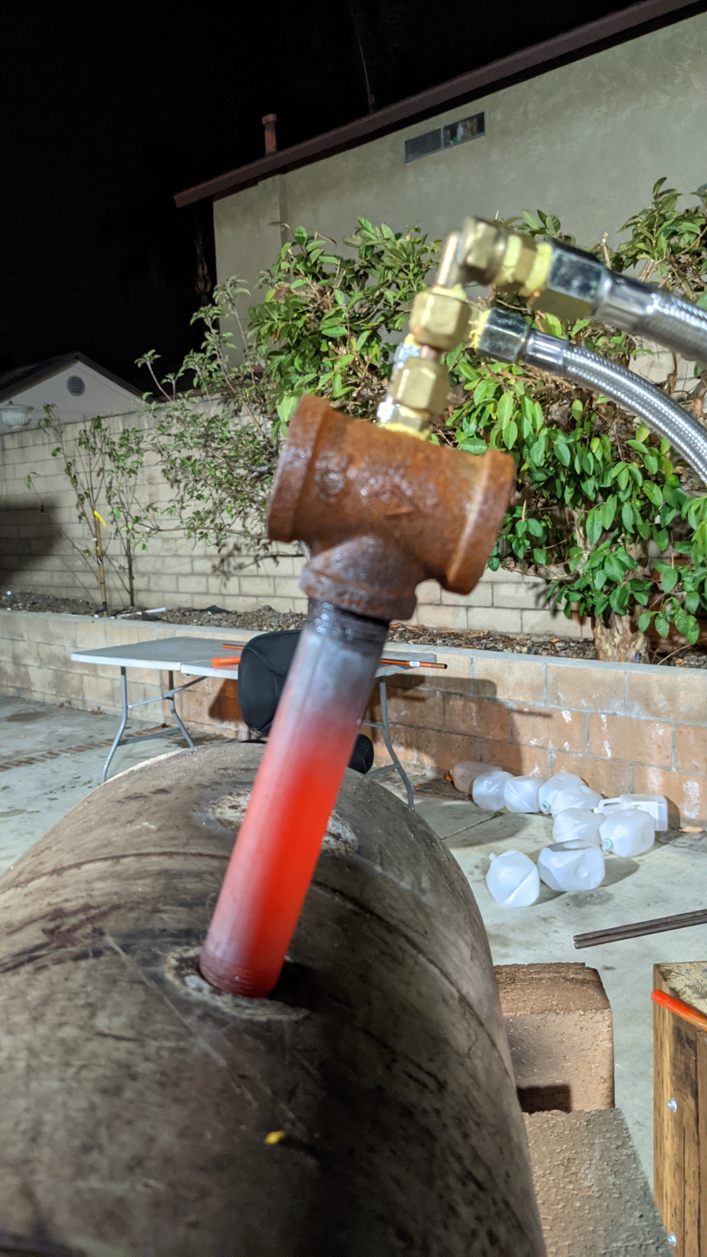

  3. Hi! Thank you Mr. Lucky!! I live in upland California, and I honestly didn't consider the idea of someone being able to help me in person. The mig tip is .025 the T is 1in &1in & 3/4in the ID of the mixing tube is just under 7/8in and the length is just over 6in. My propane hose is Y split/metal braided, I don't think there's any rubber in it. I think that's everything, but I didn't exactly understand what you were saying in the paragraph starting with "your fittings look okay" I think it's just hard to visualize but idk. Than you much for helping!! -Nick
